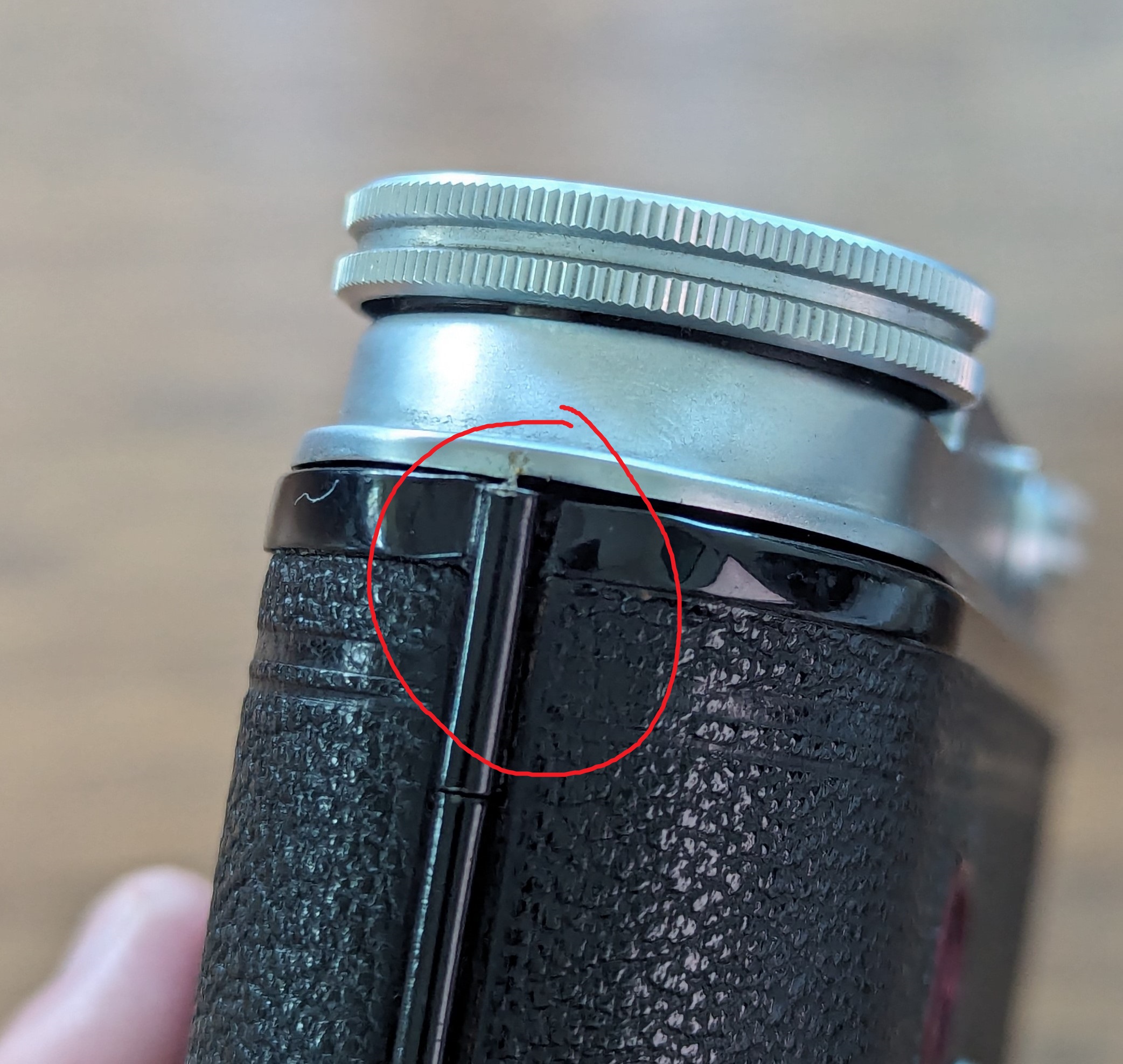

There is foam. But there is also a gap around the hinge.

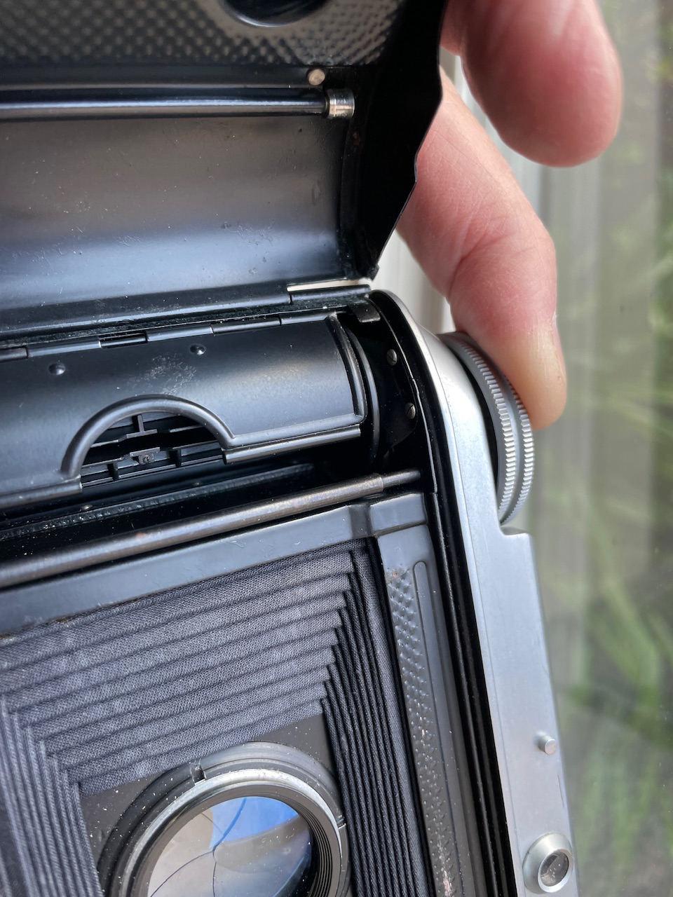

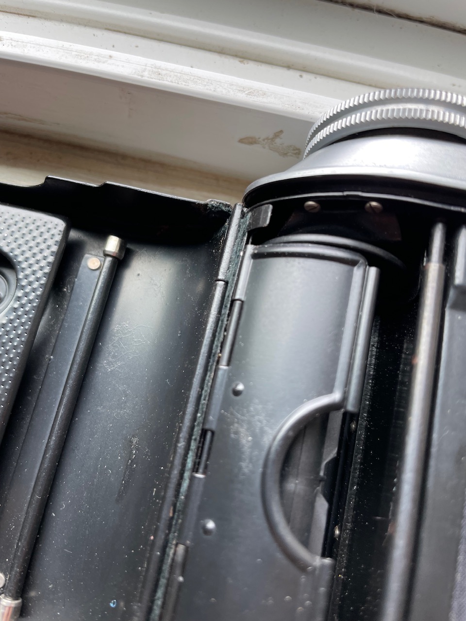

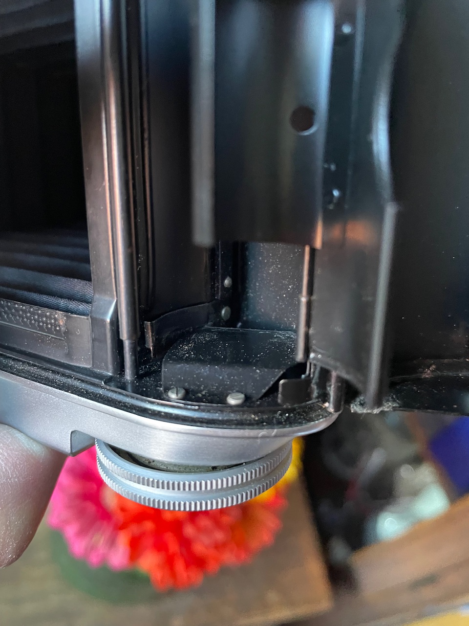

My best guess for the moment is this area. There are seals but they are awfully thin given how big this crack is. I bought some seals on amazon and will try to replace the existing ones, perhaps even add something on the outside just to be sure this is in fact the source of the leak. I'll report back in ~ 2 weeks.

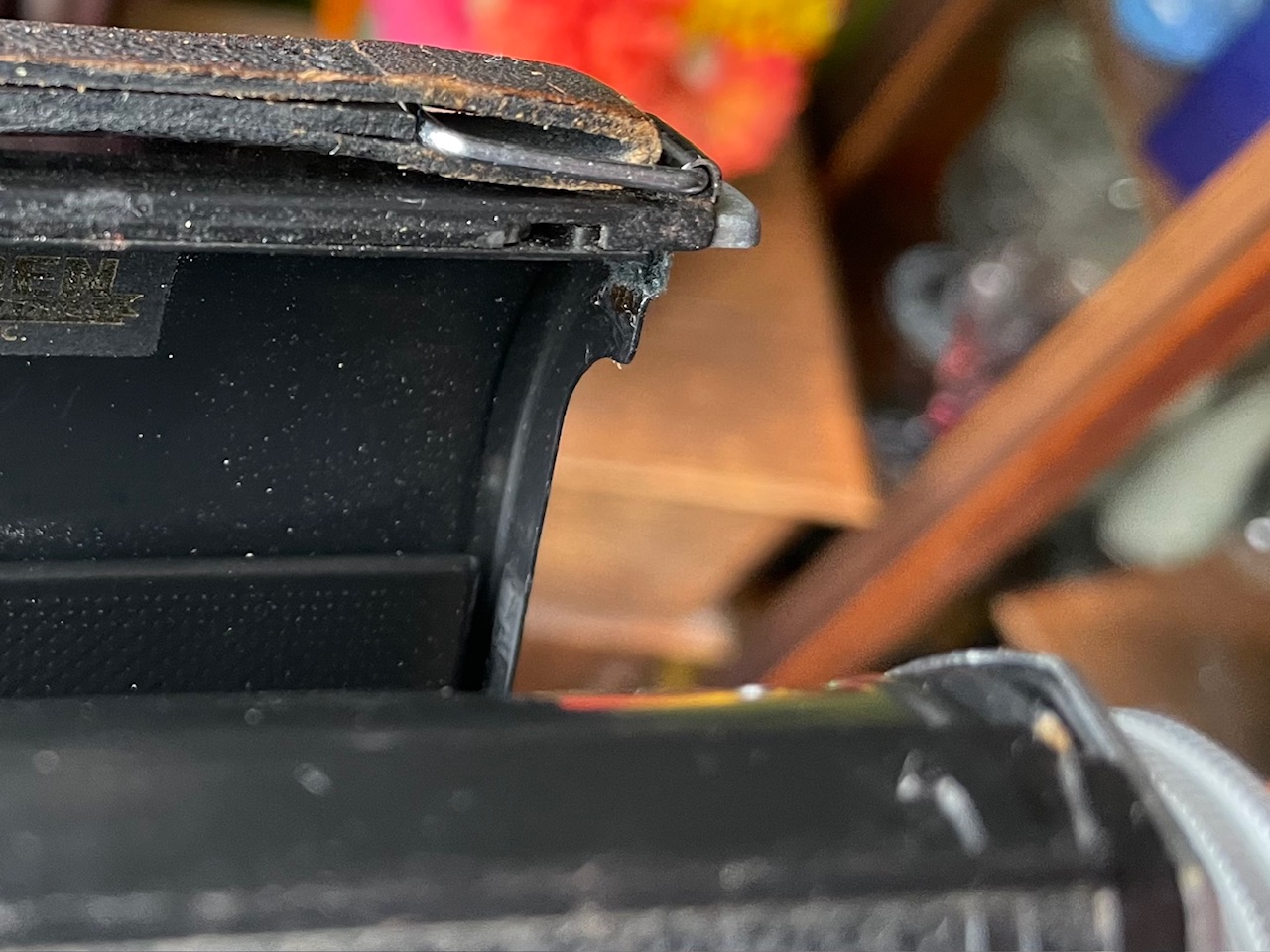

Ok feed side. Hinge gap. Here’s a closer look. That’s the only place where I think light can get in like that.

The foam seals have arrived (I ordered 1 mm, 2 mm, and 3 mm thick ones), and I installed the 3 mm ones. I'm leaving for a trip, so I'll just let the seals settle in (not sure if that is required or even a thing) until I am back. A roll of Delta 400 is already out of the freezer, so I'll be ready to fill it up once I am back. I should have it develop on Saturday, and I have a good feeling about this!
The roll is drying so no pictures of the negatives, but there are still light leaks at the same spots. Since this is the first time I am dealing with foam seals there is a good chance I screwed it up, so I'll reach out to Blue Moon Camera to see if this is something they can handle.
It's coming from behind the left roller, not from the back seal. You can see the distinct shadow of the roller. I bet it is a crack in the body or the roller mounting hole and the light is coming from the bellows area. Next time you shoot a roll, do one frame without opening the front door (hmmm... probably need to open the camera in a dark bag to be able to wind?).
I see what you are saying, and I did find a crack in the body (near the roller), which I thought would be easier to fix with foam rather than machining.
I cannot trigger the shutter when the camera is closed, so leaving a frame unexposed is the best I can do. But Frame 7 in the first post shows no issues, so I don't think it's from the bellows area.
So the new suspect area is front hinge near rangefinder, or the back corner where the strut goes. Did you find a crack there? This would show with a flashlight.

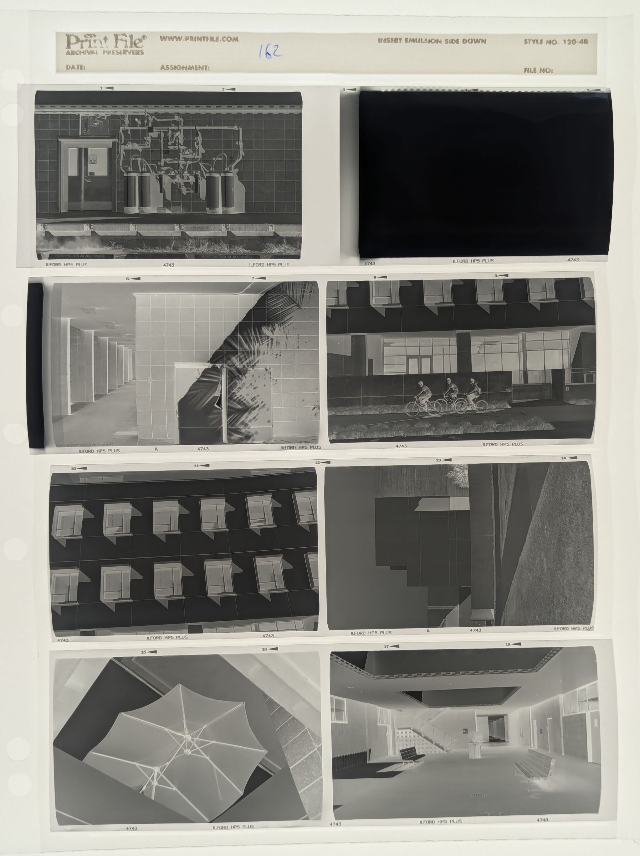

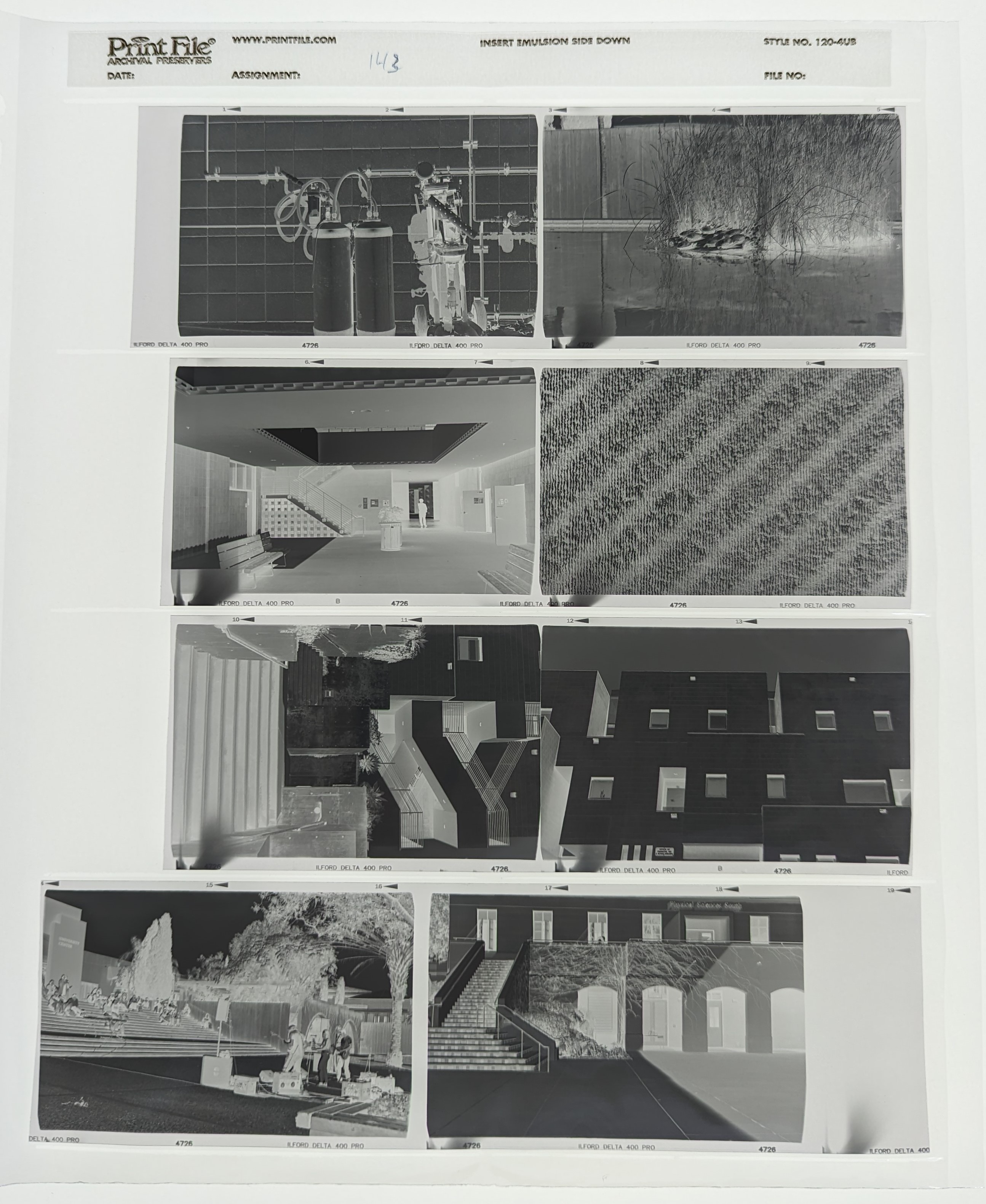

I tried something, it didn't work, Advance Camera Repair in Portland agreed to take a look at it and I have my fingers crossed.
The camera is back and I happy to report that the problem appears to be mostly gone. A very faint remnant remains, see bottom left of Frame 7, but I don't see it in all frames. Please excuse Frame 2 - I am not a smart man.

That looks more like the shutter was left open and it spread around from the lens. Light’s supposed to get in there - just not that much. Yours might be about the best Bessa II out there.
