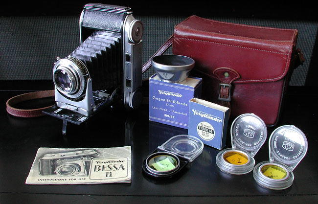

When I had a Bessa II, I found a couple of filters made by the Polish optical firm, Polskie Zakłady Optyczne (PZO) that fit properly and were of reasonable quality for the era in which they were produced. I don't know what camera they were intended for, but it may be worth looking for some East European cameras of the era with the same filter size that could come with a set of filters.
