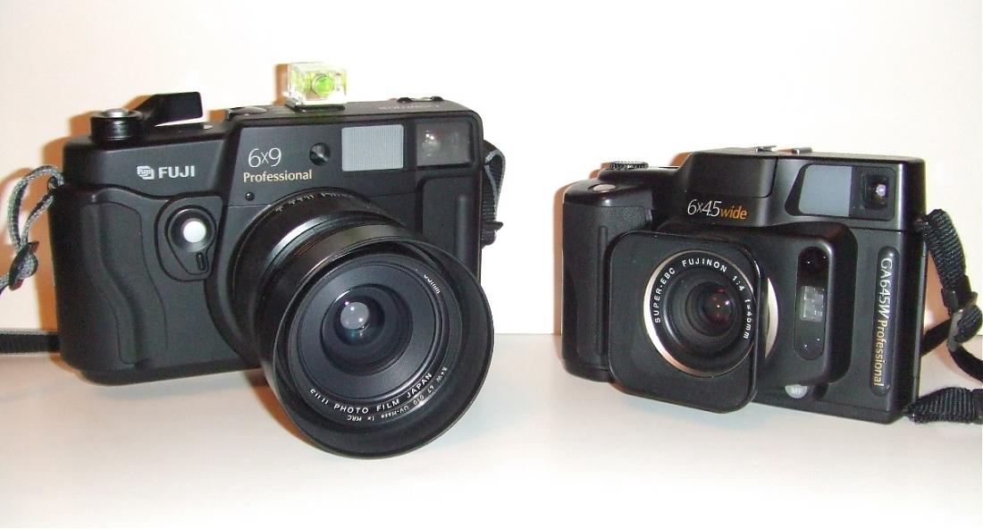

Here are two cameras I've recently purchased.
I've only made enlargements, so far, from the 6x9 and I am rather impressed.
The 645w is not much bigger than a Nikon F4 or F5. It is autofocus with aperture priority. Oh, and it has a built in pop up flash.
give that one a thought too.
