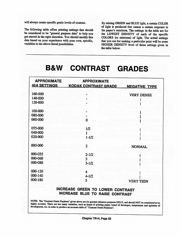

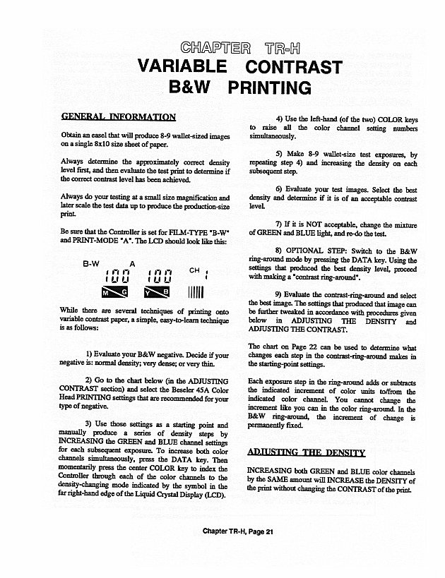

I have the 1991 manual and these are the pages that might help... or not...
Are these the same?

Thank you Kino, yes this is indeed an additive head. However, in the manual, showing what setting would create what contrast, Beseler shows a 2 1/2 grade as a -15 Green and a +5 blue. My issue is I can't seem to enter minus numbers. The ring-around shows exposure #4 as the best for contrast, and that is -15 G and +5 Blue. I completely understand your comment as I have printed with single filters, a #58 green and a 47b filter under there enlarger. There isn't a negative number there. The Beseler, however, does show minus or negative numbers all on its own in the ring-around.

Thank you Kino, your manual is completely different, not even close to mine. I will further read your manual and see if I can see how to set minus or negative numbers.
This is what I did for my first print - I did a test strip, in Black and White A mode, by entering 30 G and 30 Blue and then added 30 to each successive exposure until I reached 120G 120B. I am using 4x5 B&W negatives with a 135mm lens on a Beseler 45 style enlarger. The 120 G and B was the best exposure but flat. So, I pressed Data to do a ring-around. I then built a 10 exposure 8" x 10" easel so I could do the ring-around. The ring-around has 9 different exposures, the #4 exposure was the best of the 9, a little flat and a little light. The number 4 in data mode shows a -15 G and a +5 B, or a grade 2 1/2 half. This is where I am lost.
I am attempting to press the color button and enter the -15G and +5B. My issue is I can't find a way to enter -15 G or any other minus number. If this makes sense to you then please let me know what I am doing wrong. Otherwise, I will read and read again your post to see if I can find what I am doing wrong.
Thank you very much for taking the time to scan and post, I really appreciate it. I really want to use this head, as I can see that when I get to using it for split contrast printing, this head will really shine. Currently just attempting to print in normal B&W printing mode. I have 16 flash tubes so don't think I will have issues down the road.
Even if I just wanted to just enter a 2 1/2 grade, without the ring-around, I could not as I can't enter the -15 G as indicated by Beseler in the 1998 manual; the +5 B is not an issue. Hopefully all of this makes sense to you.
Please see if you can find my error.
I wonder if you should simply subtract or add the amounts of Green and Blue to your base settings of 120? You would then wind up with 105G and 125B. Have you tried this?
If the print is light, you could then up the exposure in equal amounts of Blue and green; say 110G and 130B and so on...
I am pretty sure this is how the head works: you raise equal amounts of G/B until you get proper density, say 120/120, then you vary the G/B ratio to obtain your proper contrast BUT the total for Green and Blue must equal your initial exposure of 240 total exposure units.
I think the confusingly written manual doesn't spell-out just how they use their math. Like many aspects of photography and lab work, math concepts take on multiple implications in the context in which they are used, and this is often not well communicated in technical writing by engineers. -5 green to a dichro head is a specific setting and -5 green to an additive head is subtract the green from the baseline green exposure; at least that's how I am reading it...

The big difference between the Minolta/Bessler head and any traditional dichroic head is that in the traditional dichroic head, the filters subtract color values from a fixed light source that is independent of the filtration, while in the M/B head the color values are directly coupled to the total output of each color flash tube.
You cannot separate the filtration from the exposure in the M/B head (unless you use supplementary filters under the lens, which defeats the purpose of the head itself), you can only arrive at a proper exposure by using a baseline filtration setting (same as a filter pack) and then vary the color balance by varying the output of each tube to arrive at the total required exposure.

Yes, I do indeed enjoy these heads a lot. I have 6 or 7 of them I think, and some spare tubes. That said I use mine mainly for color and haven't used it for B&W in a while.
Here's all the docs I have about it:
https://mypages.unh.edu/sites/default/files/ems/files/beseler_45a_manual.zip
The abovementioned concept of upping the numbers but keeping the ratio between numbers the same is correct. Higher numbers = increased density. (Though you could probably also stand to open up the lens a little too, f/11 is too far down in my opinion for best results assuming a good lens.)
Generally changing the difference between the green and blue (irrespective of the actual values of the numbers) will control the contrast. So if a net difference of 20 (-15G, +5B) is the right ratio, then keep that difference between G and B, and just adjust the numbers to get the right density. E.g. 85 and 105, or 100 and 120, etc. would all keep the same ratio, but the higher numbers = more exposure/density.
Once you get used to it, it's a great head and way more intuitive than any subtractive head I think. The built-in color analyzer and memory channels and what not are a super nice bonus too.
Hope that helps
