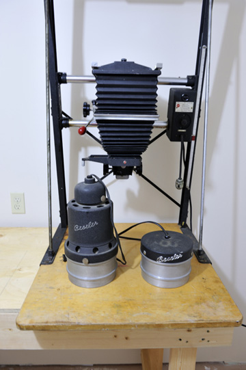

I purchased used Beseler enlarger model 45M recently. It come with two light housings. The light from the small one on the right is greenish in colour. The other one produces warmer light. Since this is my first contact with darkroom equipment I have no clue what these are. Is one condenser and the other one diffuser? If so which is which? Which one should I use for B&W enlargement and why?
Thanks so much for your help.
SloboM.

One is a standard condensor head (the larger one), the other might be a cold light head.
They has been a long running debate about which is better, test them for yourself and use the one you prefer.
I have used both and prefer the cold light.

The small drum-shaped lamp housing is a cold light. You set the enlarger to the 5x4 lamp position to use that one for all formats. If you use variable contrast paper expect some limits on your grade range. The standard condenser head needs to be set to the right height for the format. It looks like the scale is missing on the chassis in the picture - it screws in to the right front of the lamp stage. You can get the height for smaller formats by raising the lamp, focusing the image, and repeat until the light circle is just larger than the frame. For 35mm it should be about fully extended.
I retired my cold light a few years ago.
As for me, between the two, I'd use the condensor. I think old cold light setups require warmup time and correct me if I'm wrong, but cold lights are made for old graded paper that's blue/green sensitive. Also, cold lights are too dim for me. Makes focusing the neg a bit harder. But some people love it and some have shorter printing times with graded paper. It all comes down to preference.

That's interesting, I did not know that Beseler made a cold light. Anyways I have an aristo cold light on my 45mx and love it, it works great. I have used the condenser too but prefer the cold light. It has been a while since I have used a condenser, and may mount it back on again soon just to see what it's like. Try them both out and see! I like the piece of mind of using a cold light as there's virtually no problems with negatives being damaged. The warm up thing is kind of a hoax, it should have 2 plugs, and one just needs to be plugged in to a constant source (not the timer) to keep it at the right temperature. It takes about 2 minutes, which is almost nothing compared the time it takes me to get my darkroom set up for printing each time.
If the cold light has a blue/green color, it might have a tube for variable contrast paper.

The light that I have doesn't have two plugs. How do I warm it up if need to be?
When you first go into your darkroom before a printing session, just leave the enlarger turned on for a couple minutes, that should warm it up. Do that anytime you don't use the enlarger for like an hour, and you should be fine. The zone VI/aristo heads are quite nice if you can find one, I sold my spare one on here for like 50 bucks if i remember correctly.

If your a VC paper user, you might have some difficulties. You might have problems printing on lower grades.

The older Aristo cold lite heads had a V4500 tube in them and needed a CC40 yellow filter to enhance the light out for use with the full VC filter set on variable contrast paper! I don't know what tube is in that cold lite head!But most variable contrast papers have two emulsions in them, one sees only blue and is high contrast and relatively fast and the other sees only green and is low contrast and is relatively slow! The older cold light tubes were high blue output, that's why they needed a CC40 yellow filter.
