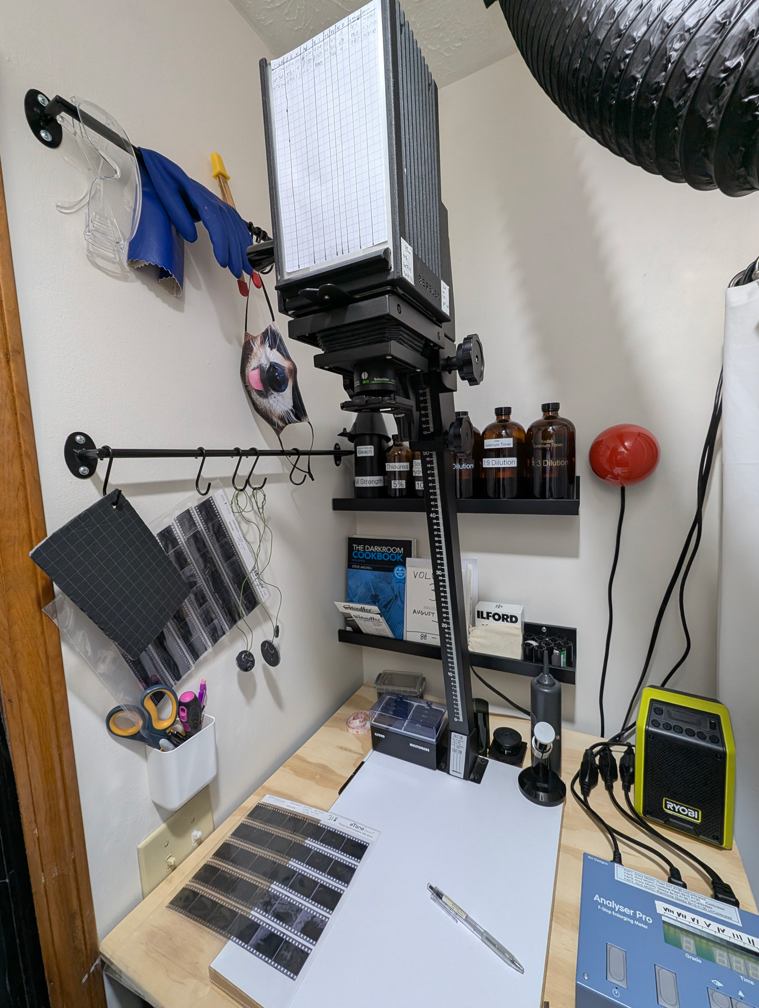

I'm using a Beseler 67 print head on a Beseler Printmaker 35 chassis (picture below). I've had this setup for a few years with no issues. The last couple days I've noticed an issue while printing. I'd focus, stop down, and print as normal but after a print or two my focus would be wildly off. I took to focusing before everything single exposure, but still ended up with at least one print that was slightly soft.
I'm performing a realignment now, but I really don't think that's the issue. When properly focused, the prints are sharp corner to corner. However, as an experiment, I focused the enlarger and waited for 5 minutes—leaving my grain focuser in the same spot. When I rechecked focus, it was completely off.
Anyone have experience with something like this? Is it possible that the weight of the lens stage is causing the focus to sag over time?

The negative is popping from the enlarger lamp heat. Try getting a heat-absorbing glass or a use a glass carrier that holds the negative flat.
I would check the head elevation lock and the focus adjustment. I expect one or both are losing a bit of their locking strength, and may need parts adjusted or perhaps replaced.

My bulb recently died and I replaced it right before the print sessions with the focus issues. I'm guess the new bulb kicks out more heat than the dying one. Just ordered a Beseler heat absorbing glass accessory. Thanks!

I just finished a full realignment, with the same issue. Pretty sure it's a negative pop. I checked and adjusted the focus mechanism and if anything, it was a bit *too* stiff. I slightly loosened the action. The elevation lock is solid.
I would think a simple test would be to shut off the enlarger for a bit to cool down and turn it back on and see if the focus is in the original state. That would point directly to the negative popping.
I tried this. Focused, turned off the head, came back five minutes later: focus is soft. Refocused, left the head on, came back five minutes later: focus is tack sharp. This, coupled with the fact that I never had this issue before swapping the bulb, points to it being heat issue.
I'll update once I get the heat absorbing glass. Thanks for all the helpful replies!
