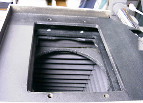

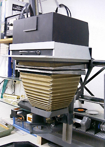

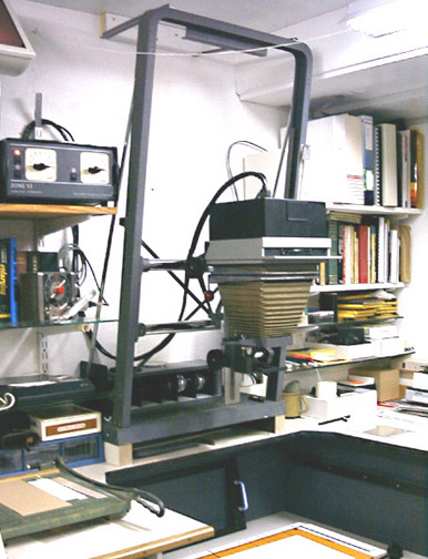

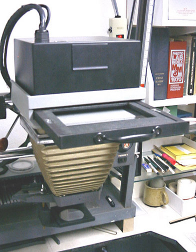

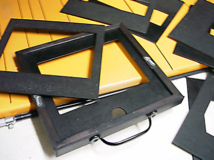

A few years ago I converted one of my back-to back Beseler 4x5's into a 5x7 by adapting a Zone VI cold light head.
Now, when I switch between my smaller negatives and my 617 panoramic negatives, I just turn around and use the other enlarger. Since both are Beselers, they handle identically.
The conversion was fun (but then, I like designing and making things...)
I used high density Masonite and thin Baltic Birch plywood (both are easy to work) to make a nice precise adapter for the 5x7 Zone VI lamp house as well as various negative carriers.
To avoid clipping corners, I had to machine away four corners in the upper frame which are visible in the photo.

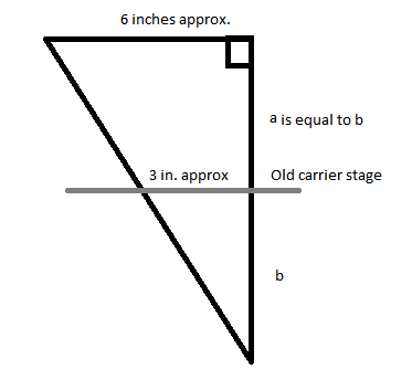

The Beseler 45 negative stage opening is 6.5 in. (approx) in diameter. You take half your format diagonal and the extension of your lens from the film plane as the two short sides of a triangle. That triangle has to fit through half the width of the Beseler lens stage opening. (It is actually a cone of light, but triangles are much easier to use). This gives you the negative height above the old lens stage, and the lens position below. And that determines your light source location.
You need the angle of view of your lens, as this will set the scale. The lens needs to 'see' past the old stage to the corners of the format.
I went through this working out an 8x10 adaption. The attached diagram may help, but use your own measurements, it is from my 8x10 notes!
You may need a spacer to get the carriage further out from the frame so it clears the cross bar. Not sure about 5x7 - it is definitely an issue with an 8x10 adaption.

Thanks, that makes sense. The half-diagonal of 5x7 is only a little over 4”, so I shouldn’t have to elevate too much from the standpoint of clearing the negative stage. This is an old Beseler 45AF with no crossbar; I don’t think clearance at the top will be a problem, but I’ll take some rough measurements.
Filters are going to be a concern. I’ve got the 6”x6” Ilford filters: too small to go above the negative, I may have to rig up something to hold them in the original negative stage, which will throttle the opening there by a small amount. What was your solution for filters?
