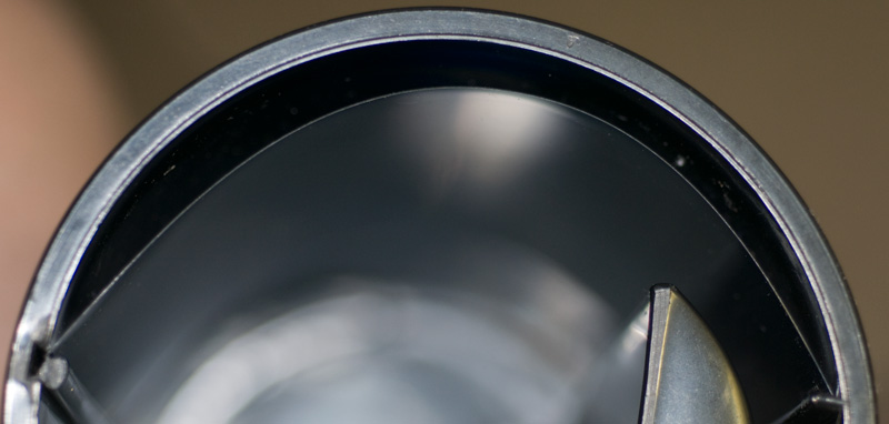

I bought a Beseler 8x10 print drum that I intend to use to develop 4x5 film. It has the insert. I put a sheet of 4x5 in it to see how it fit. It has a pretty large gap between the film and the drum wall. I attached a picture showing the gap.
Is this correct? From what I read in other posts I thought the film would be touching the drum wall.

Looks about right, when I put a piece of 4x5 paper in the drum, there is an end gap of well over 4mm between the edge of the paper and the divider strip when I push the paper against the stop.
When it gets wet it will stick to the wall.
