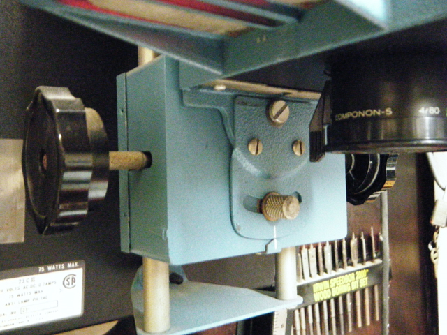

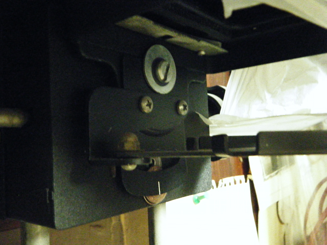

mine is solid as a rock. on the back of the unit there is a cover you can remove to adjust the tension on the focus knobs. Also on the front underside there are a few screws that allow the lens stage to tilt side to side and is kept in place by a small knurled knob. at what point is yours lose?
BTW I used a few brass shims under the knurled knob to bring the stage parallel front to back.

Your photo looks like a 23C, not the 67c. Or it's a very different generation of the 67c. Dead Link Removed is close to the version I'm dealing with.
paul ron
Jan 22, 2004
2,709
NYC
mgb74
mgb74
Jan 24, 2005
4,783
MN and MA US
This one is the mono column version. Actually, I think there were 2 mono column versions; one with a larger column and one with a skimpier one. This one is the larger (but single) column version.

yup yup yup. I see your problem. It is the same head n mechanisms.
The short answer is tighten everything down, use loc-tite to keep it place. check the bushings n tension springs. Those delrin bushings can be the problem if missing.
While you have it apart, lube everything in the focusing mechanism too.
