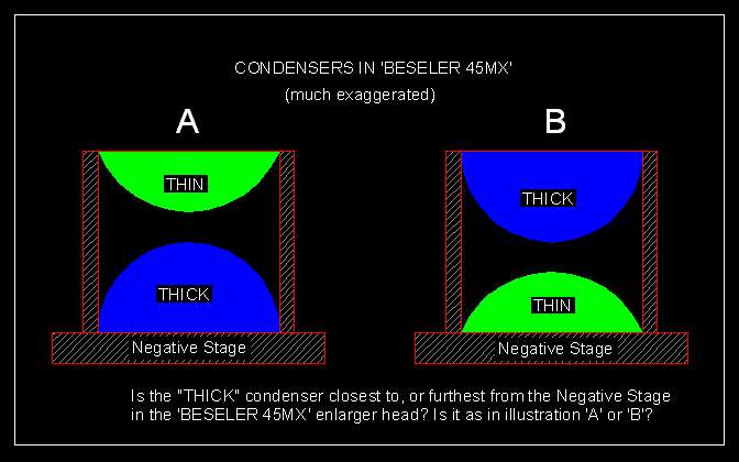

Hi all,
A question concerning the stacking order of enlarger condensors.
I recently purchased from that big internet auction place a used 'BESELER 45MX' enlarger with the double condensor monochrome head. As the inside of the condensor housing had accumulated much dust, I stripped out the condensors and the heat absorbing glass for cleaning. On re-assembly of the unit I discovered that the condensor lenses are not identical, in that though the diameters are the same, one of the lenses is more convex than the other.
-one could say that one condensor is "thicker" than the other.
Could any of you 'BESELER 45' users out there please tell me whether the "thicker" condensor should be stacked on top of, or at the bottom of the condensor housing? Or, to put it another way: Should the "thicker" of the two condensors be closest to, or furthest from the negative carrier?
Thanks for your time,
Deryck

On both of my condenser heads one lens is plano-convex (one flat side, one curved side), and the other biconvex (two curved sides).
The plano-convex lens goes on the bottom of the condenser housing with the flat side toward the negative stage. The biconvex goes above it--there is no particular orientation of this lens as both convex curves are the same.
Now I'm really confused!!! Are we still talking about the condensers in the 'BESELER 45MX' ? Both of my condenser lenses are plano-convex, though I guess you could say that one lens is more plano-convex = more curved on one side = thicker, than the other. The 'BESELER 45MX' manual clearly states that "the upper and lower condensers are NOT INTERCHANGEABLE" !!!

THANK YOU NICHOLAS, that answers my question exactly.
Cheers!
Deryck
Hi,
Just for the record:
I recently received an email from 'BESELER' concerning the condensers in the 45M. The two condensers are NOT identical to each other. They are both 6½" in diameter, and are both plano-convex, but the "thicker" condenser is placed closest to the negative stage - as Nicholas previously informed us.¨
Deryck
