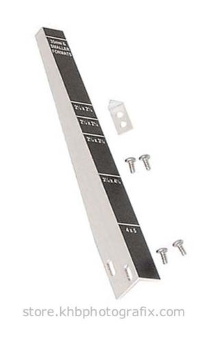

KHB in Canada also has the part. Or if you can figure out the overall length you could use this picture as a guide.

This is from KHB's site: "This is the part Beseler refers to as the "Negative Stage Guide" or "Negative Size Indicator Kit". When a colorhead is installed, this scale is typically removed, and thus often lost. Occasionally the scale is accidentally broken off."
I guess that explains why it is missing.

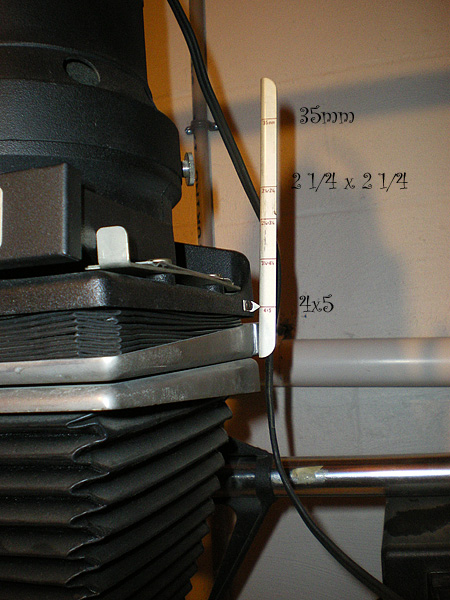

attachment.php
I posted this before - hope it helps again!
It's 3 inches from the 4x5 line to the 2 1/4 x 2 1/4 line. The whole thing (measured from the 4x5 line) is just under 6 inches.
Thank you for the image winger, this helps a lot and now i have all the information i need to create the guide.
