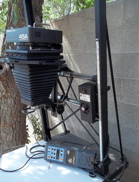

Sorry I should have added photo's first,but here is a photo.
I mainly need help on how to use the controller and color analyzer.

Er, is that a Minolta 45A head on a Beseler enlarger chassis? (The picture is too tiny to see for sure...)

Yep sorry about that. It comes up pretty big on mine for some reason I'll try getting a better one.

Here we go
