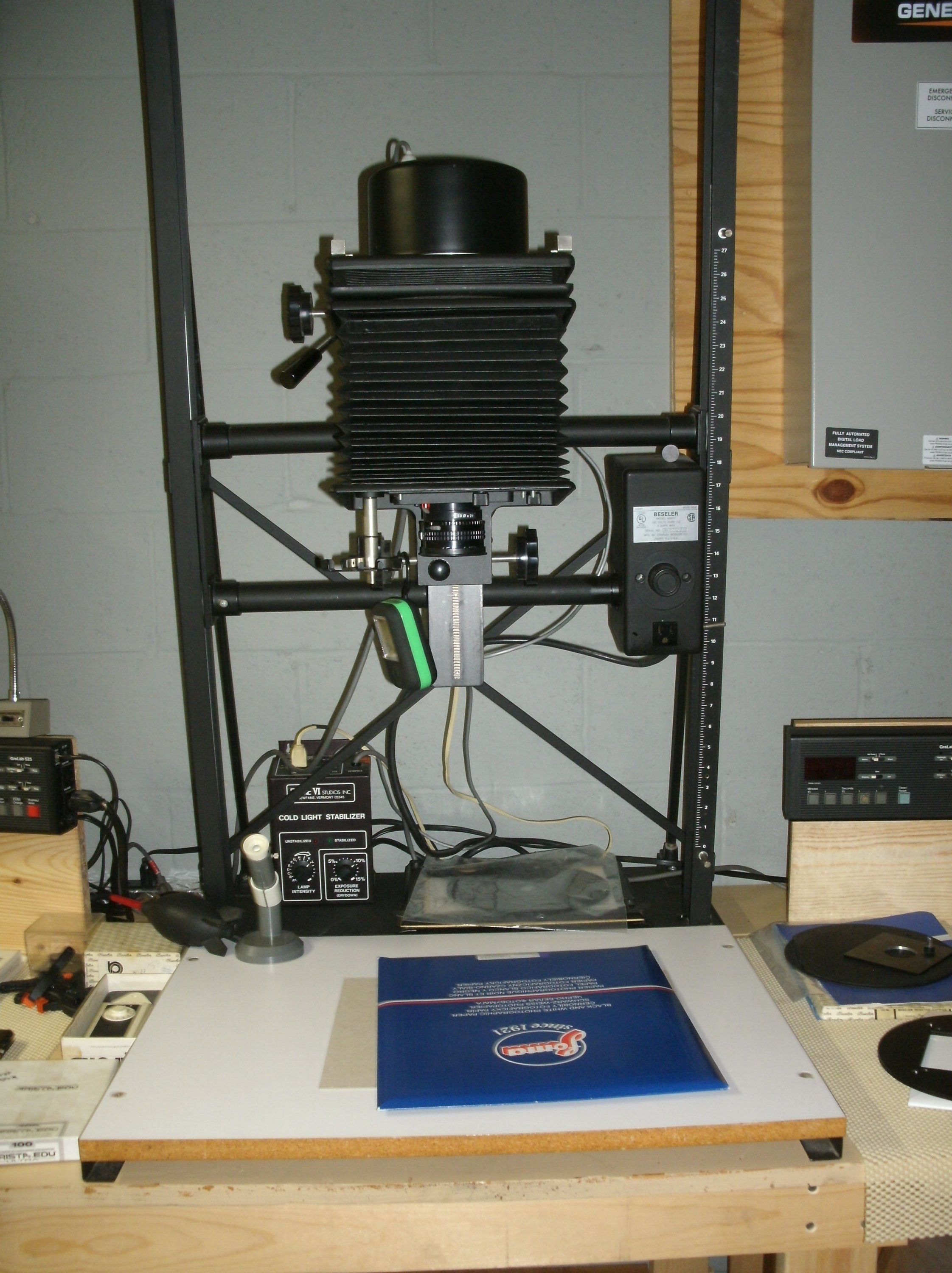

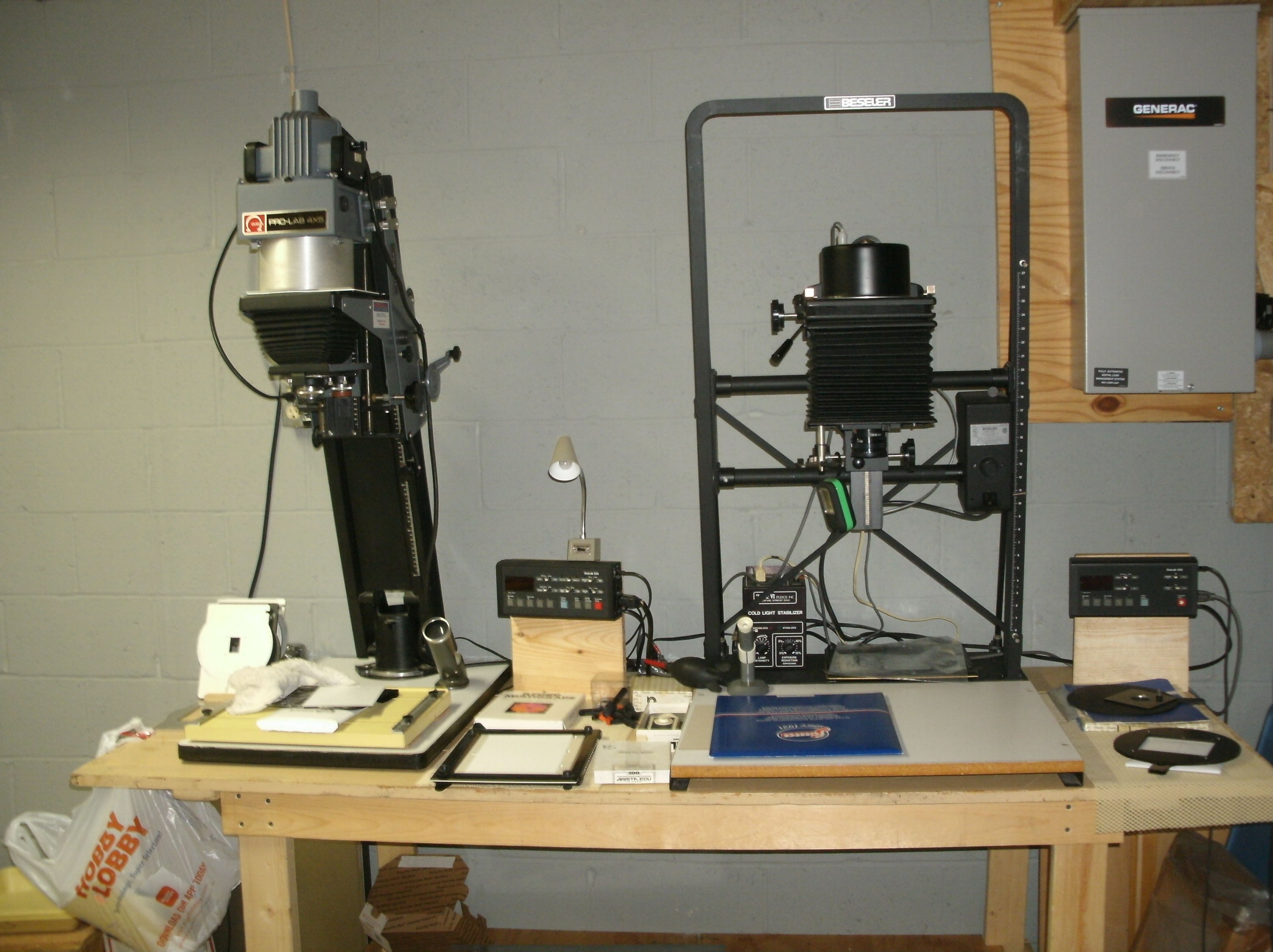

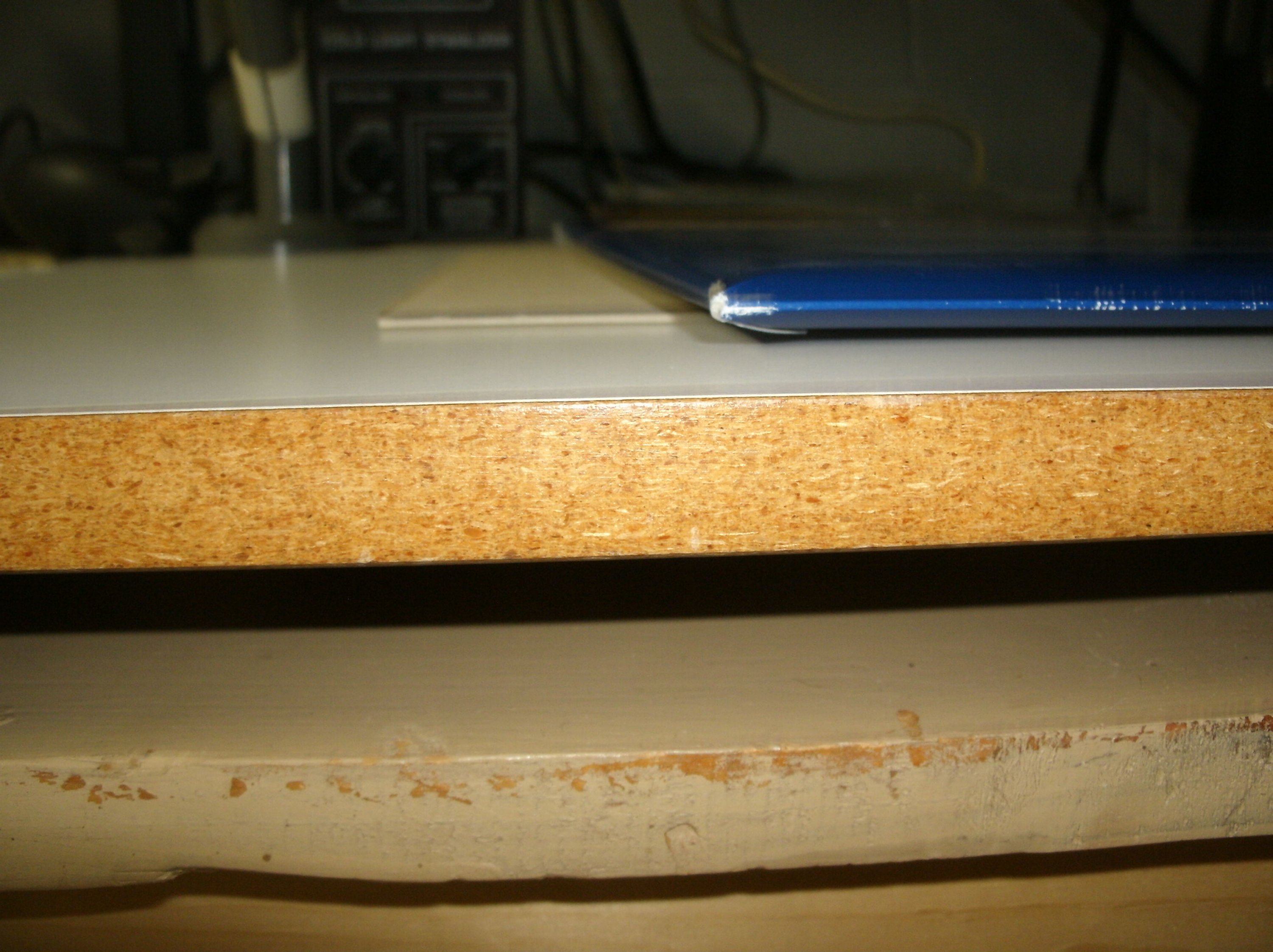

Because of its size, I wouldn't recommend using a movable support, it's all about stability. I have my dark room in the basement and won't bolt my machines to the block wall. I could mount them to the framed partition wall, but that transmits vibrations, so that's out. I built a 2x4 base and used an old plank door for the top, solid as a rock, no vibrations. If you can find a used 30"(or 32") 80" solid core passage door for the counter top, that is even better. A quick look at my enlargers.
View attachment 299961 View attachment 299962 View attachment 299963
Very handsome setup. Omega and Beseler, peaceful coexistence!:smile:
Omega is a condenser unit, the Beseler is cold light. Decisions, decisions, which will produce the better print with which negative.........
Somewhere I have an adapter that allows use of the Beseler color head (Dichro 45s) with the old school Beseler condensers. I tried it and it works, on VC black and white paper it picks up about 1 contrast grade. I never use it, but it's cool.:whistling::laugh:
That is a great setup - looks sturdy as hell. Thanks
