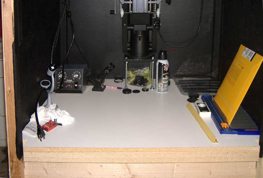

I replaced the base plate of my Omega D5 with 1/2" thick cold rolled steel and suspended it above the base with 3/8-16 threaded rod that goes through the entire base. Originally I had planned on steel columns between the base plate and the base but the threaded rods surprised me by being more than rigid enough. With this setup and the lenses in the turret I can enlarge my 3 most common formats (35mm, 645 & 4x5) to around 34 inches wide.

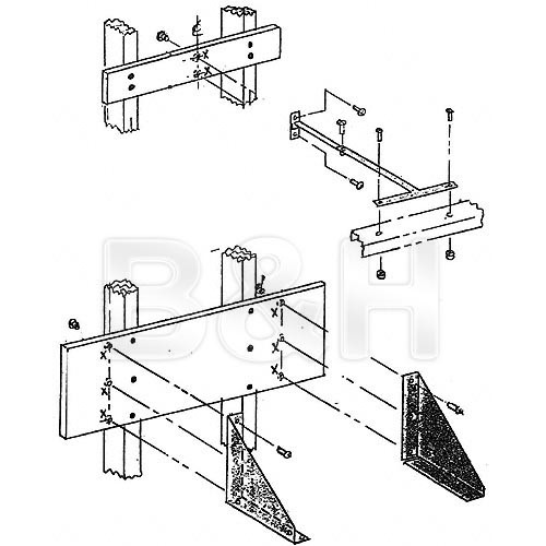

Beseler sells a wall mount kit (like $250, ouch!) for the MX series. I think it would be simple to recreate this with plywood and good bracing. I believe the screws that go into the base are 1/4-20, a common size to find longer ones.
The piece on the top is a brace for the top of the frame. This doesn't need to be amazingly butch, just stiff enough to kill harmonic vibrations and there could be many solutions.
I'm about to buy an MXT and will wall mount it, but I want it to come out 8" or so from the wall. So I'll need a well braced plywood box that I can adjust a bit. I'll likely do the "triangles" at the bottom with 2 layers of 3/4 plywood. Main thing is making everything square and well braced. I'll also screw a large piece of plywood to the wall across several studs.

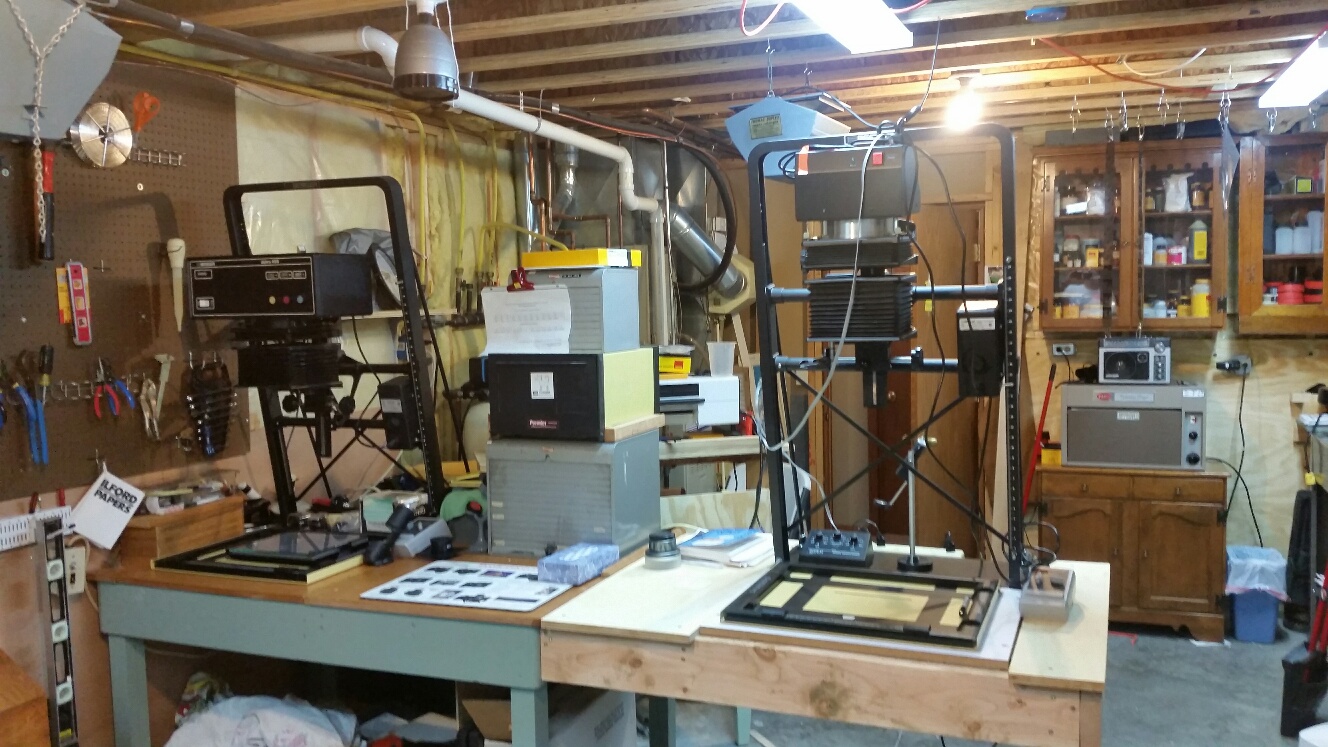

I have plenty of room so I went for being able to pull base board and project to shelf below. This is not a great shot but the enlarger in the left is setup with a 20x24 easel on a shelf below main base board. Unit on right just pull out the board and it will go 30 x 40 on the floor. The wall mount is a breeze for the 45 MX. Like M Carter shows in illustration. The enlarger rails come right off, and yes I believe it is a 1/4 20 tpi standard machine screw . I've never been a fan of wall mounts, but whatever gets the job done here you can see table I have used for years, added 2nd enlarger on right later on.
