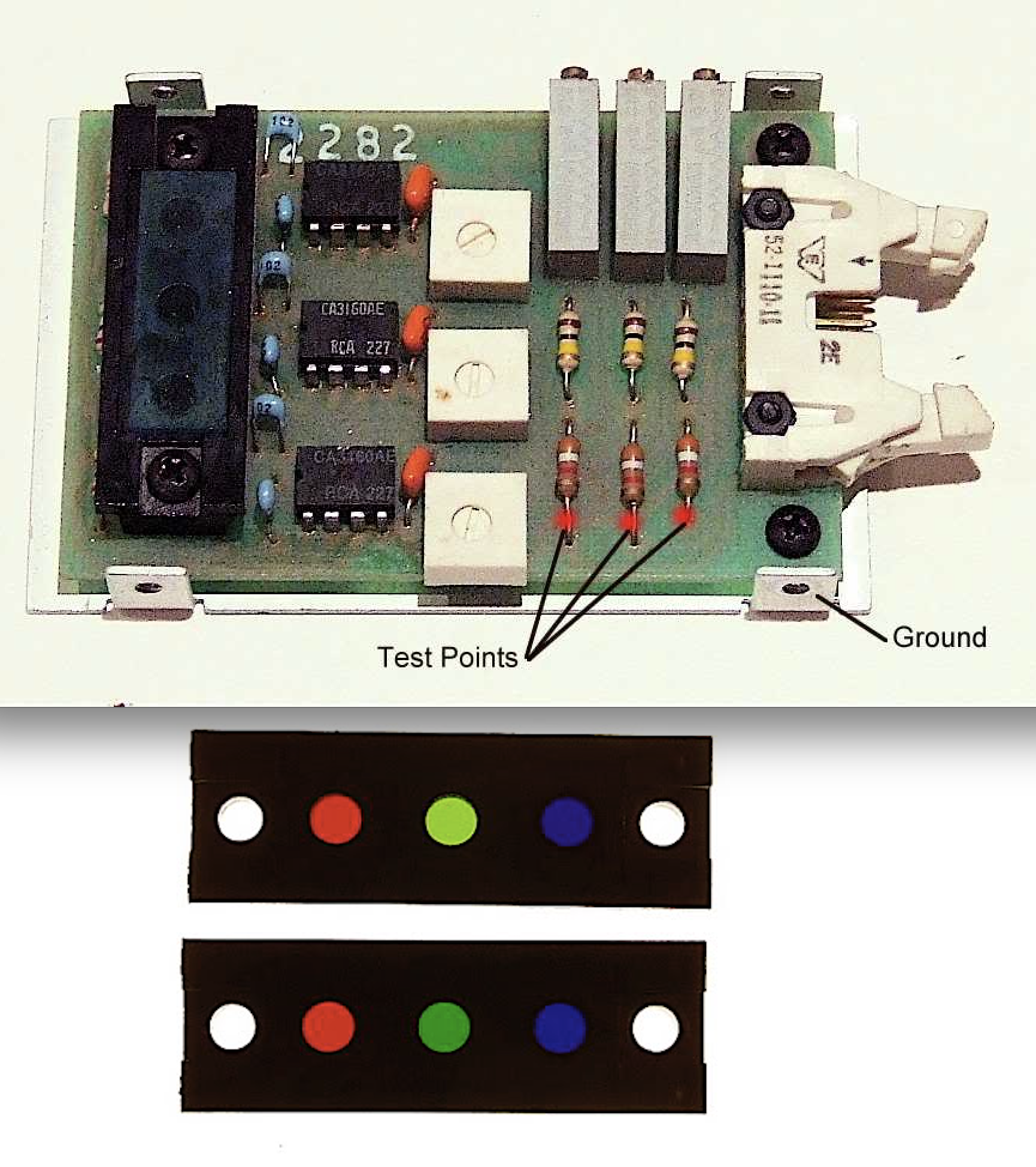

So you have no owner's manual or service manual? I do know the competitor's system (Omega D5500) has 3 places for tuning the response of each color channel.
1) The actual Wratten filter over the sensor
2) The internal trimmer to calibrate the photocell
3) The external trimmer to zero the channels every month or so.
I had to adjust all three on some of my enlargers. For example look at how there is a difference in the green filter on one of my sensor probes. I replaced that with a new green Wratten and re-calibrated to optimize my Magenta channel response.
In your case there may be an issue with the calibration or filter of your blue sensor.

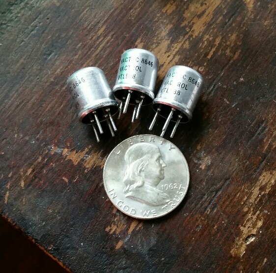

The old Dichro 45S had a opto-isolator that went bad, a Vactrol neon job. This causes the lamp to delay when switched on, totally randomly. When Beseler was still Beseler I got ahold of a guy in their service department that told me what I needed, they had long since given up as the parts were obsolete. This was at least 20 years back, I found a guy in NYC that had a warehouse full of old components. He dealt in bulk, but he sold me 10 of the little buggers. 4 leads, solder it to the board worked perfectly. I fixed at least 4 of these things. Those are all still in use by young fellas I hooked up with enlargers. Here's what fixed the delay.
Vactrols are still very common for a variety of applications. As a hobby other than ham radio I spend time (and money) building modular synthesizer modules. Vactrols are great for isolation purposes. One can even build them
from an LED and an LDR.

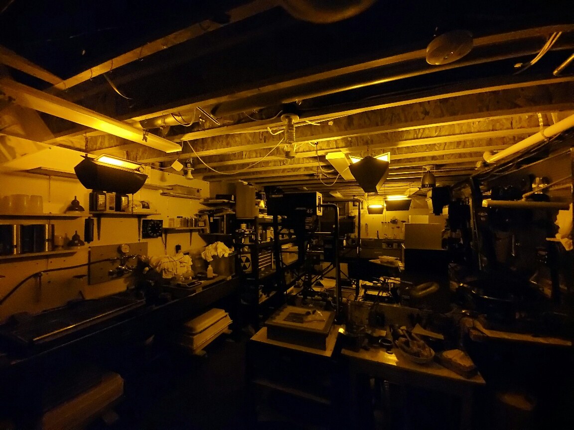

There's five enlargers set up in this shot with my Thomas safelights going. I'm just glad I don't collect steam engines :smile:
