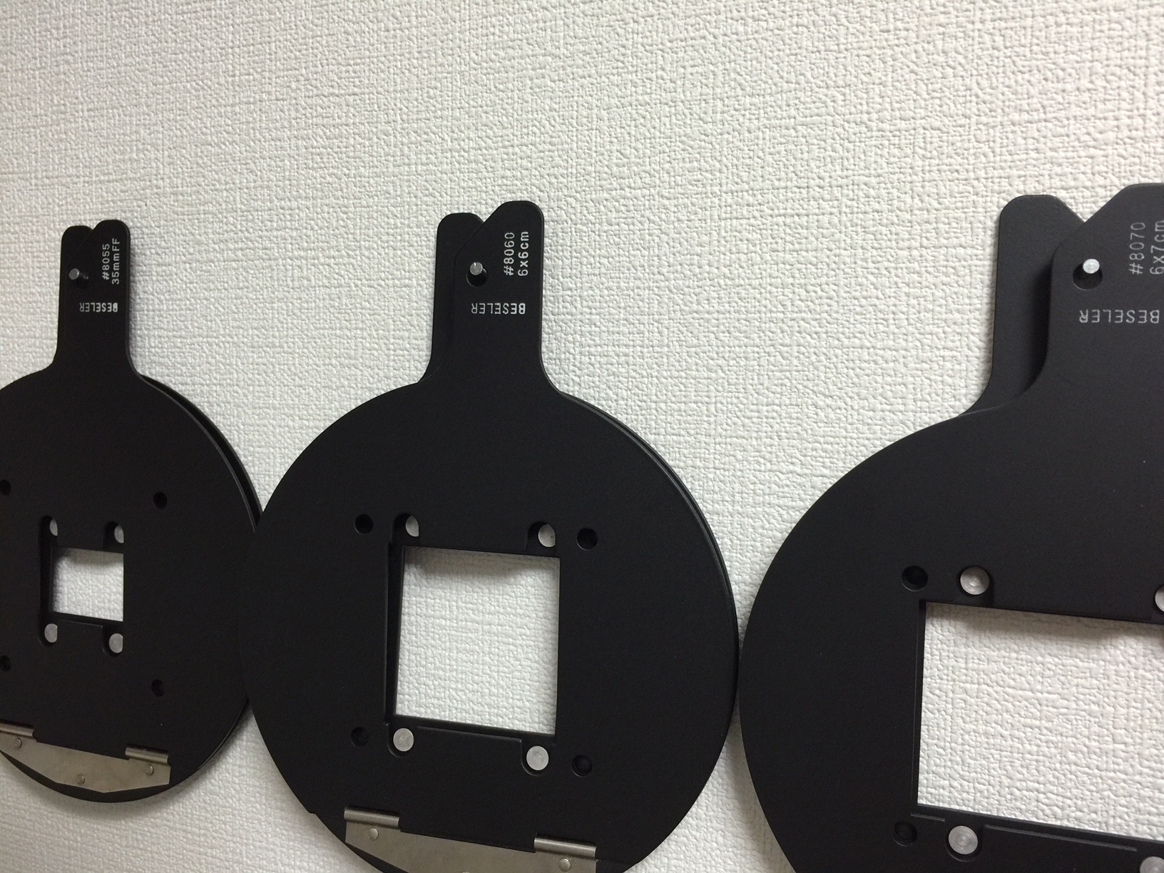

Below is a picture of the 3 carriers I have.

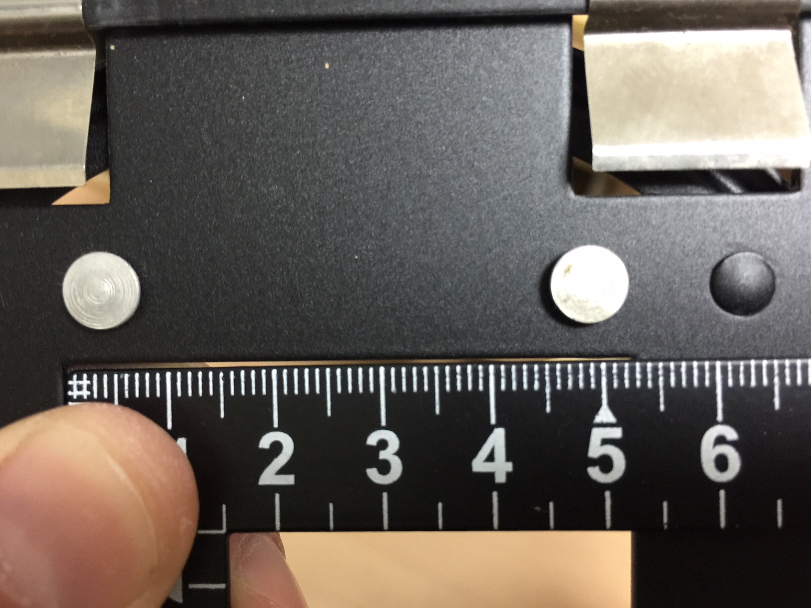

Hello again,
Here is the photo with some amateur measurement. Looks like the holders opening is 53mm all around.

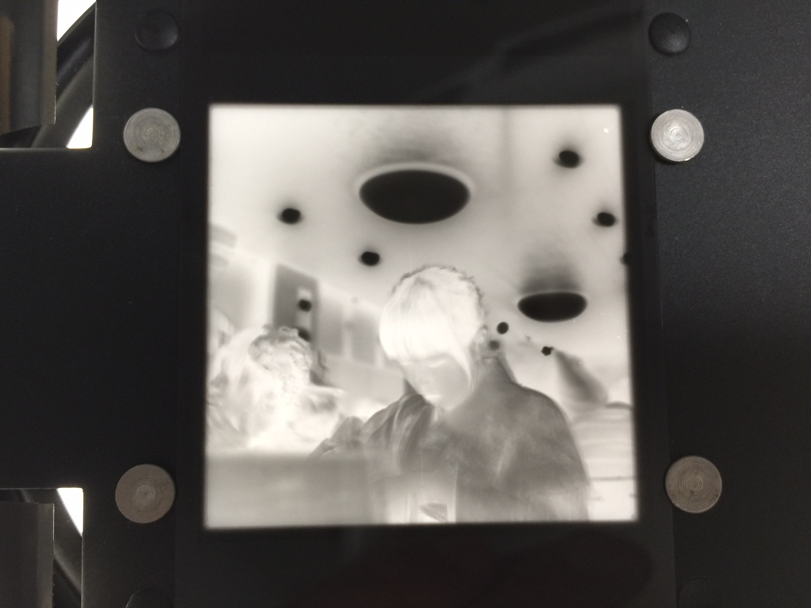

Here is a negative inserted although you can't see much. The image hangs over the holder by at least a mm on every side.
Is this normal?
Thanks,
Ben
