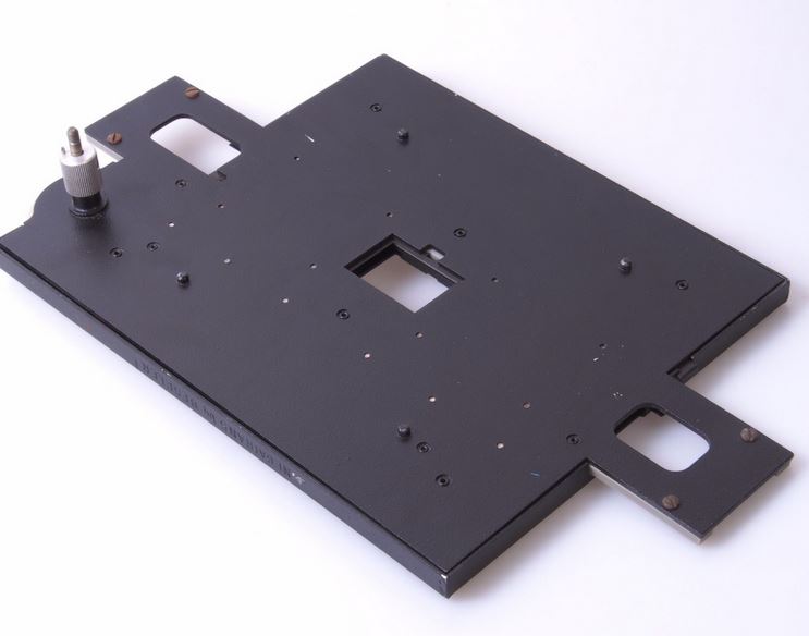

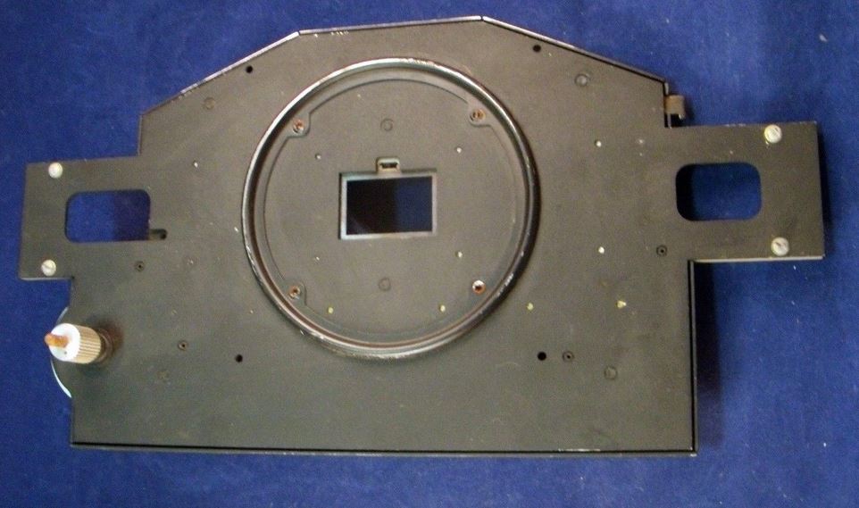

My son has developed an interest in film photography, and we are wanting to revive my old darkroom equipment. I have a Beseler 23C enlarger, which I believe is the "version II" (blue color) from the 60s-70s. My question is regarding the Negatrans accessory. On the auction website I have seen two versions of what is listed as a Negatrans for the 23C - one has a round flange or collar on the bottom, and the other does not. Which is correct, and what purpose does that collar serve? I have uploaded photos of the two versions.

If you're referring to the ring (top photo) vs the bottom photo, the one on the bottom has
little pins, and they are for centering it in the enlarger...I have 3 of the negatrans for
35, 120 and 6x7 for my Beseler 45V XL. Mine are like the one pictured on the bottom.
I will take a closer look at my enlarger and see if it indexes into the round hole or if it
has corresponding holes....
Were you looking to buy one for your system? They are a cool tool, but definitely not
necessary. I filed mine out slightly to allow for some framing. The do hold the negative
nicely in place.

It's been a while since I've had a Negatrans, but my recollection is that the little pins were removable, and possible even MOVE-able, to make it work with either the 45xxx enlargers or the 23xxx enlargers. As pictured there, I would say the one with the ring is currently set up for the 23 model, while the one with the pins is currently set up for the 45 model. Note the one with the ring has holes for the pins (but oddly I don't see properly spaced holes on the one with the pins, that would allow them to be moved to a 23-friendly position...hmmmm...)
Duncan
Hmmmm, indeed. I also just noticed that the top edge of the top one is three sided, while the top edge of the bottom one is straight. It's a head scratcher.
The first will fit the 23C but the second fit only in the 45. Even if you moved (or removed) the pins, the back will hit the side strings.
Beseler did some Negatrans that fits the 2 models you will see clearly by the sketch on the back of the carrier.
Even if the O-ring seems fine, it will break when you will use! Better to replace, the replacement o-ring listed on eBay are correct.

FWIW Beseler Negtrans #8078 (35mm) and #8097 (2 ¼ sq.) are for the 23 series heads. Instructions are here:
http://www.jollinger.com/photo/cam-coll/manuals/enlargers/beseler/Beseler_23C(newer).pdf.
