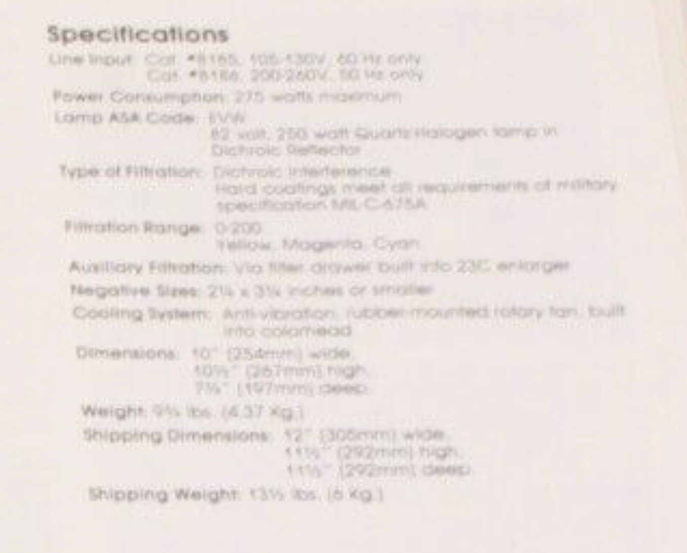

When the new EVW bulbs for the dichro arrived yesterday, I put a fresh bulb in. It all works fine for a few minutes, then that SECOND bulb for the dichro head burns out :sad:( I'm totally disappointed now. I check the voltage coming out of the timer, it's at 120V. I checked the voltage coming out of the contacts for the bulb. It's at about 71.7v.
The new bulb is rated 82V and is a GE, real bulb. EVW, as stated in the manual.

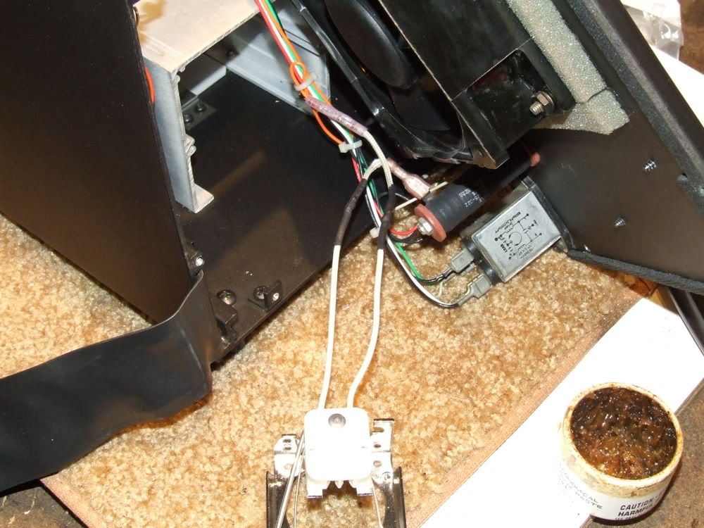

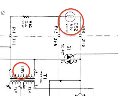

In a typical pulse wave modulated switching power supply (like might provide 82V for your lamp) the mains voltage (120V nominal, in your case) would be connected straight to the switching triac.
If the lamp socket is not making good connection, it can spike up to 120V to the lamp and fry it instantly, as you have seen.
If this is the case, the solution is to replace the lamp socket.

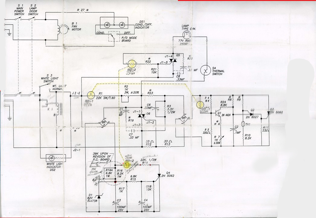

Hello!
I found some diagrams of a Dual Dichro. Not sure of which model. I am attaching it here in case it can be useful for someone else.
