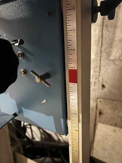

Does anyone know what this red area on the enlarger height scale means? I have the manual and it's not mentioned. Any ideas?

This is a index mark for horizontal projection. The pointer needs to be at or below the red mark to insure that the condenser lamp house will clear when positioned.
Ian C
Feb 8, 2009
1,301
The 23CII Owner’s Manual says the same thing without referring to the red band on the column.
On page 4 you can read instructions for pivoting the projection assembly.
“J. Oversize Prints
1.
. . . Make sure the pointer arrow on the carriage is set to #9 on the Elevation Scale to ensure clearance between the lamphouse and frame. . .”
You can see the carriage height indicator positioned centered over the red band in the photo of Figure 2 (forward of the elevation crank). Unfortunately, the red band isn’t mentioned.
I checked the 23CIII manual. The wording is the same. The red band is not referenced. Nor is there a photo of the area as is given in the 23CII manual.
