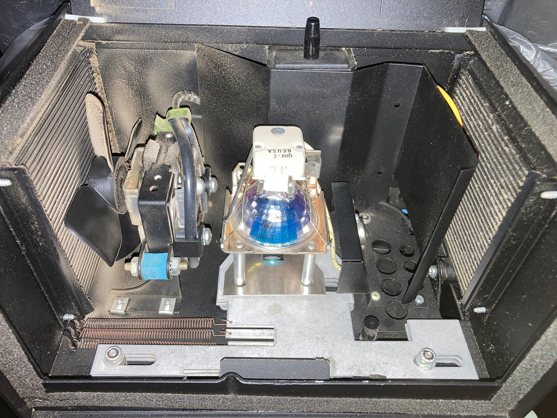

Afternoon!
I did as suggested and rubbed the contacts of the socket with a dead bulb I had lying around. No change.
Head info:
105-130v 60Hz
275 Watts Max Lamp 250
Attaching a picture of the lamp compartment in case any of you find it helpful.

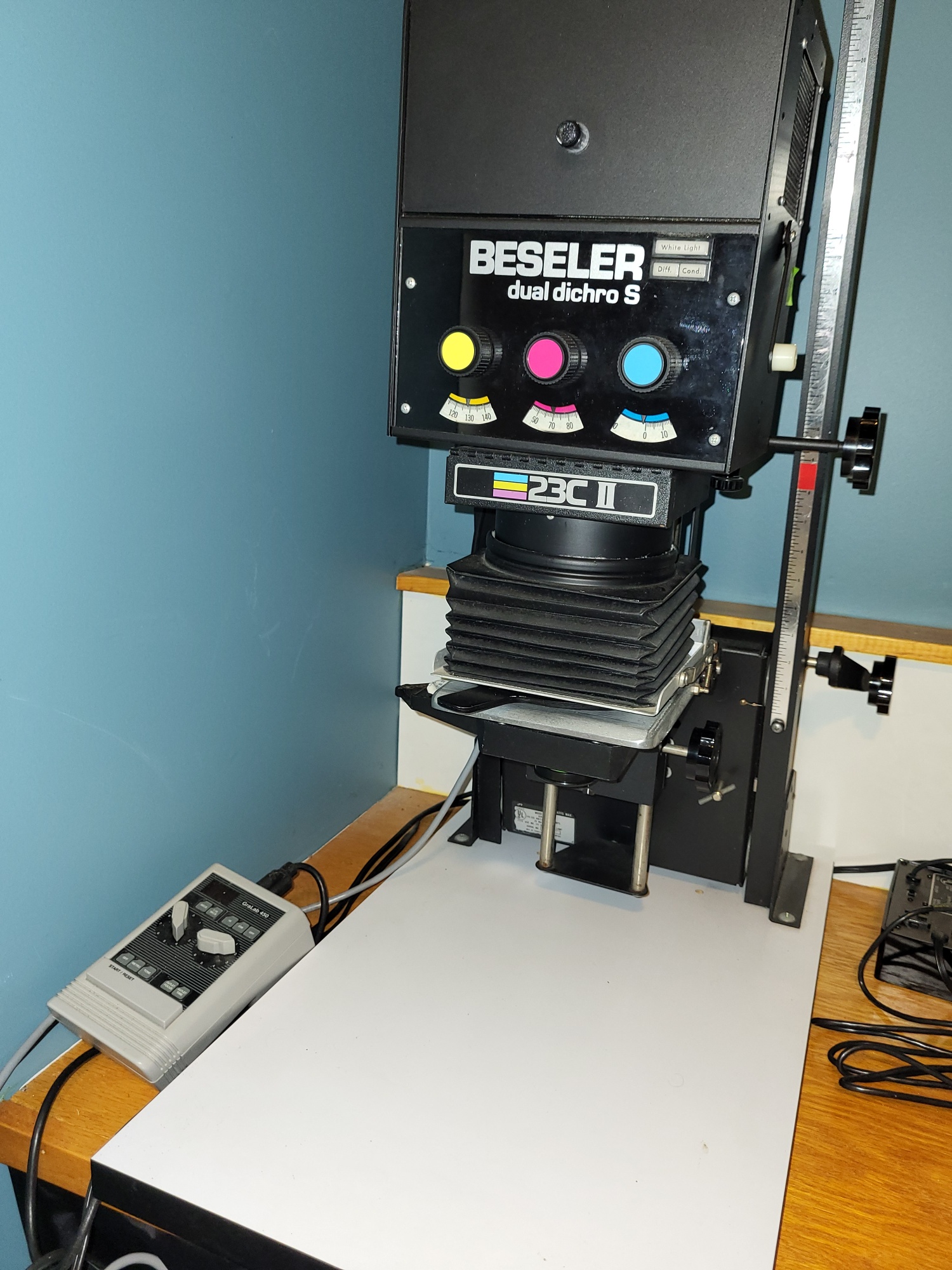

So could you perhaps just post some photos of what you do have?
It's all mentioned as far as I'm concerned,
Beseler 23cii, Dichrome Duel-S head, Gralab 450 Timer.
Never had a standard or stabilized power supply, never needed it.
Attached is an image from a few months ago.
Al--Pacino
Aug 19, 2024
11
Queens, NY
OK, so your wall socket outputs 115V. The bulb in your enlarger runs on 82V. Where does the voltage get transformed in your setup?
Never said I was an electrician, never learned about it in art school either.
It's to be understood that one of these power supply is required, but is not sold with the unit?
