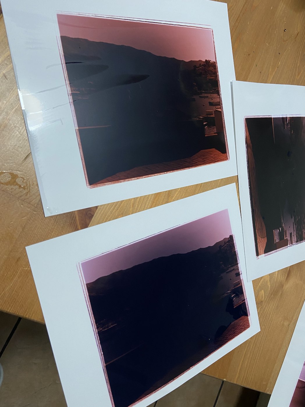

I recently acquired a Beseler 23c II with a dual dichro head. I've just started printing on it, but am running across the issue on all my prints where the center circle of the print has an extremely dark exposure compared to the outer edges' exposure.
I've tested this across a couple different lenses, as well as trying a few of the side control settings noted for the negative size, yet the vignette remains. It's noticeable enough that I can see it on the projection in the darkroom (the center being much brighter), but when I remove the lens and look upwards in to the negative/light, it seems like it's fully open with nothing blocking it.
The prints are also coming out fairly purple / red - the top exposure is at 60y 60m 0c, the bottom exposure 30y 30m 0c.
Wondering if anyone has encountered a similar issue on this machine or if I'm missing something? Thanks in advance.

It sounds like the head is not fitted correctly -- too high or low -- or something is missing -- diffuser, etc. etc. Maybe that's why the previous owner sold it.
Do you have a manual for the 23C and the colorhead? I'd make sure both are set up correctly -- before anything else -- and then that they are adjusted for the format and lens you are using.
If you've done all that, then wait -- others will jump in with their guesses -- Try this, Try that, Do this, Do that, Here's what I did, Here's what I'd do -- "grain of salt"

However I'm still stumped to figure out what's causing the intense hot spot/reverse vignetting in the center of the enlarger light - seen here with and without the lens board on:
When I adjust the right side lever to switch film size formats, the hot spot remains.
I'm in diffusion mode and using it at the 6x9 film size setting as instructed.
Regardless of the lens aperture (2.8 vs 22) the vignette remains in the prints. It remains with multiple lenses at several different enlarger heights.
Essentially every print I make has this intense hot spot where the center is 2-3 stops darker than the edges. It doesn't seem as much of an uneven illumination issue as much as it is a direct center hot spot. I'm using a diffuser / in diffusion mode. I assume that the light should be appearing pretty even in the above images of the direct light projection?

Sorry, I'm not familiar with this enlarger, but what I see is a massive problem with a diffusor. Doesn't look like a lens aperture problem etc. to me.
I'm wondering about this here:
Is that rectangular insert supposed to be inside the diffusion chamber? It almost looks like a sort of chute that would channel the light from the bulb directly to the opal glass underneath. If so, this would indeed create a very pronounced hot spot.
Maybe someone with the same enlarger can confirm whether that part is supposed to be installed inside the chamber, and if so, that it's complete as shown in OP's photo above.

Thank you endlessly! I have no idea what this is but I was able to take the color head off and lift it right out of the diffusion chamber. The simplest solution for weeks of headache. Hot spot is gone now and everything running smoothly.
I think you're on to something about it being an accessory for 35mm negatives, since with it installed I was able to print 35mm negs no issue, it was just affecting 6x6/6x7.

I bet that's it. For their 4x5 enlargers, Beseler made two light intensifying mixing chambers (for 6x7 and 35mm formats) for their diffusion color heads -- to decrease exposure times for smaller formats. They replace the standard mixing chamber and have smaller light output ports. They don't look exactly like what's pictured -- they are round and larger, of course -- but they do the same thing. If either were used with larger film formats the light fall-off would be SEVERE!!!!!

That object is a light intensifier for 35mm negatives. Now that I see it out of the head I recognize it. I believe it’s only for use with the color head. I have mine in a box somewhere, I don’t think I ever used it. Glad you got that figured out- it would make a heck of an obstruction in the middle of the light path!

That part is NOT meant to be used with the 23c II enlarger and Dual Dichro S dichroic color head.
The color head is a direct replacement for the factory bulb holder. NOTHING is supposed to be inside the enlarger body other then the diffusion or condensor lenses.
The bottom outlet for the dichro s color head when in DIFFUSION mode is a plastic piece that looks like a waffle. The white cone/funnel is for when the machine is in condensor mode.
Because the Dichro S head is not built on the same output lines as the factory light bulb version, the height scale is not exactly "spot on" for most negative sizes.
