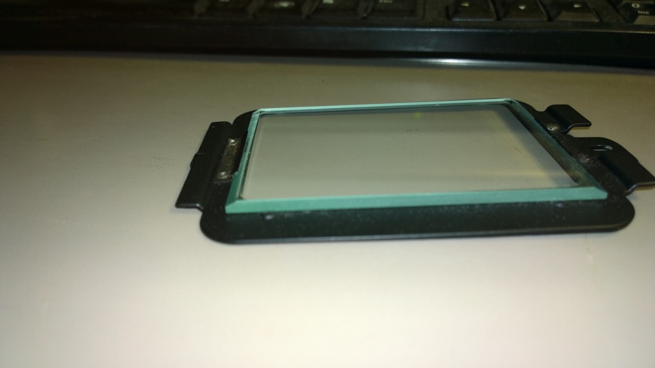

I found it a little sooner than I thought. Do you have the metal frame for the glass? There is an embossed arrow, push the tap and it removes. Pictures below. 2.19" wide 3.25" long .13 thick (1/8 inch) note the bevels on the ends. One of the metal clips unscrews. I don't think it's anti-newton but maybe it should be.

No, I am missing the metal frame too. Thanks for the measurements on the glass. You are right - I mis-measured the width of the o-ring. It is 3/32" or 1/8".
