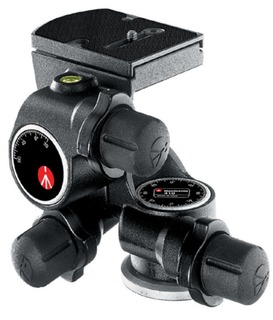

Both the 8023 and the 9033 are over 17 pounds load, on is 8 and one is 10 kg, I see that the 9033 has an integral head which might be good and it would be shorter than mine with a head mounted on it. I can change the head though, I have a Manfrotto 410 head that works very well and I like using it. It seems perfectly matched to the tripod. The Bogen 3047 head is on most of the time with field cameras.
You brought up questions I hadn't thought of regarding carbon fiber tripods, let us know which model tripod you get.
