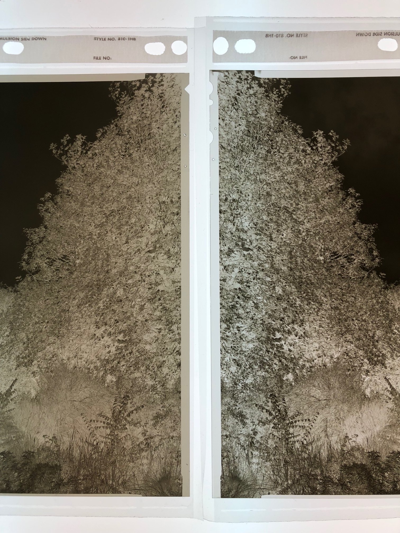

A quick pic of the Pancro and HP5 negs to illustrate base fog / density...
I was also surprised by the amount of base fog in a roll of 120 I shot last Autumn. Still printed quite nicely, though. I stuck it in the gallery.

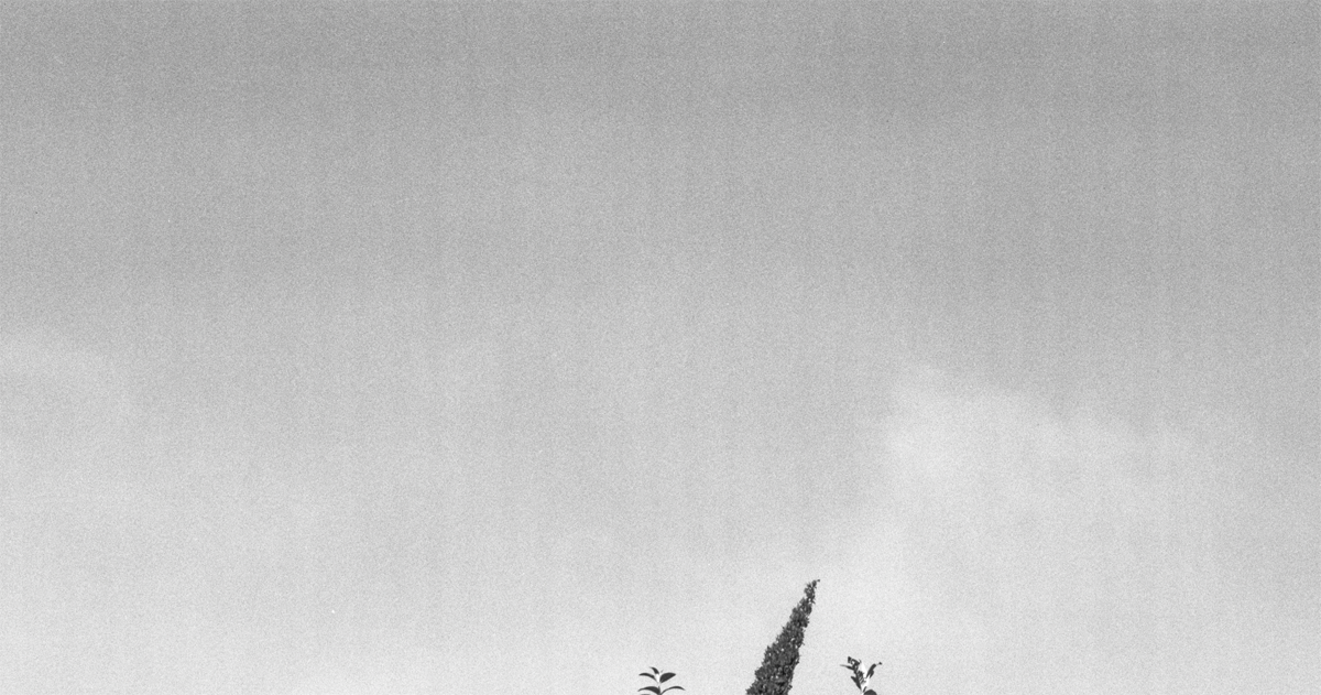

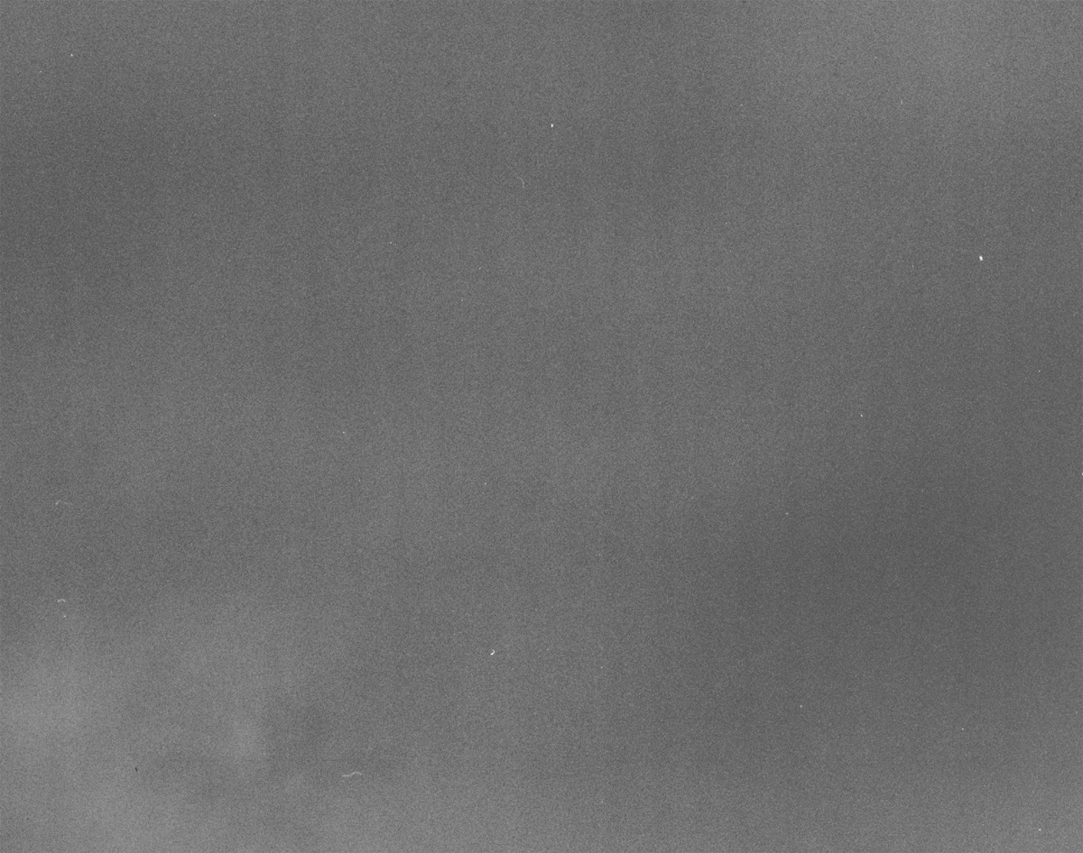

The banding is faint but easily seen, with parallel lines running down short edge of all of my 8x10” test sheets. All four of them, all developed independently in trays. I'm 100% certain it's not a developing fault as I also developed 20 sheets of HP5+ with the same Pyrocat batch over three days, none of which have any fault whatsoever. I then wondered if it was a scanner problem, but only the Bergger shows the problem within a run where I scanned 20+ negatives. I haven't had time to examine the negatives closely yet, but assume under magnification the banding will be seen; I've never seen this fault in any of the thousands of scans I've done with my V800. Highly textured, detailed areas don't show the fault up, which is perhaps why I haven't noticed it until now.
Could this simply be a coating fault? Doesn’t seem like x-ray damage as looks too consistent and straight, with more abrupt edges to the bands.
This film does claim to have a special base anti-hilation layer that gives a higher than usual (compared to competition) base density. Could it be a problem with this special layer, with coating problem emphasised by pyro stain?
Anyone else seen this on Pancro or any other film?

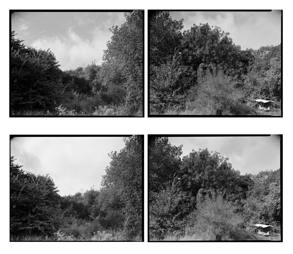

Scan thumbs attached: One diptych image (both Pancro and both exhibiting the same problem, with a crop from the sky on left frame (contrast increased to make it more immediately noticeable.)
Any ideas?

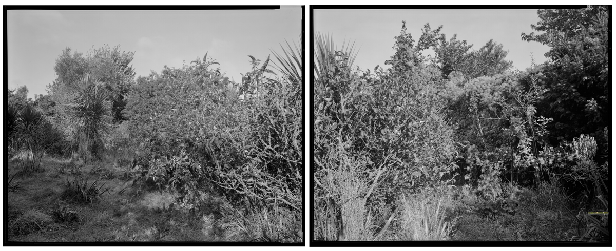

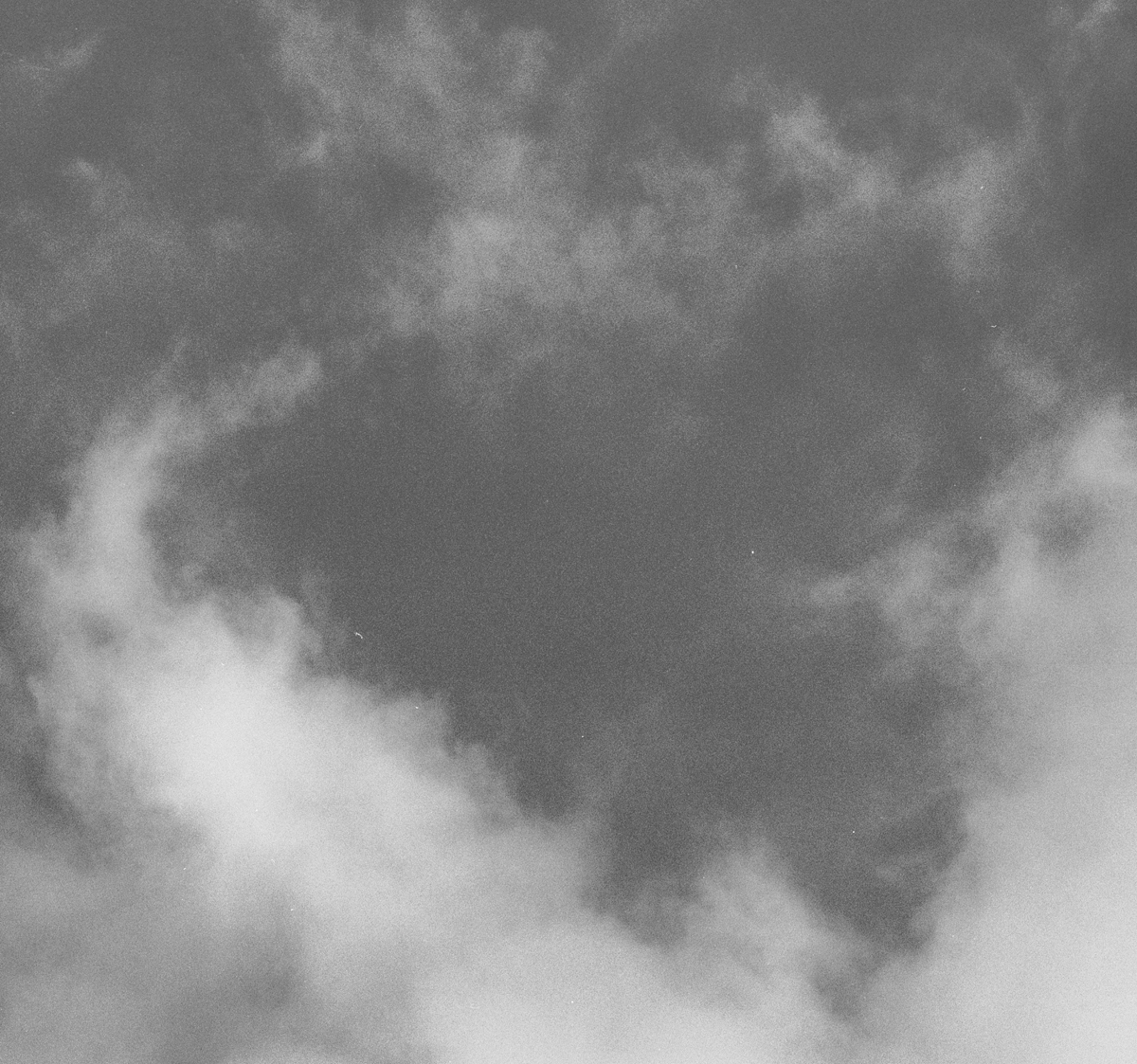

Attached here is another example test, made only to see how the different films render. Top diptych is HP5+ in Pyrocat-HD, 1:1:100 @20 degrees C. for 14 mins. Bottom diptych is Pancro in Pyrocat-HD @20 degrees C. for 18 mins. It's underdeveloped unfortunately as I guessed the Pyrocat-HD time off the PMK times compared to HP5+ (Bergger later supplied correct times.) Regardless, it still displays the fault quite clearly.
Crops have much heightened contrast to emphasise the fault (HP5+ sheets are perfect, save for some of the usual surge marks from tray processing.) Pancro again has the banding.

Update: have checked the negatives under magnification on lightbox and it’s definitely on the film, so NOT a scanning fault.
