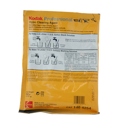

Nancy, the easy way is to just use Kodak HCA at stock strength, i.e. undiluted. Rinse off the brown toner from the print for about 30 seconds, then place it into the HCA bath. Occasionally rotate prints and/or agitate the tray as you stack more into it. Don't tone to where you think it should be - tone to before that. After all prints are done and sitting in HCA, wash them for 10 minutes. If you're using Viradon, don't even think of mixing the toning working solution without distilled water or you'll have calcitic deposits left on your prints which means you'll just have to wash them again later.
Kodak is not discontinuing the 1 gallon packets, they're discontinuing the packets that make 1 gallon of working solution - not stock solution. The packet you want is the standard "makes 5 gallons of working solution" or "makes 1 gallon of stock solution" packet. You store the HCA in stock form and mix it 1:4. You wouldn't want to store it as a working solution anyways as it doesn't keep. This size is very convenient because it's a simple 100ml + 400ml water for 2 rolls of film or straight for a sulphide neutralizer. An even cheaper option is to just buy powder sodium sulfite from PF.
