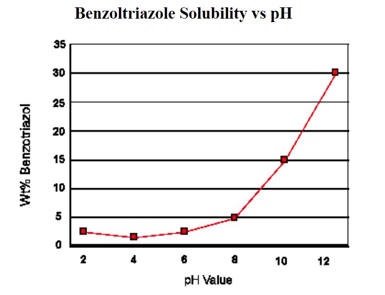

You can't make more than a 1-2% benzo solution in water.
I corrected my previous post. Thanks, Koraks and Don. I had just walked in from mixing developer in the darkroom using 2g of restrainer, and somehow inadvertently had 2 something or other stuck in my head.
But more will dissolve in alkaline solution. This graph copied from a website of a company that supplies it for industrial purposes (name forgotten, sorry)
You could use one of the ingredients of your developer to make the stock solution alkaline.

It use e.g. ethanol instead of water to dissolve the BTZ in. A very concentrated stock can be made this way. I'm not sure how it would be useful, but it could be done.

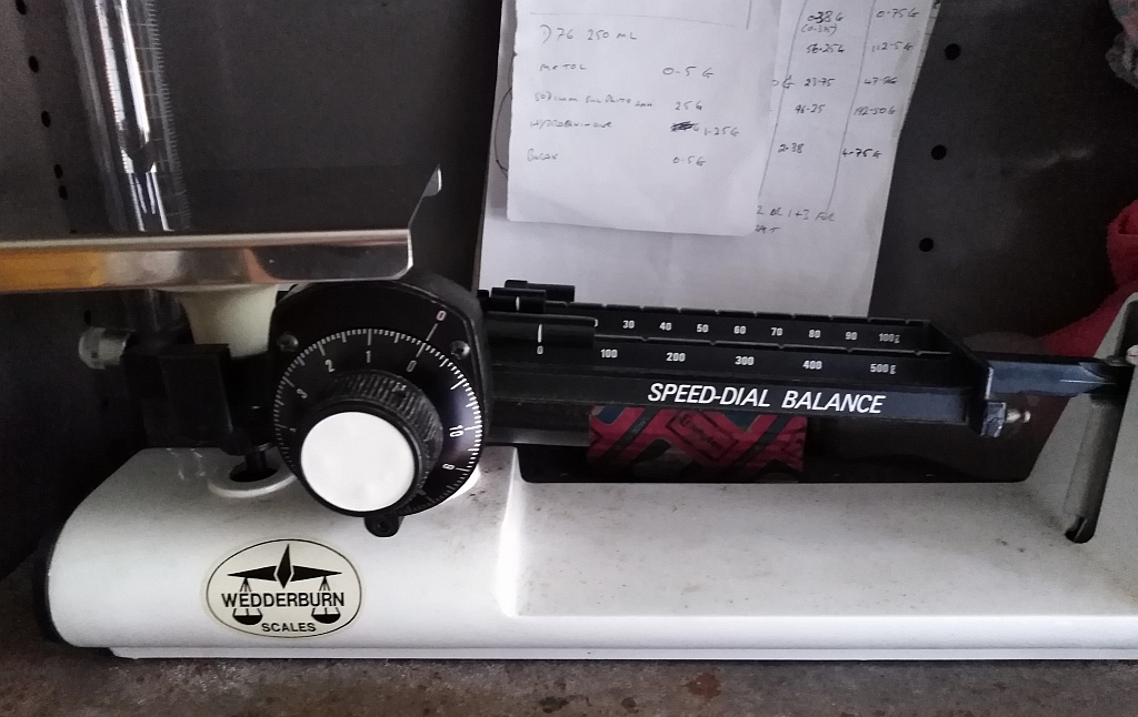

I recently pulled my triple beam Ohaus copy apart for a service on the Speed Dial on my Speed Dial Balance. After 30+ years of hard work, used every day multiple times in a work environment for close to 20 years as well as after hours measuring my photochemistry, the knob wouldn't rotate easily and eventually started to seize up.
Pulling the whole shebang apart I found large mudguard washers and small gunshot like pellets. After cleaning everything I reassembled but didn't add the pellets, thinking they were an oversight in the factory. Nope, they were needed.
Yeah, I guess they didn't even try to balance the material mass on either side of the fulcrum. The washers get it close and the pellets zero it out. I have one I got for $2 that was missing the zeroing knob and the dish was bent. I took the dish off to straighten it and that's when I saw the washers and pellets. I tossed enough pennies in there to make it zero without the knob.
