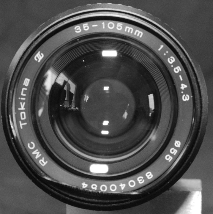

I have a zoom lens to present to all of you that was posted for free on this website. It has a hard lifted bend in its filter ring. Can a filter ring wrench successfully fix this?

If that is a damaged filter ring I would clip it with some side cutters and then "roll" it out with some needle nose pliers. If you try and twist it out you may damage the threads on the lens. This was my method for years when I was working in a camera store.

There are tools designed to restore moderate filter thread damage. However, I've improvised substitutes for such tools for occasional restoration of less severe damage. In a piece of wood cut a concave support that fits the lens outside of the filter thread in an undamaged part. Curve one end of a thin piece of hardwood to fit the filter threads. Sharpen this end so the wood reaches the bottom of the threads. With the damaged area of the lens supported in the concave section of the large tool, seat the curved end of the second tool in the bottom of the damaged thread and hammer the other end to gradually straighten the threads. It helps to have a third hand while doing this. Probably alternately working from each end of the damaged area is better than starting in the center, especially with that much damage. A cruder quick fix is to remove the glass from an old filter, and file or grind the male threads of this filter ring down to their roots. Cut away a section of these mutilated threads in a section as long as the damaged area of the lens. Glue this filter ring onto the lens. A semi-permanent glue is advised, so you can later do the repair right, if desired.

Jim recommends something that I tried and it did not work for me. Be ready to have a repairman replace the ring.

I'll second rcphoto's recommendation as the simplest, quickest way out. Cut the bent part away. I was given a nice lens with about 1/4 of the threads smashed in. Took a Dremel and ground it all away. A filter isn't under a lot of pressure, so 2/3 or so of threads left is more than enough to keep the filter in place.
Of course this ruins any collector value...
Or usefulness for screw in filters.

I had interpreted this as a damaged filter ring (the OP was asking if a filter wrench would help). If it's a damaged barrel then my suggestion is irrelevant.
No, actually, if you cut away a section of the filter threading to eliminate the area bent, the rest of the filter threads that are still in the right shape will hold a filter. Threads don't care if there are matching threads for all 360 degrees of the circumference. As long as there is no interference, the threads just mate. You simply need enough threading to keep the overall filter in a proper orientation. I bet you could create three small tabs of 10 degrees each at 120 degree points on the outer ring and have a filter work just fine. Until one of the tbs gets bent or such.
Well, you might need to clean entrance and exit points on threads after grinding them down. A simple thing to do.
Of course this is all McGyver hacking. When you worship pretty boy Hassy chrome, such talk of mine is blasphemy.

Those filter "wrenches" don't work. They put the same amount of pressure on the opposite side -- and press it outward to the same degree as the side you are trying to fix. You just end up with TWO dents.

I have fixed many dents like that with a good old
"church key" type can opener. I use a lot of padding and bend a little at a time. When I get close to a normal shape I screw a filter on and off until it can go on easily.
I agree! Save your money and don't buy these so called filter ring tools. The way to fix filter ring dents (and yours is not too bad, it can be straightened out and filters installed) is with a form to fit the curve of the ring and a wooden forming tool with also the same curvature of the lens ring. This is trivial for a repair shop to fix and if you want to do it on your own, you can make a form out of wood. If you want details on what the tool looks like to make your own, go to my webpage and I have a link to my Instagram posts-I did an illustrated post on this issue about two months ago.

I fixed a bad dent on a P67 lens using a concave wooden form against the barrel and a matching convex one to press on the dent. Used a vise to slowly bring pressure. I don't recommend using a hammer! I tried and it didn't work, plus the shocks could upset the optics. In my case the reshaped metal got a tiny fatigue crack at the fold but filter usage was restored.

And you don't have to get the repair PERFECT. Just good enough to screw-in/force-in a UV filter. Then additional filters will fit fine.

If you repair this will you use a filter? I would use it as is.

The filter wrench works just fine. Just need to go slow, a little at a time, and start at the ends of the bend and work it out slowly. There's always a chance with a dent like yours that the lip will break. In that case do as others have said and just cut that section out. Then take a cheap filter that isn't any good (scratches in he glass usually) and remove the glass. A little super glue, thread the new filter minus glass onto the lens. You know have a new lens barrel with 100% filter thread. If you care about looks when the new filter ring is installed you can put a little epoxy in the gap left by the missing lens thread and paint it black.
I have used this wooden-curved-support method with good results. On the inside of the thread, I tap a wooden dowel with a rounded end with a hammer, starting at the end of the dent and working toward the middle. For this severe dent, you should make several end-to-middle passes, with each pass straightening the dent a little.
Go v-e-r-y s-l--o---w----l-----y
No they don't cause two dents. They apply pressure spread evenly around the arc on the opposite side (fewer foot pounds of force across the whole area), but put point pressure (more foot pounds of force) on the dent, while ever there is a high point in the dented area that is what will have most pressure applied to it. Of course you need to stop when the dent is out, but I guess somebody with the mechanical sympathy of a gorilla may carry on winding and then cause two outward dents, who knows? As far as the OP's dent is concerned it's probably easy to make it round again, but the threads will still be distorted.

Thanks for your help. I decided not to take this project on since I have no logical need for the lens. I could of had it for the price of shipping, but I have too many unuseable "bargain" lenses as it is..
