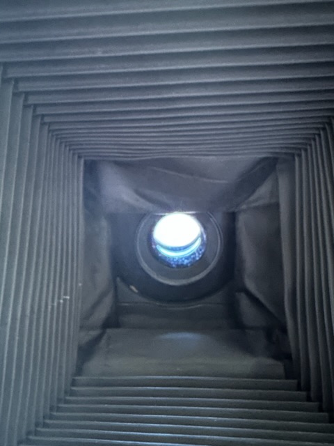

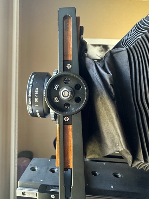

Alright, here are a couple pics. I’m getting vignetting with the minimal amount of tilt shown in the first picture.

Jimi,
Those are the universal bellows. That floppy part in front is the bag section. Just position it so it doesn't fall down behind the lens. If you need, use tape to mount a D-ring on the top of the bag bellows so you can pull on it from the outside, or just take off the camera back, as you have done, and push it out of the way. It's not supposed to be in the way like that.
By the way, that's not vignetting; it's simply blockage from the bellows.

Thanks guys! So it’s better when paying attention to the position of the bellows, and I’ll probably take the suggestion of mounting a d ring. But I’m still some what surprised at how little movement I get with the 150. It’s the Fujinon w 150 with 52mm threads, and tilt (when shooting portrait orientation) or swing (when shooting landscape) is very limited before corners start to go dark. My 90 seems to be giving more wiggle room.

Your bellows are crumpled, and need to be straightened. For the section you're having problems with, a D ring will be of limited use, because that section extends past the "cone" of your bellows. I'd start by removing the bellows from the camera (slider behind the front standard, two knurled discs on the side of the rear standard), getting all the creases / folds into the right position (so it looks like the image I posted) and lay it flat somewhere for a few days.
As for the lens, you appear to have the 150mm NW / EBC lens, which has a decent image circle of 224mm (at f/22)-- but keep in mind the bare minimum to cover 4x5 is 162mm. Your 90mm probably has about 238mm.
If you're wondering where I'm getting these numbers from, see http://www.subclub.org/fujinon/byfl.htm
