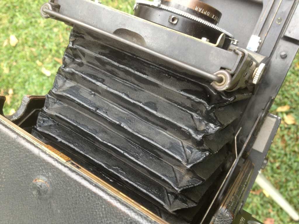

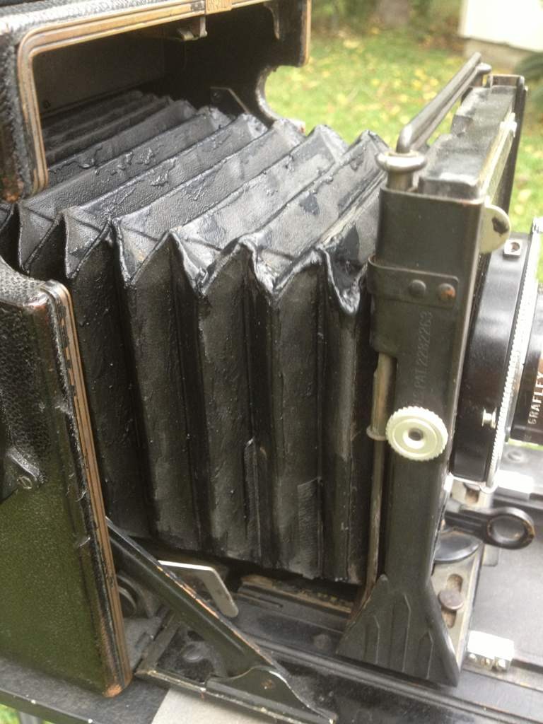

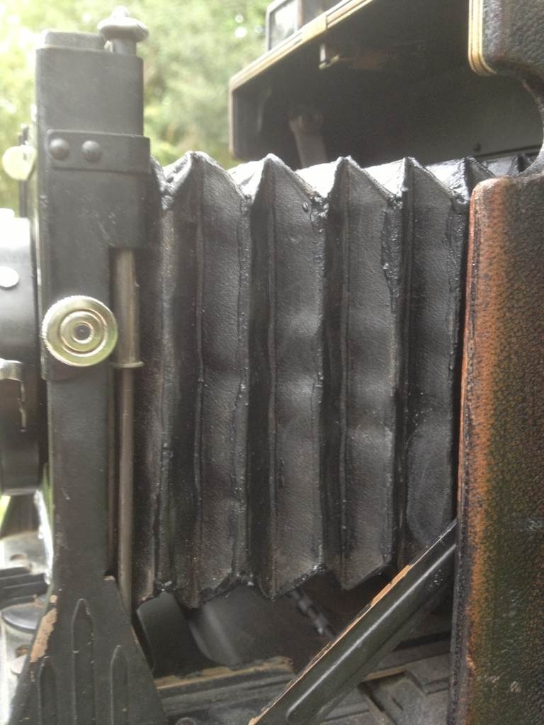

Thanks to jnanian, I was able to patch the pinholes on my Anniversary model Speed Graphic. There weren't any gaping holes, but on the folds, cracks, and corners, the outer covering has pulled away from the fabric. When using a flashlight it was like shining a light through a cheesecloth nearly.
I used Sobo brand PVA glue, and mixed it with black India ink. Sobo glue dries flexible so I'm hoping this will give me at least a few months of use in order to save up for a full camera refurb.
Its ugly, but it worked.
