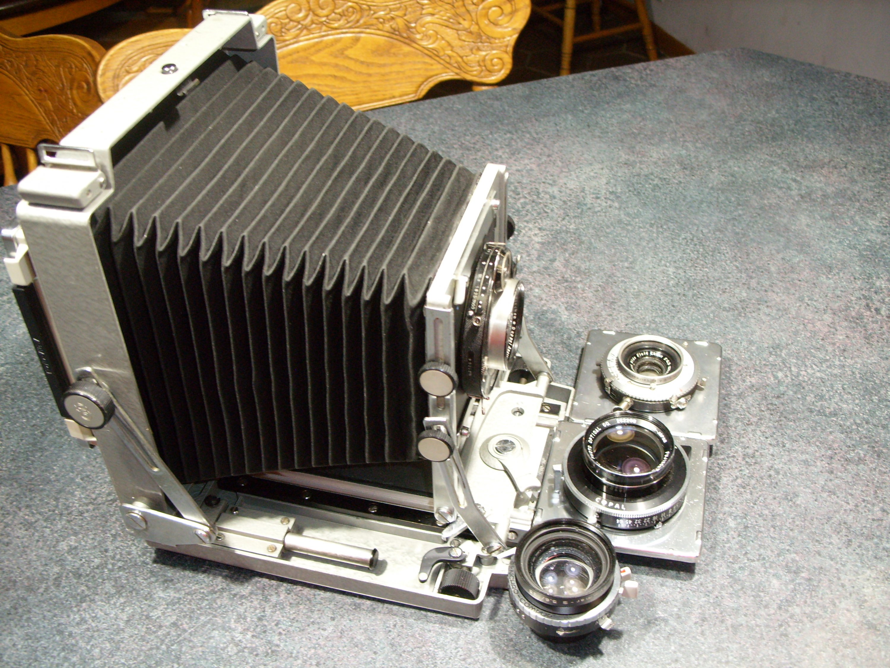

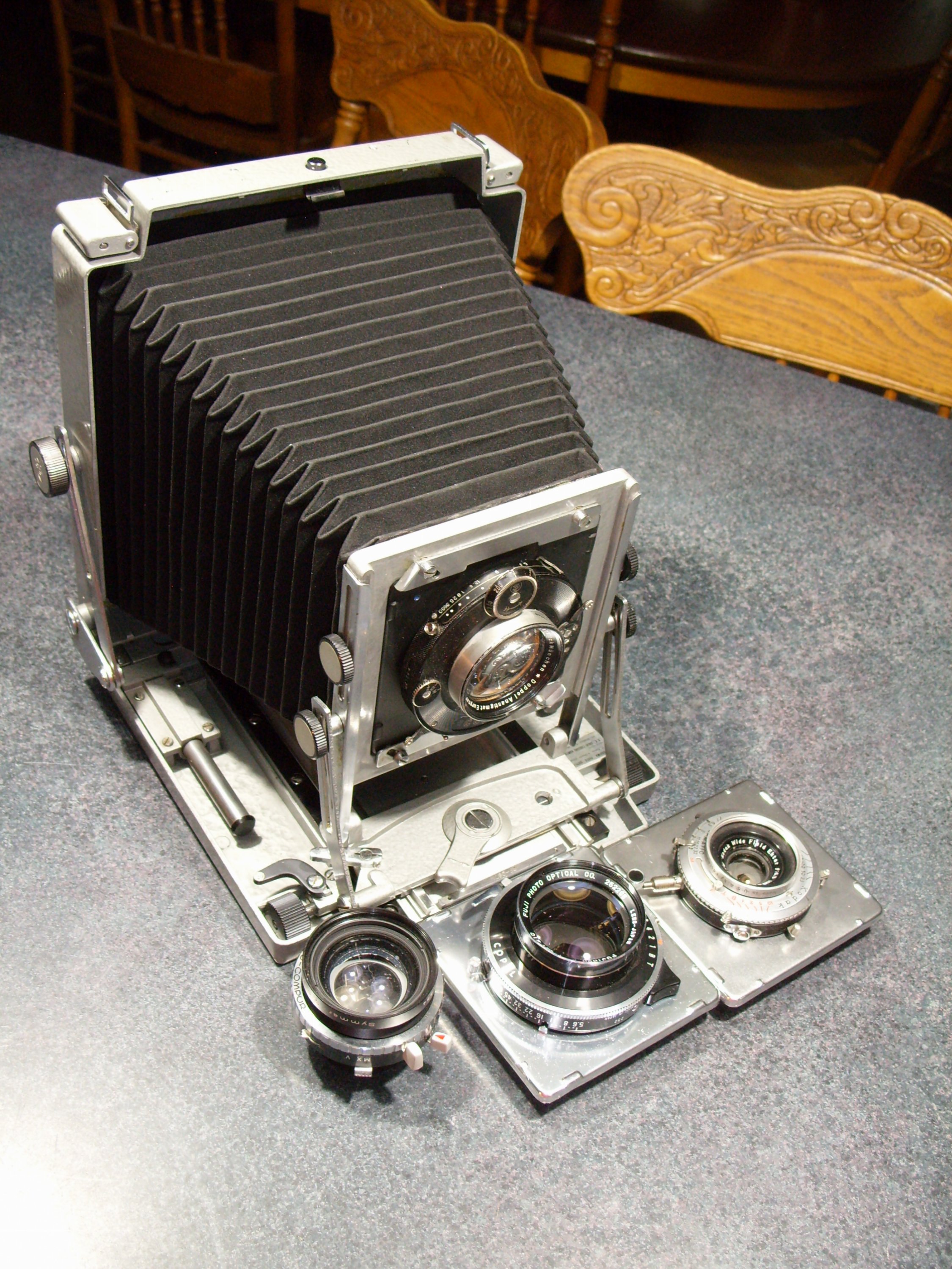

TOYO FIELD 4 3/4 x 6 1/2 folding metal camera.
I'm in need of a new bellows for this camera and was wondering if anyone has any experience with the bellow makers/suppliers that advertise replacement bellows on eBay. Or any other bellows maker for that matter! John

Yes, the bellows material can't be to thick or the bellows will not fold enough to close properly. It also has to have enough pleats/folds and length or you will have a hard time using swings and tilts.

I bought a set from eBay seller tokyophoto that I was very happy with. The material was advertised as being a gore-tex type of weatherproof fabric and was nicely flexible. Camera folded up perfectly.
I don't see any in their store right now but it would be worth asking as they sell a lot of those particular cameras and accessories.
IIRC they don't use frames so need to be glued on both sides. I used pliobond and it worked great.

Yes, I've already contacted them and am waiting for a reply. I have my old bellows off and I'm just waiting to order a new one. According to there description on eBay they supply the glue for gluing to the front and rear standards. I sure am happy to see your reply Adelorenzo about it folding fine.

Update! The bellows is installed and ready to go. The new bellows is a bit thicker than the old one and I was worried it might not close or at least not stay closed, but it seems to work just fine. I'd say by the looks of the material used that this bellows will outlast me.
