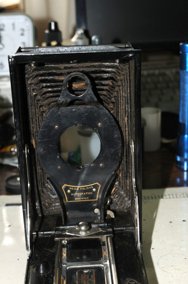

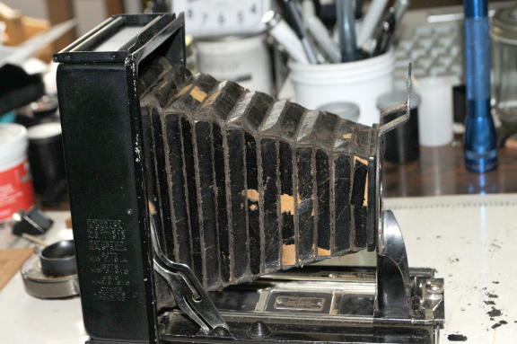

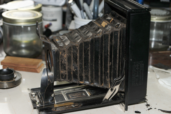

I have a #2C Folding Autographic Brownie. I found a Kodak catalog from 1917 saying it has intimation leather covering and a leather bellows.
The bellows lining is in very good condition. The leather is very thin, dried and flaked off in many places.
Finding leather that thin will likely be impossible or very expensive. I'm considering painting the exterior with Golden Fluid Body #1040 carbon black paint. Replacing or making a new bellows is out of the question as they are riveted to the front standard.
How would you fix the bellows to make them light tight?

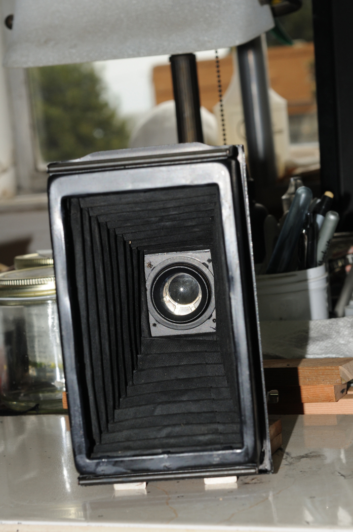

A piece of the leather that fell off measures .010 inch thick.
On larger cameras I have glued bellows cloth to the inside of the bellows to make them light tight and treated the dried leather with neatsfoot oil to soften them but on a folder such as this it would likely make them too thick to close the camera.
This is the base camera with the meniscus lens.
I have had good luck with the Golden Heavy Body acrylic artist paint recoating shutter curtains in Graflex cameras.
I'll let the new owner replace the bellows if they care to do so.

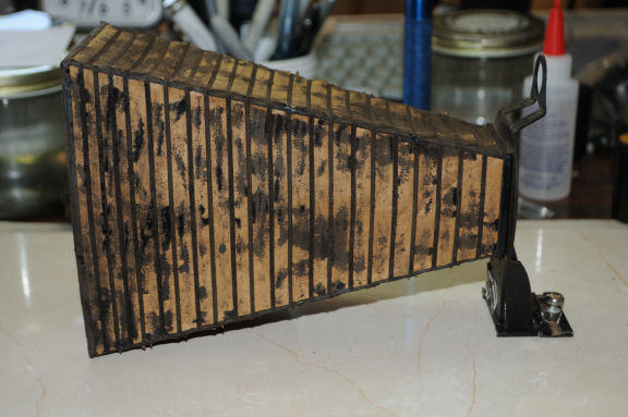

The comments thus far in this thread has helped determine a course of repair action, thank you.

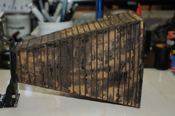

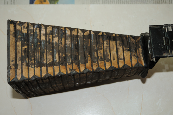

I consider this bellows repairable for the following reason, the inner cloth is sturdy and not torn and the pleat stiffeners are in very good shape making the bellows solid as factory fresh but with a bad outer covering.
If the inner cloth was bad I would trash the bellows/camera as the inner cloth is the foundation of the bellows. 2 of 3 layers good = repair; 2 of 3 layers bad = trash or replace.
The bellows removed from the body and stripped of the bad outer covering.

1st I cut strips of wood to just fit between the front standard frame and the rear frame which stretch the bellows to their limit.
2nd. stripped the old outer covering which was brittle leather.
3rd. made a template from printer paper, one side of the bellows at a time then taped the pieces together then tested the pattern for fit on the bellows.
4th. I selected the sports nylon I had on hand, rip stop nylon would be better as its a tighter weave. I used straight pins to attach the pattern to the nylon then cut the nylon according to the pattern.
5th. I painted the new cover with Golden Fluid Acrylic Artist paint diluted with water 1:2 to fill the spaces in the nylon.
6th. Using DAP Weldwood Nonflammable Contact cement (latex based, cleans with water when wet, rubs off easily when dry) I coated one side of the bellows and the inside section of the replacement cover, laid the cover in place and pressed down and allowed to cure for 5 to 15 minutes.
7th. After drying for 12 to 14 hours (overnight) I folded the bellows according to the original pattern and weighted down folded.
8th. After 10 to 12 hours folded with weight I painted the bellows with the Golden Artist paint in three more coats with the last mixed 1:1.

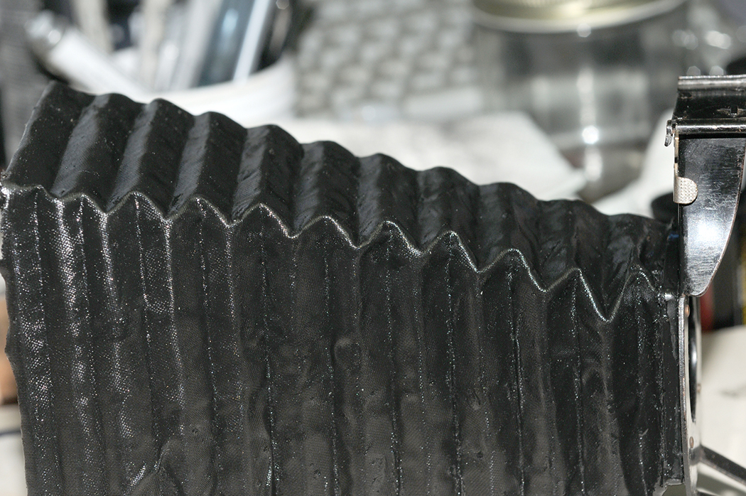

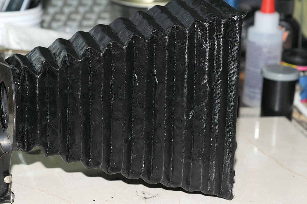

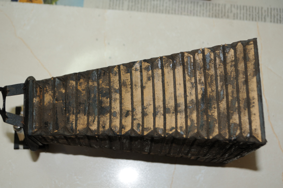

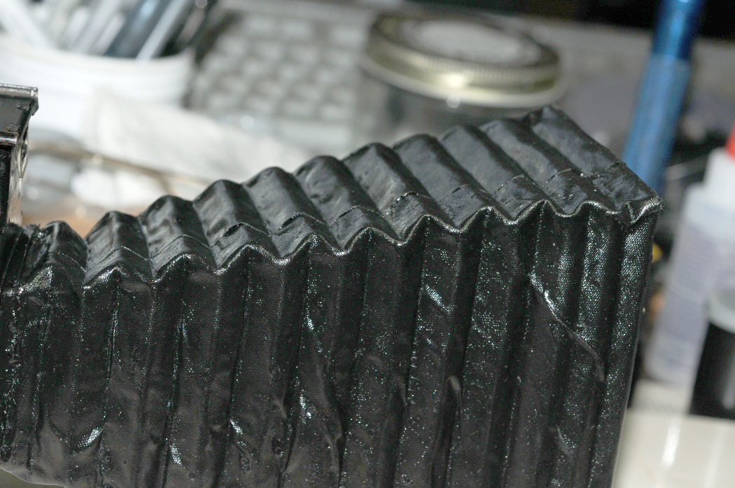

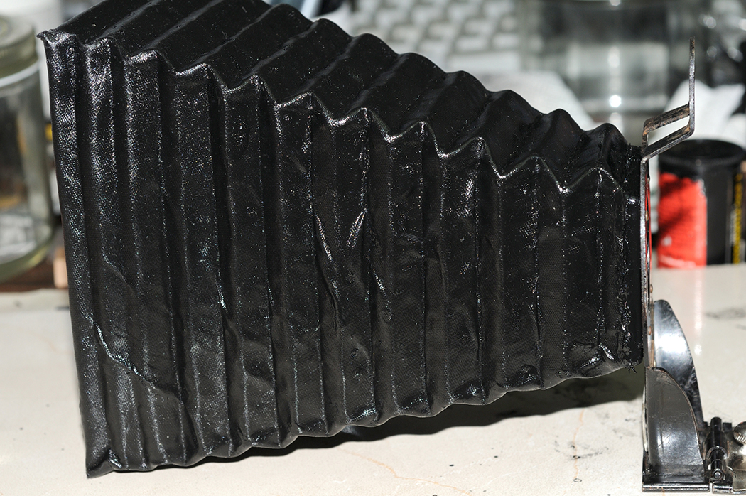

Pictures of the now light tight bellows ready for installation into the body.
Yes, there are some wrinkles likely from the nylon stretching in handling

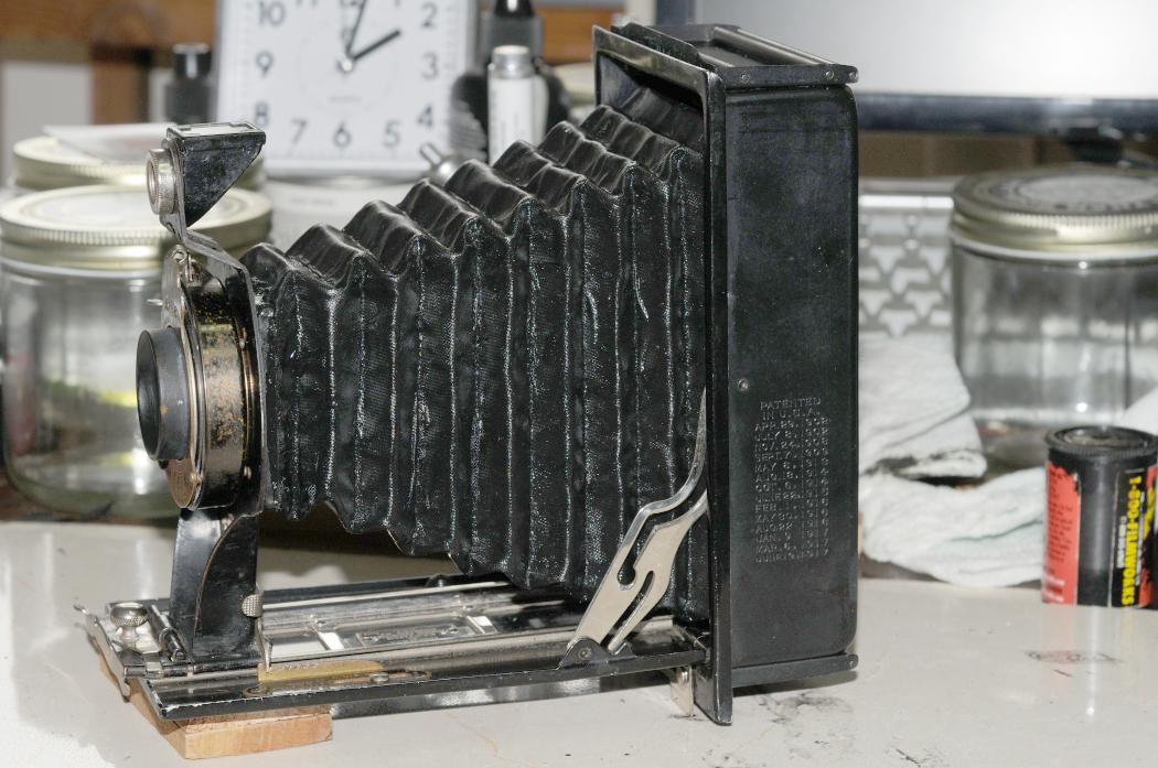

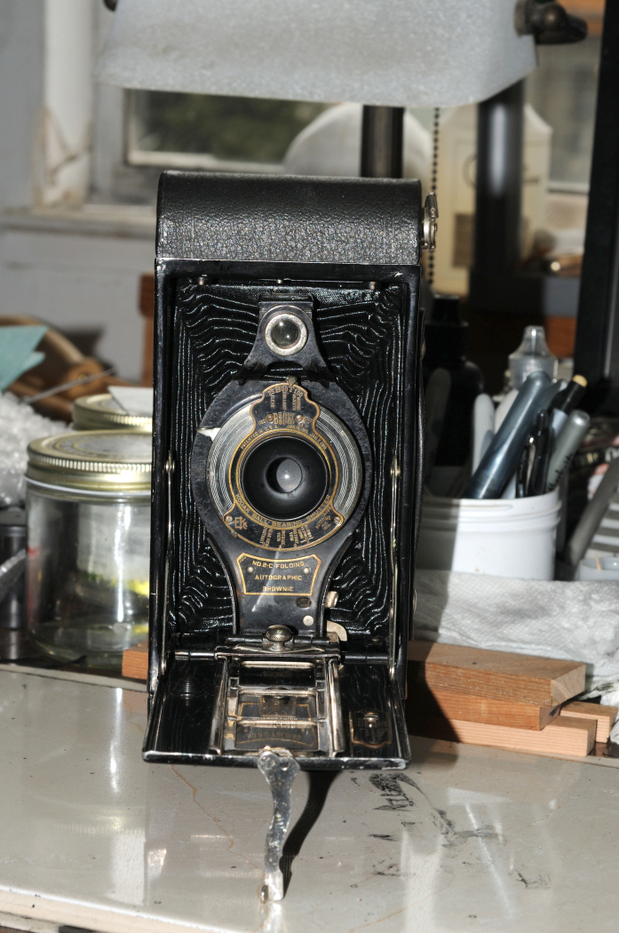

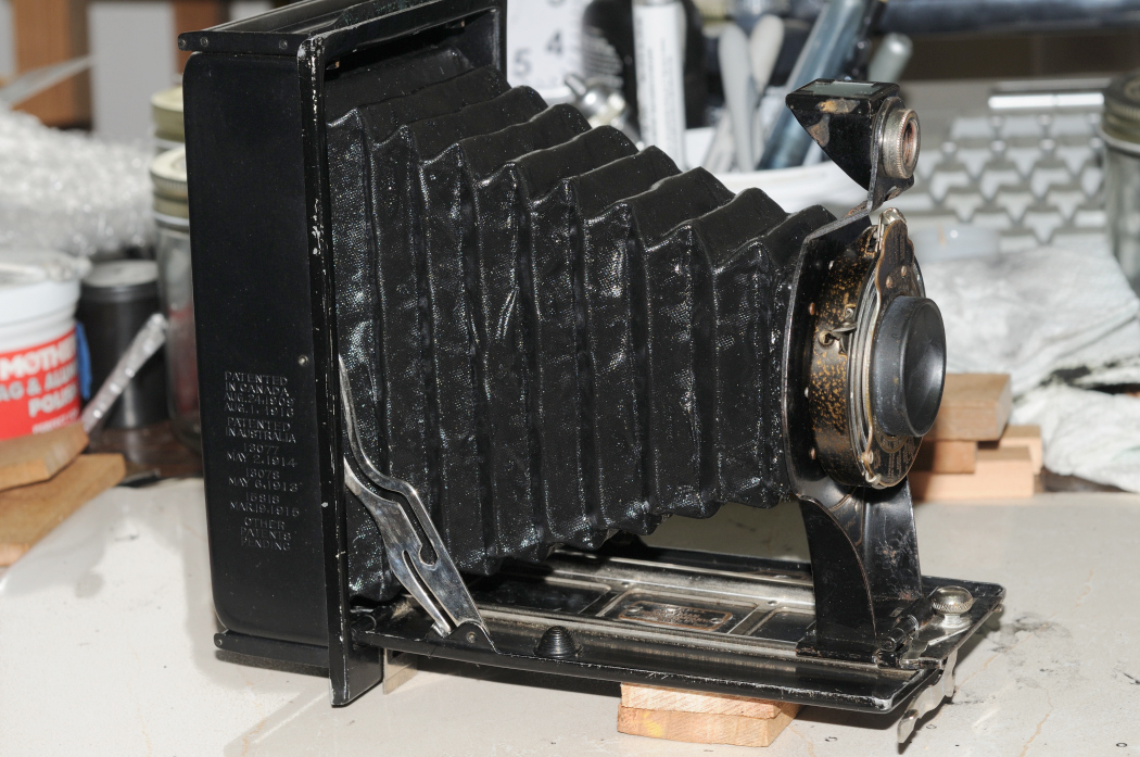

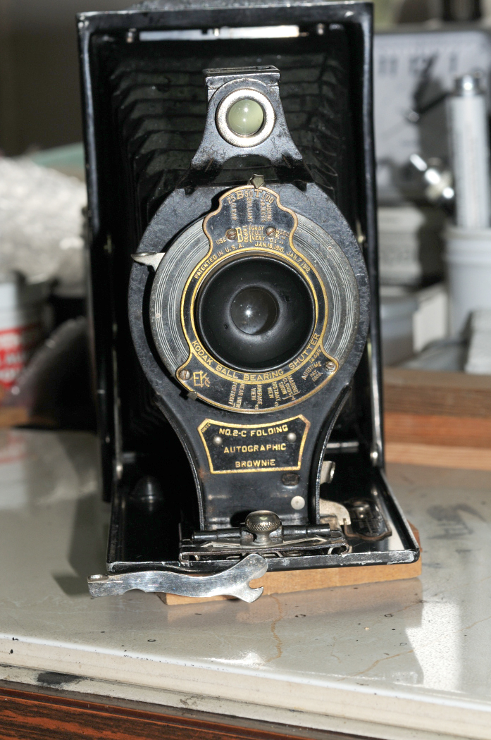

And here it is back together and ready for film
DSC_2848_00001.jpg DSC_2849_00002.jpg DSC_2850_00003.jpg DSC_2854_00007.jpg DSC_2856_00009.jpg
I still have to make a ruby window and 120 adapters before loading some film.
I need to find a better way to recrimp the rear frame, but its square and flush.
This is not a project I would take on for someone else. Being its mine I decided to try to get it usable.

If I wanted a new bellows I would have bought a NOS available on ebay or followed the instructions in my copy of National Camera Repair The Bellows.
I will make it available if anyone would like a copy.

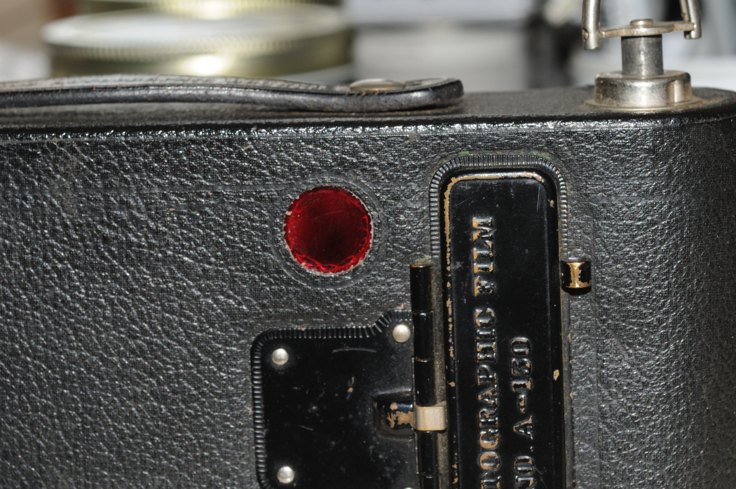

For the ruby window I have some deep red flash/studio light filter material and a 5/8 arch punch, the window hole is 1/2 inch.
I loosened the exterior leather, slid the filter material under it, then applied the latex contact cement. The excess cement rubbed off easily and the window hole is now covered.
