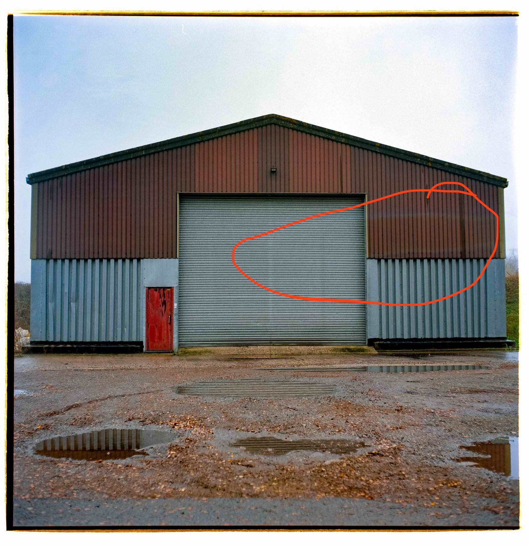

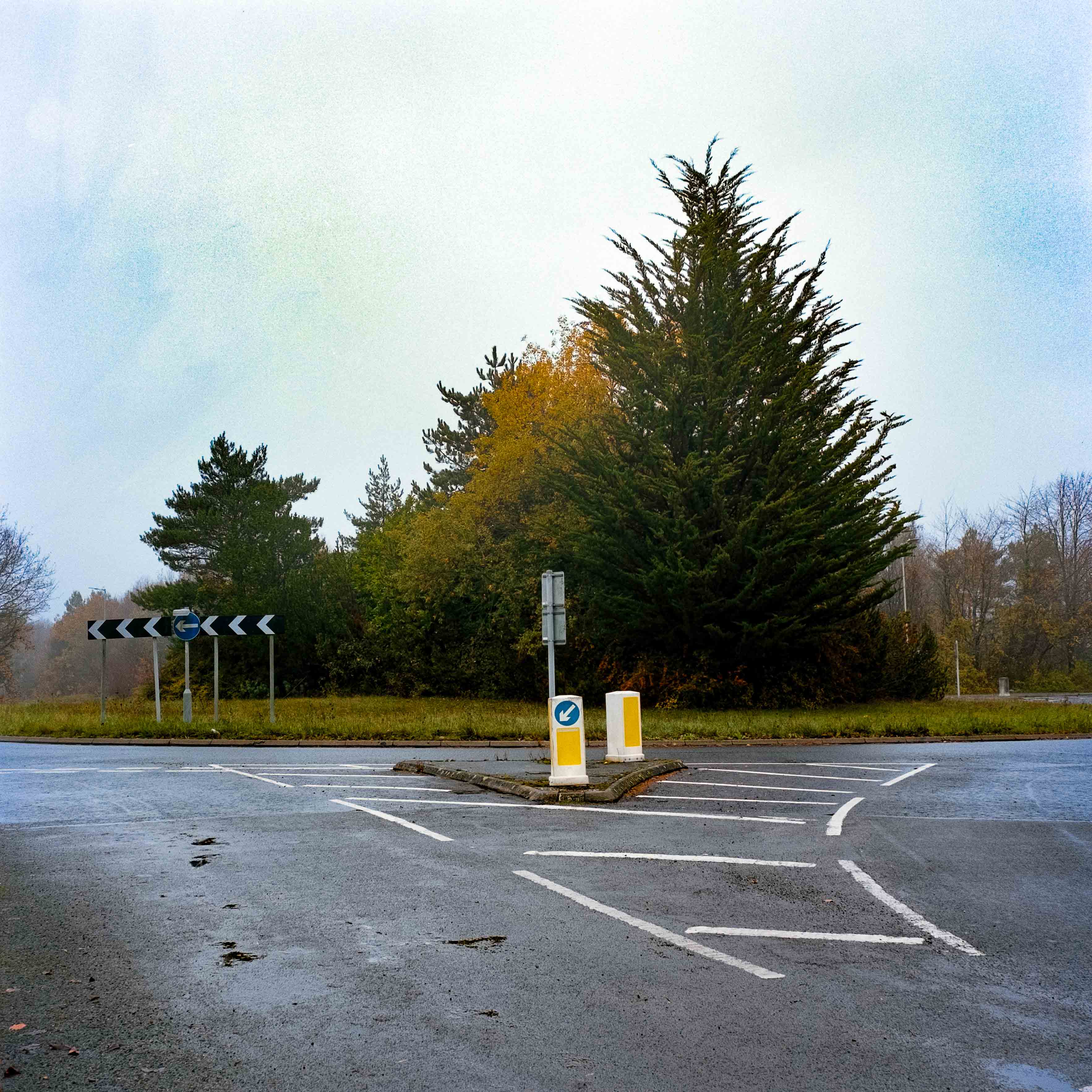

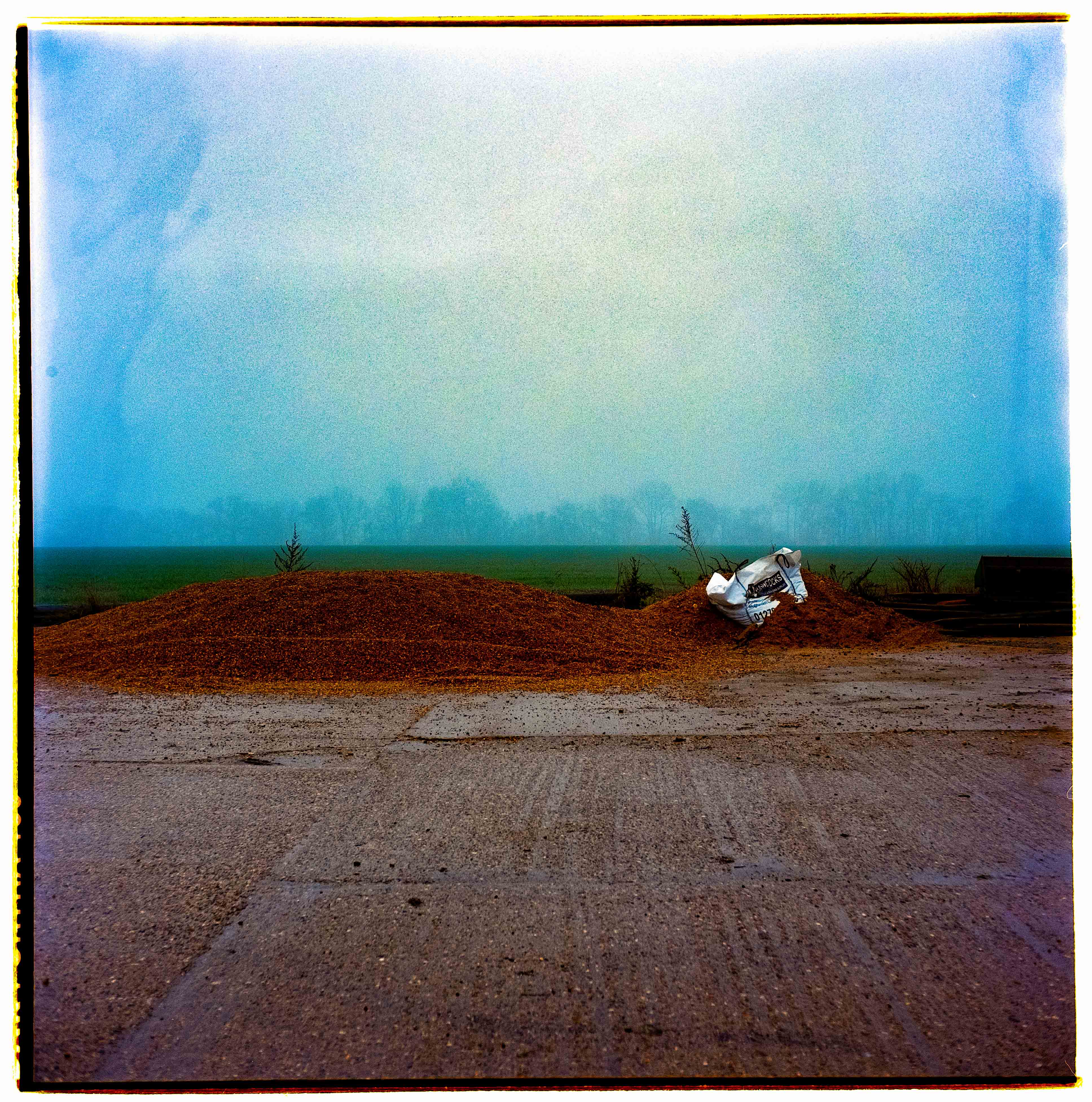

Hi, had this previously wondering if anyone had any ideas
Dev has had 4 films through it (mixed 9th November)
Bleach and fix had 12 films through ( mixed 11th October)
All films developed previously have been perfect, these are over two rolls shot on a slightly misty morning. I have used dehaze to accentuate problem marks.
Process
Warm in dry tank 3:30
Dev 3:15 first four 3:30 5th film agitate 45 secs then 1 inversion every 15 secs
Bleach 2min constant ag
Wash 1:30
Fix 4min constant ag
Wash 6min
Stab 2min

The first thing that comes to mind is insufficient bleaching and/or fixing. Try to run the film through bleach and then fix again, say 8-10 minutes at room temperature for both, with agitation. Maybe it'd be a good idea to use a fresh fixer for this, too. If you don't have any fresh C41 fixer on hand, regular rapid B&W fixer will do OK too.

Cheers for the reply, I’ve got some Ilford rapid fixer around I could mix up
