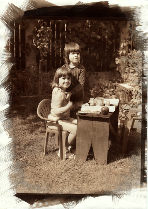

Here's one of my latest vandyke prints. Double coating by brush, cleared in 1% citric acid for six minutes (two baths of three minutes each), fixed in 2% sodium thiosulfate for five minutes, toned in selenium 1+200 for three minutes, hypo-cleared in 2% sodium sulfite for five minutes. The paper is Fabriano Academia. 8x10" Kodak TXP developed in ABC.
