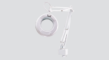

Get yourself a good magnifying lamp.One with a circular florescent bulb that doesn't cast shadows.I'll post a picture of mine in a bit.
Mike Kennedy
Feb 5, 2005
1,594
Eastern Cana
Magnifying Lamp
here's the one I use.Picked it up at my local office supply shop.
