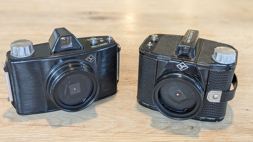

Click & Clack - easiest DIY pinhole cameras by Zheng, on Flickr
These are Agfa Click (6x6) and Clack (6x9) cameras that are probably the easiest to DIY convert to pinhole cameras.
- Agfa Click: 50mm focal length, f/250 (pinhole size 0.2mm)
- Agfa Clack: 75mm focal length, f/250 (pinhole size 0.3mm)
How to convert
1) Take out the entire lens and shutter assembly, 4 screws
2) Make a small round "lens board" from black plastic sheets, cut a whole in the middle
3) I used both home-made pinholes as well as commercially available pinholes from Reality So Subtle (France). Make sure the pinhole is centered
4) I use electrical tape to attach a 46mm->52mm step-up ring, so I can use 52mm lens cap as shutter. In addition, I can use 52mm filters.
Observations:
- Both conversions are very easy, only need screwdriver. And the entire process is reversible, or you can use the lens and shutter for other experiments.
- The Click has shorter focal distance, thus giving a more wide angle look. While the Clack is moderate wide - standard focal length.
- The Clack is better built, especially in terms of film handling and back security. And Clack has more style as well, with its pebble leather type of covering and side strap.
- The Click is more compact, lightweight, and travel friendly,
I like them both: these are my disposable pinhole cameras that can get rained on or lost.
Donald Qualls
Jan 19, 2005
12,126
North Carolina
I agree, I have a converted Clack (somewhere) that has produced very satisfying pinhole images. I'd point out, however, that 6x9 is not an economy format (either with lens or pinhole) -- eight frames per roll at what, $20 a roll for Kodak/Ilford films? Less for Foma or Kentmere, at least...
