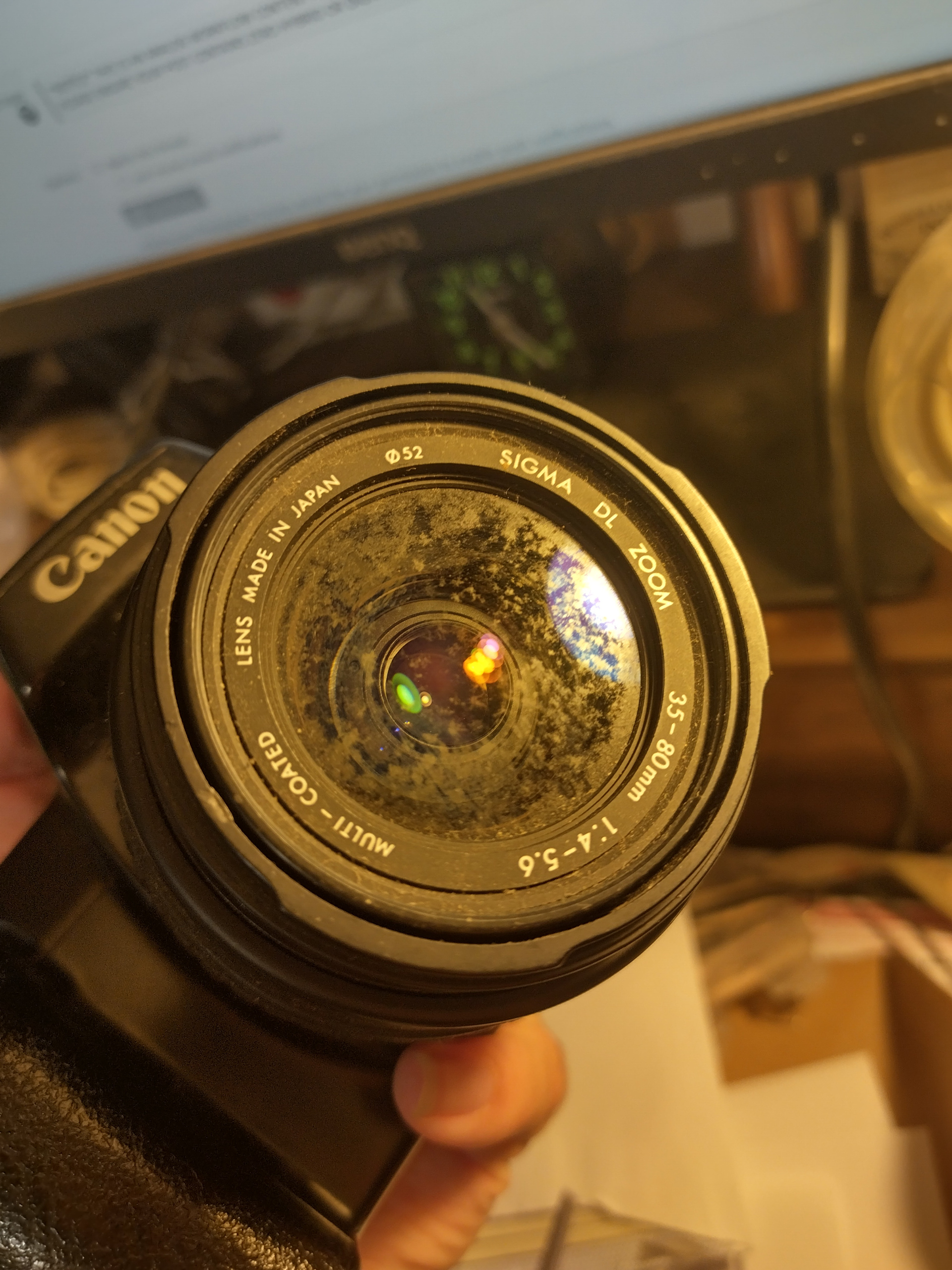

Hello,
My apologies for the beginner question but...
I was recently given a Canon EOS 1000f electronic SLR which belonged to my mother and has been sitting in her wardrobe for 18+ Years.
The lens is covered in something which looks to be grime of some sort, but could potentially be a very bad case of fungus. If it is, it looks quite different from the fungus I have seen online..
It appears to spread out but at the same time is more patchy than the pictures of fungus I am used to seeing.
I haven't needed to do much cleaning of lenses before as I haven't done much serious photography since I started in 2016. If standard cleaning fluid and a microfiber cloth or lenspen would work then great, otherwise does anyone have any ideas what I should do?
For now I am keeping isolated in a drawer with some silica gell packets to be on the safe side (is this the correct procedure for fungus?)
Thank you..

Probably just crud, but start with a cleaning. If it comes off, you're all set.
reddesert
Jul 22, 2019
2,405
SAZ
It looks more like fungus when the photo is enlarged and the blotches look more spiderwebby. Regardless, try wiping the lens with some lens cleaner or alcohol and a gentle cloth.
Before you get too far into this:
- Check the camera to make sure it didn't have batteries leaking and corroding the battery compartment.
- Remove lens from camera if you haven't already
- Silica gel is just for keeping the moisture down in storage. It won't stop or clear up existing fungus/damage. To stop the fungus, expose the lens to UV, like put it in the sun. However, if there is a lot of fungus, the damage from etched glass will remain.
- The lens (a Sigma 35-80 slow zoom) is sort of a bottom of the barrel kit lens anyway. Don't be afraid to give up on it. If the camera body is ok, get a clean lens like a Canon 50/1.8 (or 28-80 if you must have zoom) and have fun.
beemermark
Sep 21, 2008
869
You won't know based on internet guesses. Clean the lens, if it doesn't come off then it really doesn't matter what it is.
eli griggs
Nov 15, 2005
3,848
NC
Hydrogen Peroxide will remove the fungus 'tissue' but watch several different YouTube videos on using it to clean glass optics before trying anything.
I like Eclipse lens cleaner and PEC pads as part of my cleaning of lens glass and there are several videos about how to use them to do so.

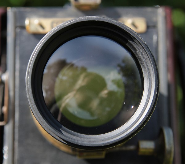

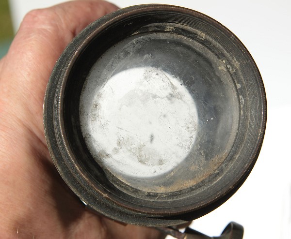

It's like asking is this fungus.
In fact the lens is in excellent optical condition :D
In this case it was years of grime, the lens had been stored in a barn.
My gut feeling looking at the grime on the lens barrel adjacent to the front element is it should easily clean off. That particular Sigma lens typically sells for £10 - £15 here in the UK.

eyrewiut
Jul 3, 2024
United Kingdom
Thank you very much for everyone's advice :D
I have done a little cleaning which appears to have cleared the surface but it looks like it may also be on the inside of the front lens element.
I may try a more fungus targeted solution but I'm not feeling inclined to go much further for this lens so I'll consider buying a better quality prime lens to replace it.
