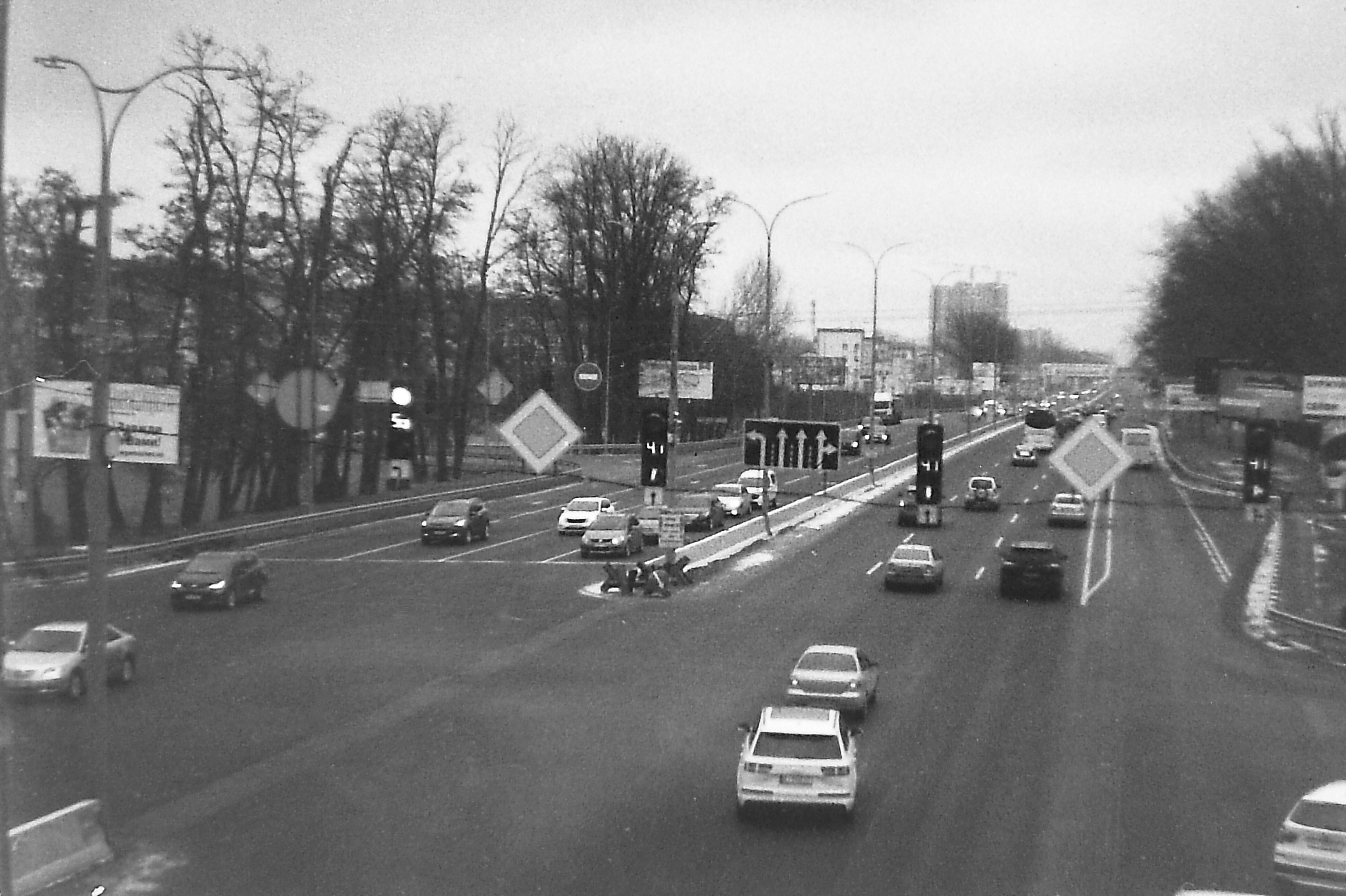

This is Svema-64 with an expiration date of 1992. I always develop expired film using the “3.14” method (I opened a separate topic on the forum on this method) and it has never let me down. The only time in my life when the method did not work was a few days ago when I started developing a modern one. fresh Svema 200

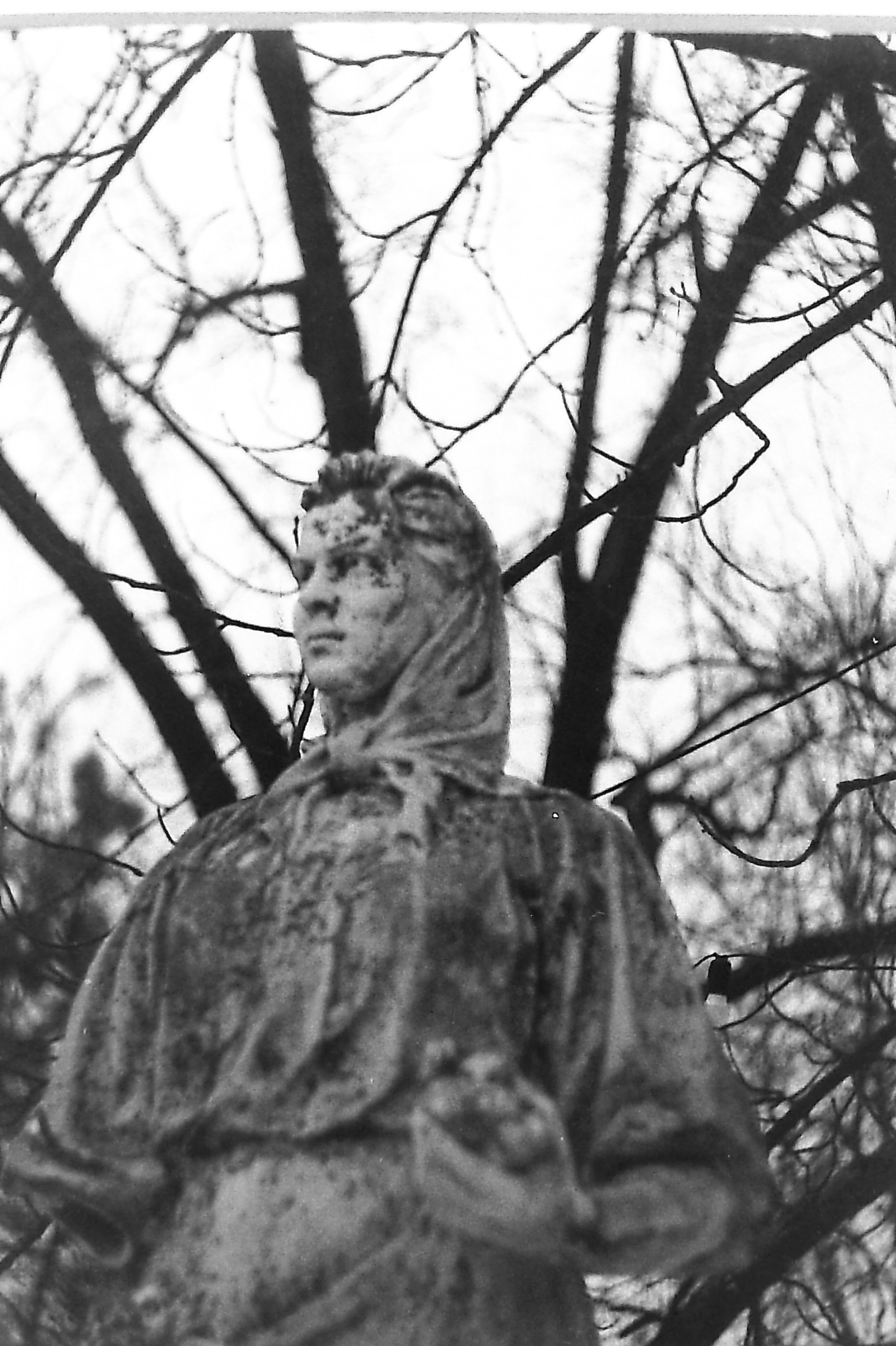

Yes, when developing expired films, I add a little, a few drops, to the developer. up to 0.5 ml benzotriazole. It was a very cloudy winter day. The developer is a microfen diluted 1:1 plus a little benzotriazole. Development time was about 20 minutes. I can’t even say approximately the temperature of the solution, it’s between +14+16C. I still can’t find the time to shoot the ORWO Chrome slide, but I hope I’ll find the time before winter. I will be very interested to see your results. PICT0002_1.jpg PICT0005_1.jpg PICT0003_1.jpg
