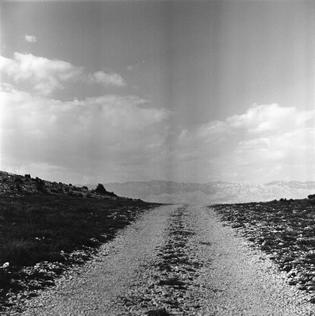

After almost a year that I was giving my negatives to a studio for development, I acquired what I needed for home processing. My First BW neg that was developed entirely by my hand. What a thrill and joy. But I made few mistakes. Some I recognized and fixed and for some I need your help. I got this vertical darker lines, uneven development, only on images that were in the middle of the film (in the middle of the tank too). Images on the edges were without lines. It is not a camera error.

1. 20ºC – 8 min sliding on table every 30 sec./ 5X, but as I was excited it is possible that it was with shorter intervals. Could it be that here is an error that made those vertical lines?

I think it may be your "agitation " method. Just sliding the tank on a table top my not be enough. Did the tank come with a stem that connects to the reel and allows you to gently twirl the reel during development. Actually, I think you would be better off finding a tank that allows inversion.

put all of the negative in the pic, including the edges and the other pictures that were ruined. It will be easier to make a determination then. It just may be that the film in the middle buckled and got closer to the neighboring film due to expansion and reel being a bit too tight. If the edges are not bothered, then that makes sense since the edges are fixed on the reel and do not move at all. Whenever there's less or more space for developer to get into or out of, there is a different development rate. However, much more can be determined by looking at the whole section of film strip.

That style of tank originally came with a thermometer/agitator that inserted in the top and engaged the reel. I used those type of tanks in the 60's when I first started out developing. I think you either need to find something to substitute for the thermo, or buy a new tank/reel set.
