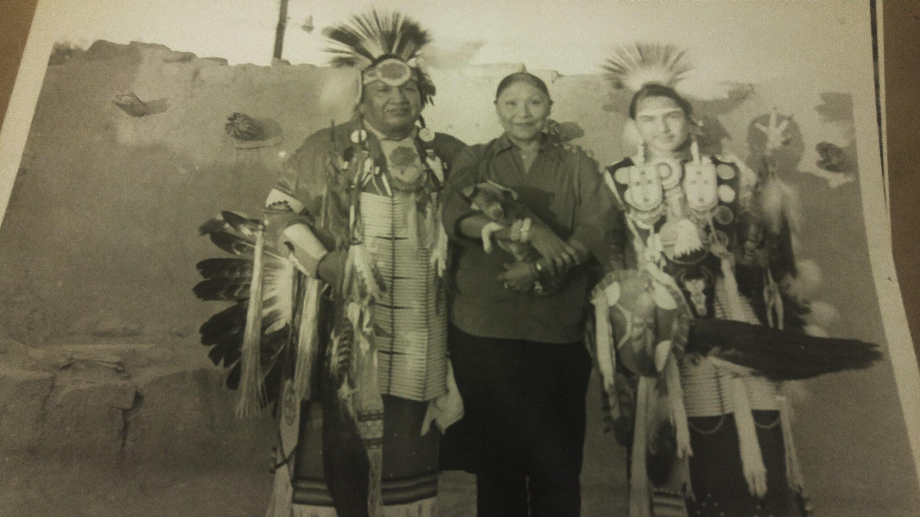

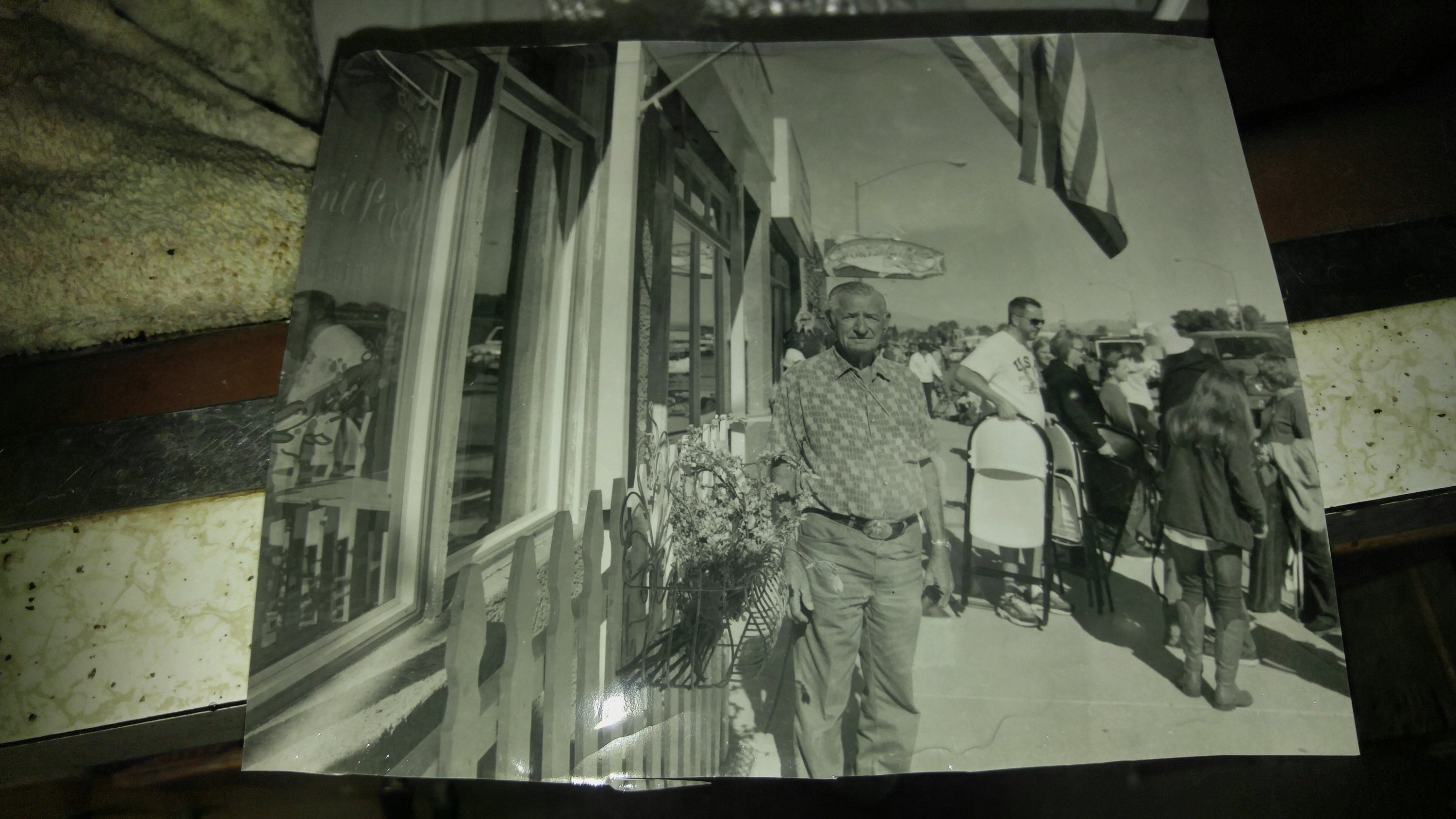

I am a begginer just starting out. Actually I set up a darkroom a few months ago and cannot seem to get a print to come out. Ive tried replacing various things such as my enlarger bulb I use an old omega dii. I replaced my chemicals and that didn't seem to help. I figured out I had my dektol dilution wrong which helped with developing time. However my prints are terrible and flat. The photo of my old friend is grey in real life I took a photo of it using my phone. I'm really at my wits end I've fine through a ton of paper. Anyone out there have any idea what I'm doing wrong and how to fix it?
Thanks Jesse

Yes. I'm using an ilford multi grade filter set. Arista rc vc paper. Safelight should be fine. I have it on a dimmer so I can keep it low
I was using the dektol diluted to 1:4 it seems to take about a minute-2 minutes to fully form the image.
How old is your paper? Also, your developer could be contaminated. What you should do is start out on your highest contrast setting or filter and see if that makes crisp whites for you. If it does, that's your correction. If not, I would look into your paper, developer, or possibly your negatives. If you have old paper, you can correct the problem by adding some benzotriazole into your developer. Also, are there any light leaks? And, "safelight" is somewhat of a misnomer. If you have your paper out for a while under safelight, your safelight could also be fogging your paper. Could you post a pic of your negs from the same print?
Honestly, it looks as though you are over exposing and pulling out of the developer too early. The print itself is quite dense.

Thanks for the advice. You have given me something to go on. I should try a new print develop a full 2 minutes at 1:2 instead of 1:4 my developer is brand new so is the paper. The safe light is a little Kodak i put on a dimmer I turn it down low enough so I can barely see when the paper is out. I used a #2 filter

hi dave123.
sorry to read you are having trouble
it looks to me ( guess ) like your developer is too weak and you aren't exposing enough, and you are leaving the print in the developer too long, and maybe you aren't agitating/rocking the tray .. all these things might lead to an image getting grey.
if i can suggest a few things ...
make your dektol 1:1, or 1:2, 1:4 seems a bit dilute ..
do a test strip, with no enlarger filter and have your lens stopped down 3 clicks from wide open.
have your test strip in the dektol filp it over 2 or 3 times to make sure it is fully submerged
then face UP and rock the tray for 1 fulll minute then in stop then in fix.
lights on, and look at it in room light, and pick the best exposure so the stripes in tne american flag, the folding chair and the window/door surrounds are WHITE with tone, make your exposure, and agitate again in the developer 1 full minute the same way, flip the print the same amount, face up, rock the tray.
stop/ fix and when it is in the water and rinsed, turn the lights on, and look at it in room light.
with some papers ( rc paper ), if the image comes up in about 15 seconds your exposure is close.
if the print is still grayish ( the flag, chair and door / wind surrounds aren't white ) then use a #3 filter and do the same thing, test strip, then 1 full minute agitating.
a #2 or 2 1/2 filter will make things LESS contrast, 3, 3 1/2 4, &c ADD contrast.
good luck !
john

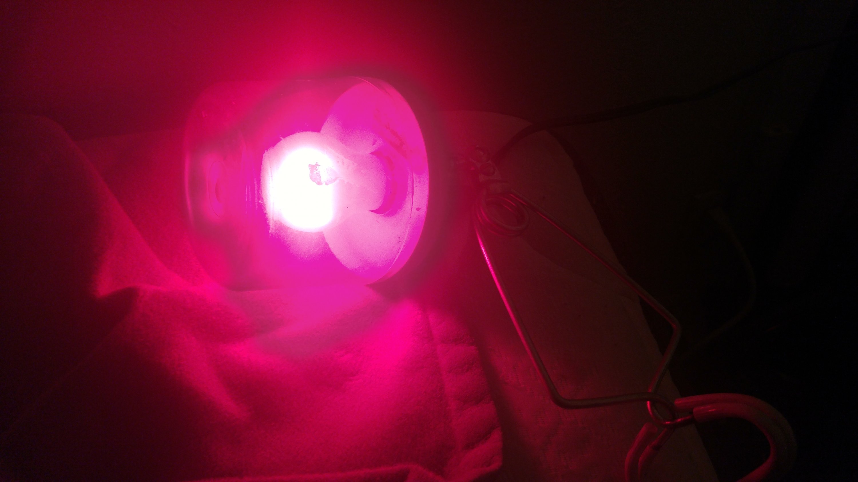

Here is my Safelight. It has a red 15 watt bulb in it with a dimmer.
I was using an orange Safelight fixture as you said it was blowing out my prints. Switched to this little one someone gave me

That appears to me to not be a safelight.
Although safelights aren't particularly powerful, it is their colour that matters the most. Safelights restrict the frequency of the light emitted to colours that the paper is not (very) sensitive to.
That appears to me to be just a mostly red bulb. Mostly, in that there is also a fair amount of blue (and possibly green) light there too.
The blue and green light fogs the paper.
If the color in that is similar to real life, I suspect it is the source of your trouble. A dark red safelight is a really deep dark red, a color where our eyes don't see as well and makes the darkroom seem a lot darker than an amber or OC or light red. Like looking through a #25 red filter if you have one of those.
If you do not wish to perform a standard exposure and development fog test using a coin, there is an even quicker and easier test you can try. It's not as accurate as a paper-based fog test since it only targets your safelight. But it is still capable of detecting potential problems. Others here are very familiar with this:
(1) Locate from your collection a normally recorded CD or DVD computer disc.
(2) Close up your darkroom as you normally would. Turn off all lights (even power strip LEDs), then turn on only your safelight.
(3) Observe the light coming from your safelight as it reflects from the recorded side of your CD/DVD. Up close or further away does not matter.
(4) Mostly you will see only the primary safelight color. But also look very carefully for any faint, but usually reasonably distinct, bands of blue and/or green color in the reflection. They can be relatively narrow, or quite broad. But they are almost always faint. Sometimes at the seeming limits of visibility.
If you see any blue and/or green, your safelight isn't. Whether those colors are causing fogging is another question because you weren't testing specifically for fogging. But they could be.
People who discover that their safelights are causing paper fogging are almost universally shocked and surprised. They can't believe the bright red (or brighter orange) they see could contain any other color. But the truth is, they almost always do. Too faint for you to see visually. But easily a problem for your paper over the time it's left out exposed.
If you suspect fogging, try this. Using fresh paper that has never been removed from its original packaging, make a fully processed test print normally under your regular safelight. Then simply turn off that safelight and make the exact same print in total darkness. Then compare the two.

Wow thanks for the information. The safe light issue never crossed my mind as it was given to me by an old photographer friend. I just assumed it was proper. I just ordered a correct one. It makes sense that my safe light was a problem since every print I made no matter what my variables were was flat. You guys have helped me more in two hours than anyone has in months. Keep the information flowing. What else should I know about the paper?
