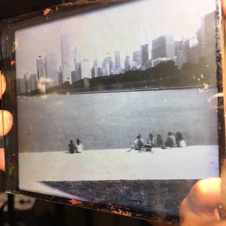

Regarding your question about sensitized plates - daguerreotypes tend to start to fog pretty fast, even in the dark. IIRC it has to do with contact with oxygen. I sensitized this plate the morning of shooting, and developed it about 7 hours later. It looks good but even that was pushing it.
I think John Hurlock did some tests where he stored pre-sensitized plates in a vacuum chamber and was able to prolong their life at least for a few days.
Before I put in my fume hood, I used povidione iodine from the drug store to sensitize plates. It is much, much weaker than elemental iodine. It takes about 2 hours to get to a first cycle magenta, where in my fume box it takes about 2 minutes. Povidone iodine causes a sort of frostiness on the sensitized plate. I'm not sure what this is exactly, but it tends to go away after fixing anyway. I think it might eat through a bit more silver than elemental iodine, but I'm not totally sure.

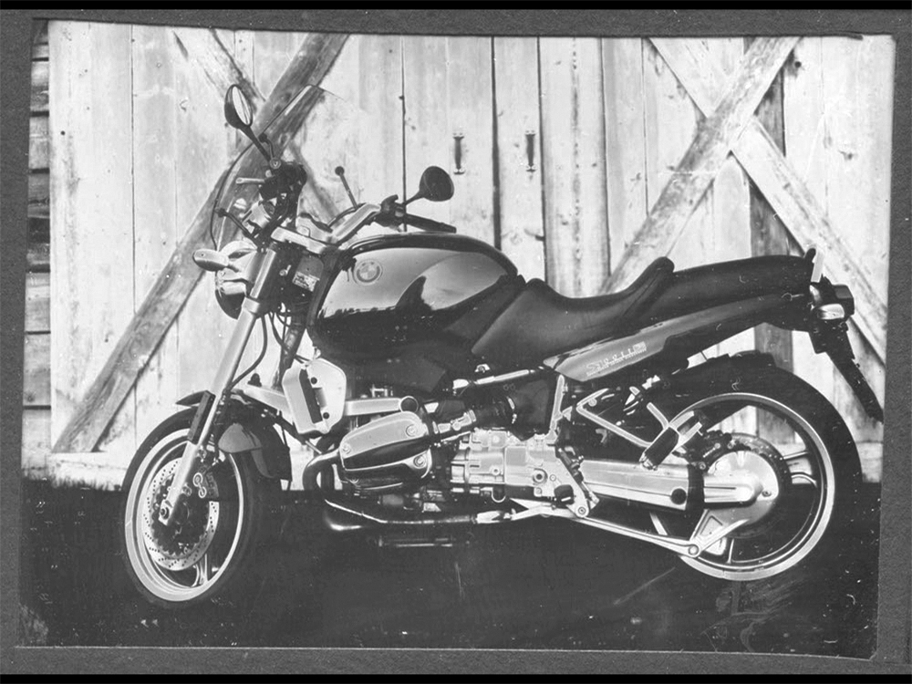

Here's another video using Becquerel development, maybe it will help fill in the gaps. I know it worked for me, as that is my motorcycle being used as a model! I convinced the powers that be in the Digital Photography Department of Harrington College of Design that it was worth bragging rights to have a photo history teacher that not only collected daguerreotypes but made them, especially if the subject were a 21st century machine, so he cut loose with the funds for me to drive it from Chicago to Montana.
Jerry Spagnoli Demonstrates Making a Daguerreotype
More images from that trip.
