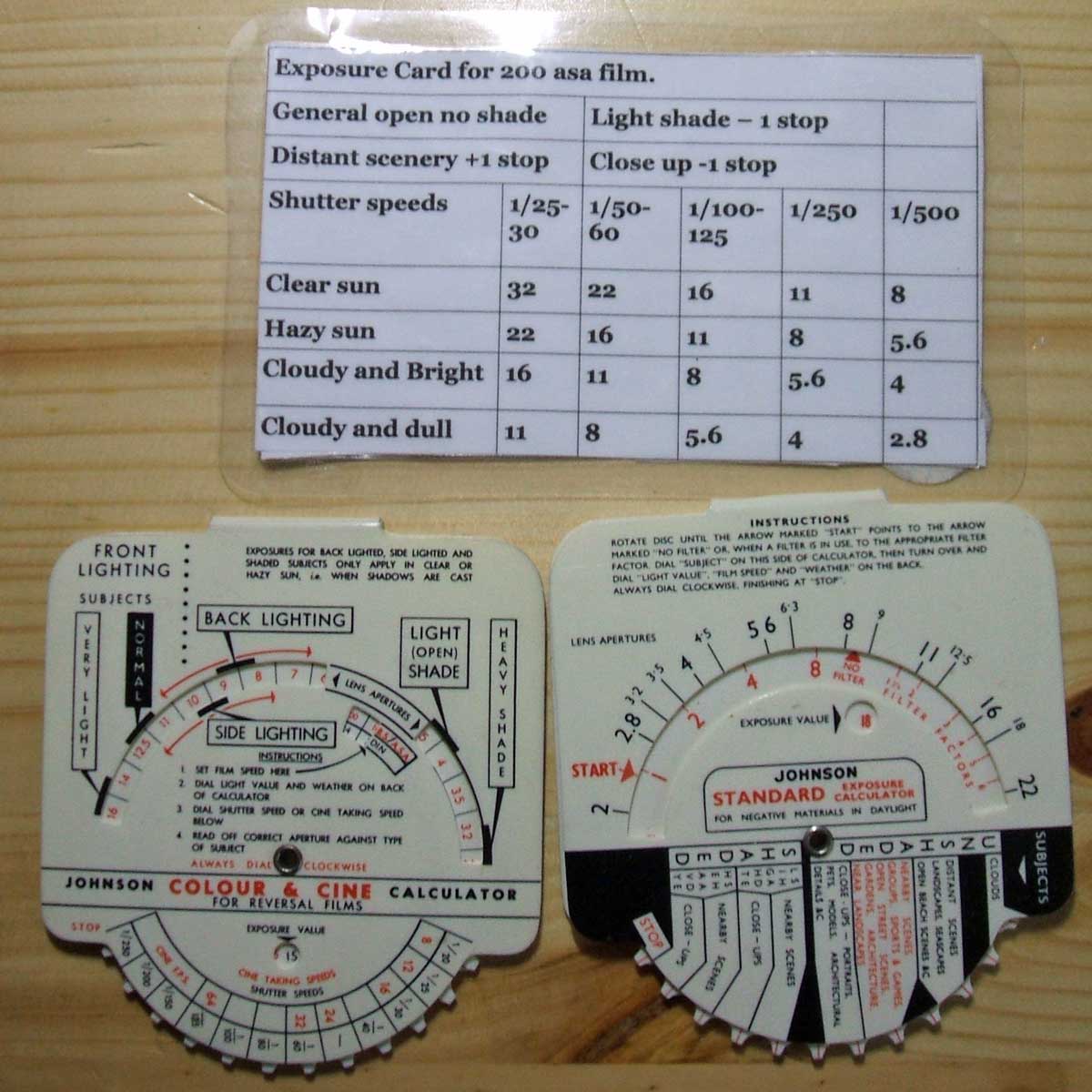

I have a couple of Johnson Calculators, one for negative film and one for positive film that I find work well out of doors. They are based on some British Standard tables that can be used for calculating exposure. A combination of weather, subject, time of year time of day and latitude.
There are similar devices for studio work but really interior lighting as not as standard as daylight. No doubt that once some experience had been established with a particular interior set up such a system might work.
Digital cameras have their uses and courtesy of an old Fuji A400 a snap of the calculators and a card I made myself. I have them for 100 and 400asa as well
