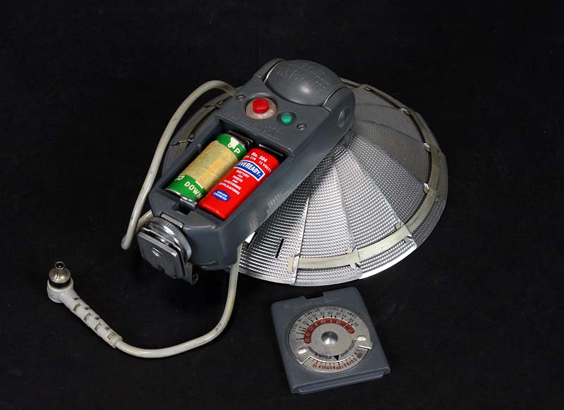

just received a flash unit that calls for A batteries. Honestly I have never heard of that size, but can't I just use AA cells ? Or are A cells readily available ? Thanks

The AA's fit fine. The only thing is, an A cell is 1.2v and the AA is 1.5v. 3 batteries needed. I guess I'll wait for the bulbs to arrive, and try one.

Thanks, I saw that. And another similar one. Like I said, a AA will fit, size wise. It's now a voltage question. There isn't much to a flash, electronically speaking. I'm not sure if there is a capacitor inside, and I'm not taking it apart to find out. There is no On/Off switch so I can't listen for that charging sound. I'm just going with the double A's and hoping for the best.
Unless I hear otherwise here.

Yep, it does use flash bulbs. And that is the answer I kind of was hoping for. I figured the over voltage would be fine, since it looks like the bulbs would fire right off the battery. I may end up getting more flashes with AAA than with A

This flash probably charges a capacitor which is then discharged into the bulb to fire it.
Batteries have a high internal resistance which could cause problems getting a repeatable fire time. The low internal resistance of a capacitor ensures a quicker, higher current pulse which will fire the bulb more reliably.

The capacitor is used as an energy storage device.
Flashes and similar applications require a high surge current (high amperage for a short time).
Small batteries are not good at supplying high surge currents. Capacitors are.
So the battery charges the capacitor, and the capacitor provides the energy to fire the flash.

The flash gun with my Argus C3 uses 2 'C' cells (3 volts) and I believe there were some husky looking units in the 1940s/early 1950s that used 3 'D' cells (4.5 volts) but C and D cells can supply several amperes of current. The 15 and 22.5 volt batteries like those seen above and used with a capacitor were probably gasping at a load of 50 mA.

Takes 3 cells. It's a flash for a Viewmaster Camera.
Wouldn't a flash with a capacitor have an on /off switch, and the ability to fire it on its own ?

No. The items are connected in series. Battery, bulb, capacitor, resistor then back to battery. With no bulb or a used bulb in the socket, no current flows. Plug in a bulb and current flows charging up the capacitor but limited by the resistor so there is not enough energy to fire the flash. The camera's flash contacts connect the other ends of the capacitor and bulb together so the bulb is connected directly to the capacitor when the shutter fires. This allows the capacitor to quickly discharge all of its stored energy into the bulb.

Frig it all, the bulbs fire with 3 AAs installed. Which is really all I care about. Thanks for all the help though.
