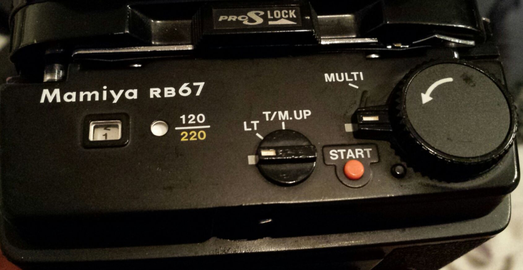

I have a battery powered RB67 back. I want to use it on a pinhole camera which means I need a way to "wind" it manually while off the camera. Is there a way to do this with the "time" setting?

I believe the only way to wind the back manually in that scenario is to use the knob to advance the film.

What power cable are you talking about? the motorized RB backs are self-contained. You should be able to manually trigger the motorized film advance after each exposure. I'd have to play around a little with my motorized RB back to confirm the process, but I know it can be done because there's something wonky about my back/body combo so it doesn't always trigger the advance when I trip the shutter, so I have to do it myself.

Mine has no power cord.
I want to trigger it electrically, because winding the knob or lever sometimes moves the camera.

When you cock the shutter on the RB a pin makes contact with the film back allowing film advance to take place. Since your pinhole camera can't do that, your options seem limited.

I don't care if it vibrates; i just want to take more than one exposure without shifting the camera. I rarely use a tripod with my pinhole camera and usually set it on a beanbag or on the ground. It's impossible to wind a regular back without having to recompose afterwards.

Well alright then...necessity is the mother of invention. You can go all steampunk and fab something to make it happen the way you would like it too.
Do you have a photo of your back mounted to the camera? Is it setup on the rotating back?

I do have a rotating back. I think I need a way to physically push the interlock on the front.
