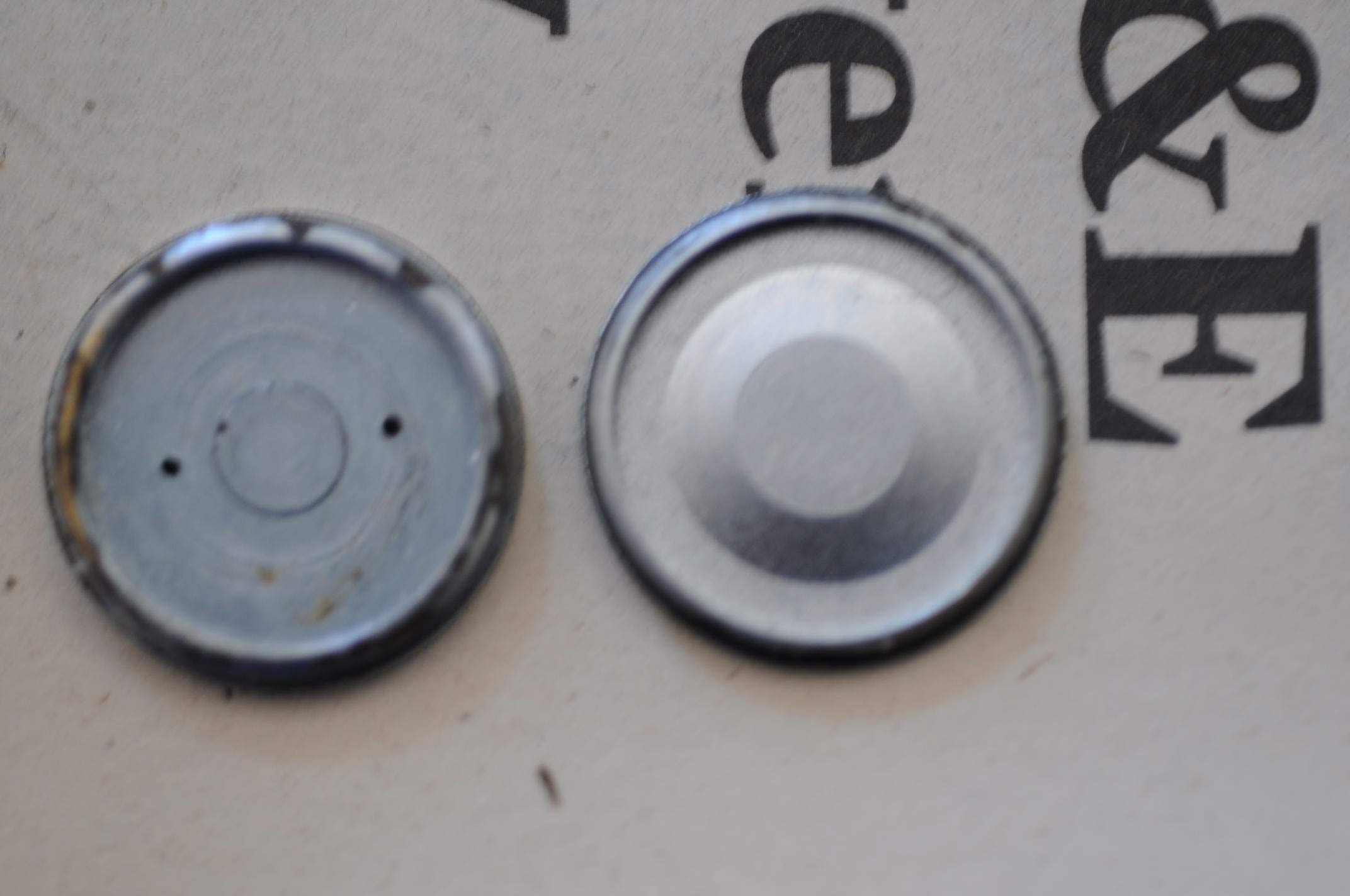

I have a Honeywell Pentax SP1000 and a Honeywell Pentax Spotmatic.
The SP1000 cap is on the left in both pictures, it will fit both bodies; the Spotmatic cap will only fit the Spotmatic.
The SP cap diameter is 14.66mm at the outside edge, thread 13.5mm and 2.35mm thick; The Spotmatic cap diameter is 14.78 at the outer edge, 13.84 thread and 1.9mm thick.
Both take Energizer 394 battery with a plastic reduction ring.
