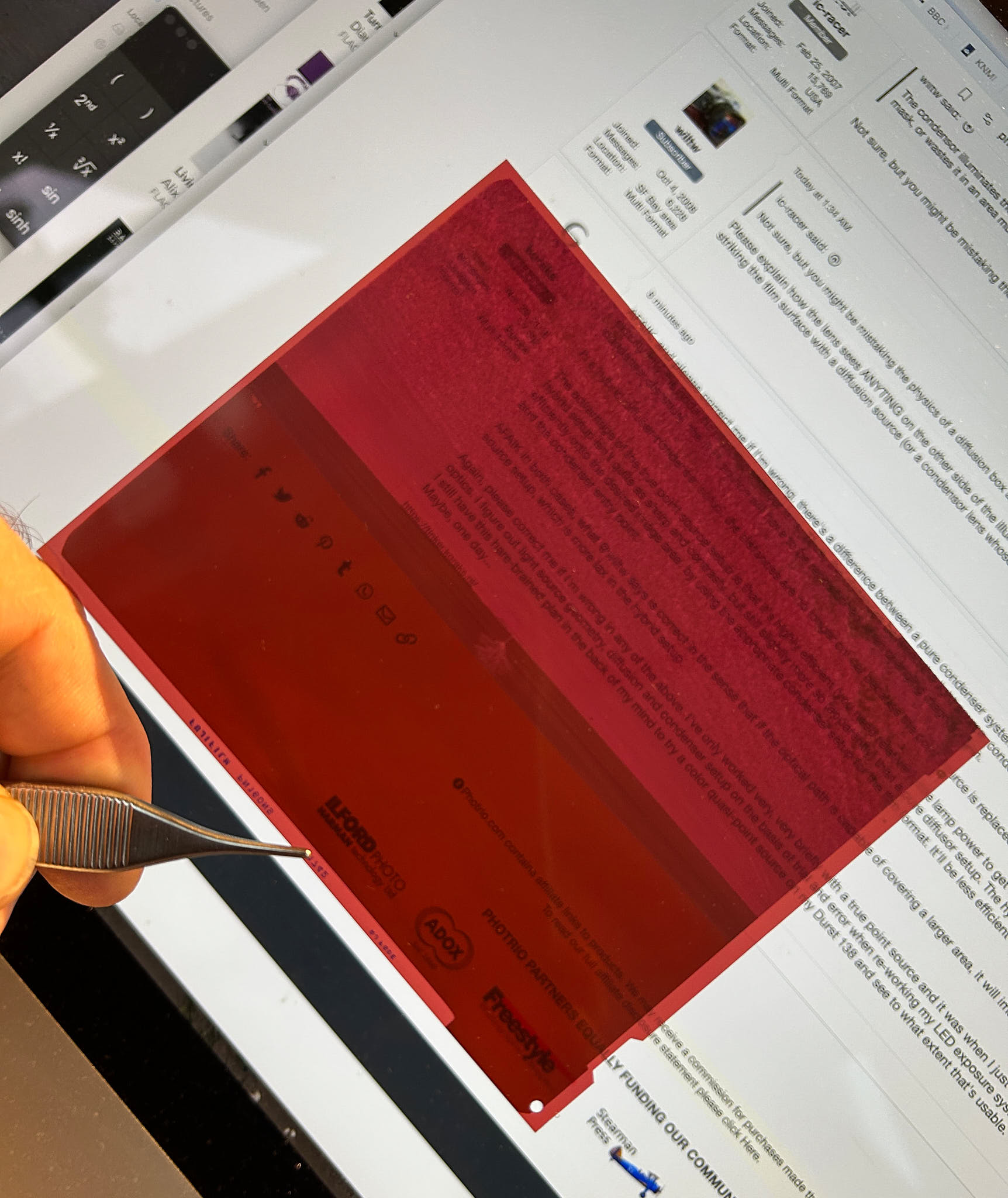

Please explain how the lens sees ANYTING on the other side of the illuminated frame of the film in the holder. The light striking the other side of the frame might be more collimated by a proper size condensor system vs. more multidirectionally striking the film surface with a diffusion source (or a condensor lens whose area of illumination is larger than the cutout.

A negative is more or less transparent. A lens can see through it. Most of the light wil travel through it without changing direction.
