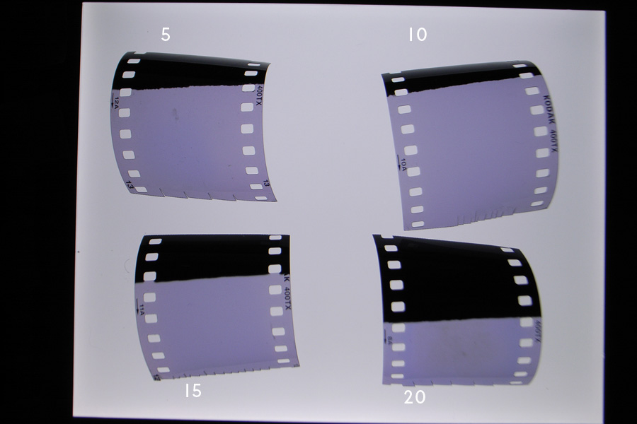

[20m, 10m]
[15m, 5m]
5m looks a little yellow in the middle. I didn't fix it long enough, I think and rectified in the others.
