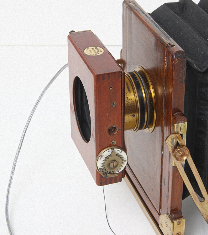

I use a Graflex SLR with a focal plane shutter for small fast lenses (mainly a 7 inch Cooke series II aviar lens) for larger lenses (my Dallmeyer 3a portrait lens) I have built a drop shutter using a combination of elastic bands and gravity. it is a very simple construction and I can post pictures if you want though I don have only currently on the computer.

I have quite a few barrel lenses, Rapid Rectilineras, Petzvals, EWA etc, all can be used with a shutter. I have varoius options front mounting leaf shutters Luc, AGI, Gitzo, focal pane shutters separate (fit the rear of field cameras, Packard shutters, and many Thornton Pickard roller blind shutters my preferred choice. Also I have SLRs and Speed Graphics. I've missed a few other types :D
