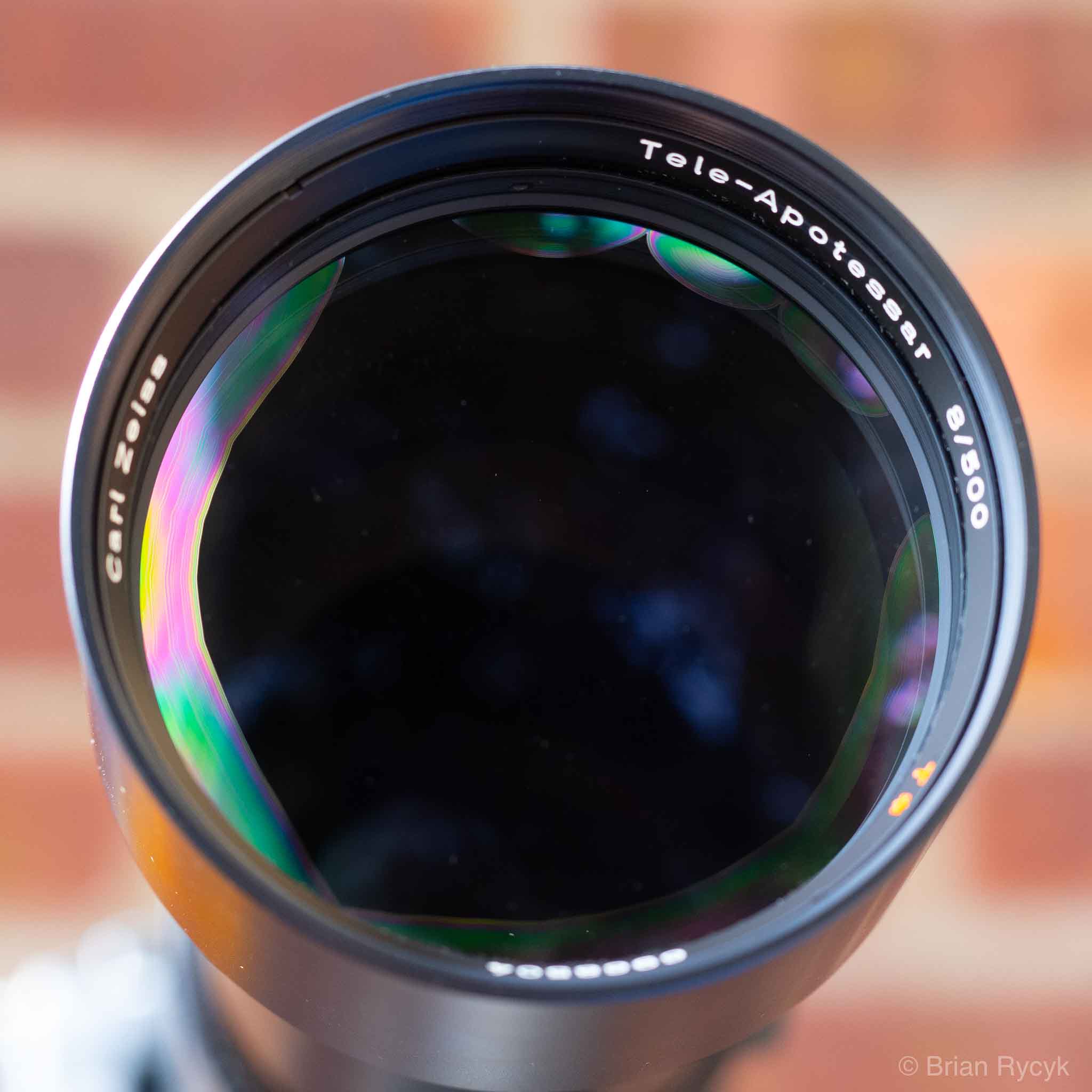

Can anyone help me find someone who can repair a Hasselblad Tele-Apotessar
T* 8/500 CF lens. The front elements have Balsam Separation.

Well, does it need repair, or do you want it repaired?

I would like the front lens group re-cemented, yes repaired....

Well there is a high chance something may go wrong. If you are repairing for the lens value, there is a high right of losing the lens. I got plenty of lens with separation (large format lens) that I got for cheap and they are totally usable.

I'm assuming there are 3 paths to repair - there happens to be a replacement cemented group still manufactured or in someone's new-old-stock parts; there's a group from a donor camera available; or the elements get "baked", cleaned and re-cemented, which seems to be a real specialist repair, and if they're encased in metal, it gets super-extra-hardcore. (Since nobody's pitched in with repair experience on this lens, just throwing my guess in).
If it were me, I'd do some critical testing and see if it's even is visible, or if there are apertures that negate it - at least while you sort out a repair you'll know if the thing's usable or not.
Bill Rodgers at MamiyaRepair.com is a real knowledgeable tech, not just for Mamiya gear - he may have some info for you.

I think I read on this forum the safest part would be to disolve the cement, not baking it, since the different density of the element will lead to glass cracking, which seems sensible enough.

Somehow I think the need to repair is more related to value that to actual use.
This was my idea too, or an erroneous assumption on the effcet of this seperation, thus my question above.
If someone can show a case of image being affected by such delamination I would be grateful. I mean, already a finely cemented group has reflections from the laminated surfaces.
