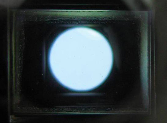

IloveTLRs
May 22, 2007
1,132
Boston
Sub 35mm
My M3 finder looks like this (when viewed from the front.)

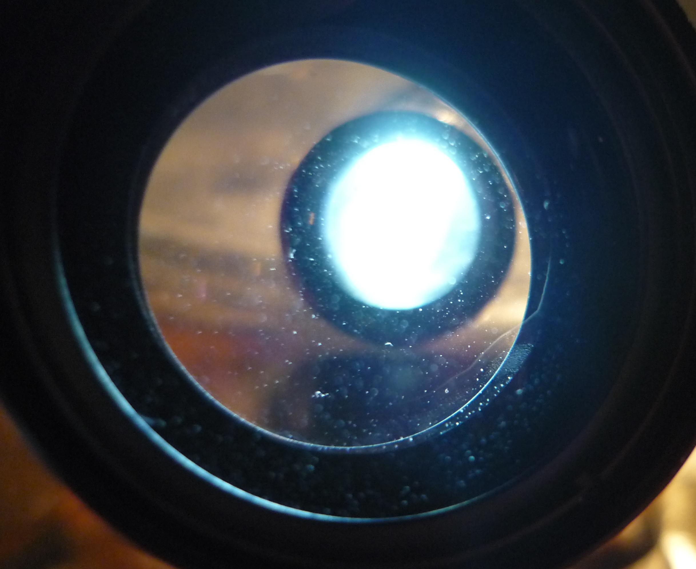

Aron
Aug 27, 2009
256
Hungary
I just took a photo of my Symmar-S's separation in the rear cell. It's not always easy to find, but basically what you see is an extra surface appearing between the partly decemented elements. Since my lens is multicoated from 1978-1979, I wonder how resistant synthetic cement to drying out is.
