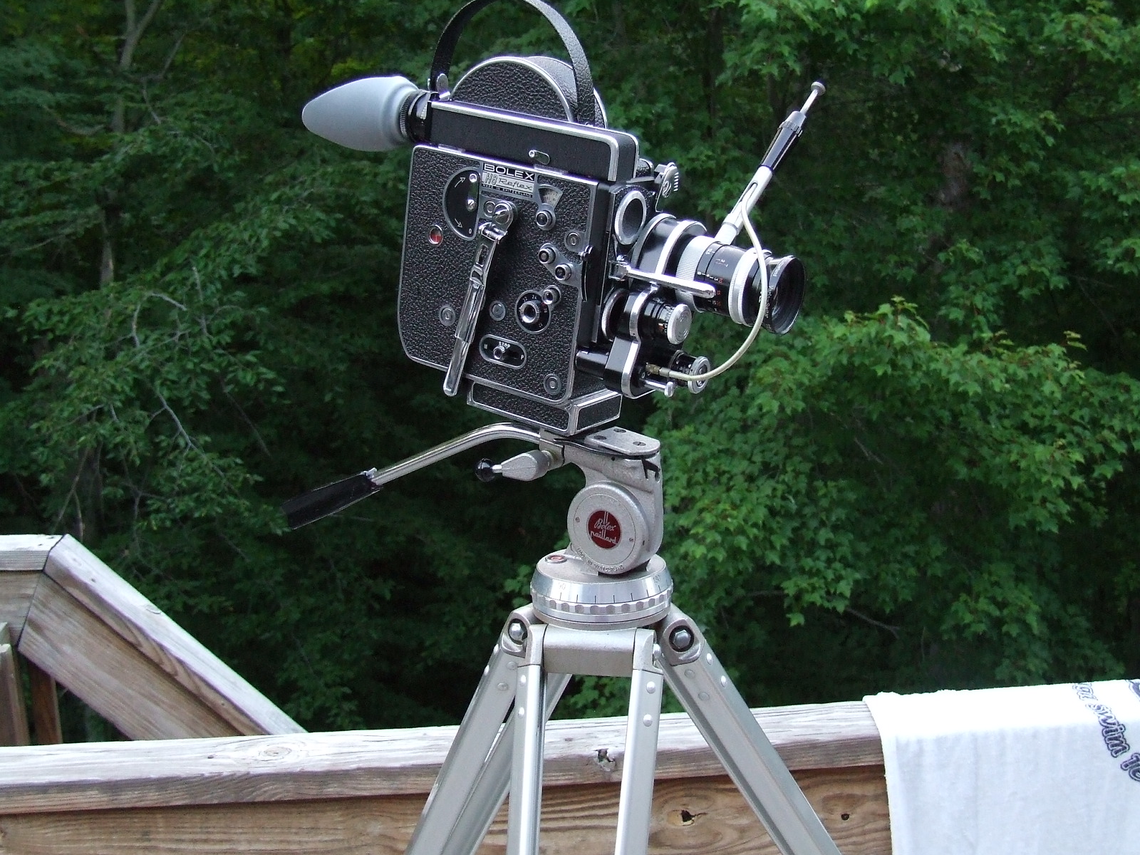

For shooting 16mm movies I use a friction headed tripod. Very stable tripod and head. Also very heavy. Given to me by the late Ken Hansen because cosmetically did not meet his standards. For Super 8 and video I find my Gitzo pan tilt head adequat. Of course, everybody has a different way of working. I have no experience with fluid heads.
